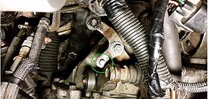

So after putting everything back together from an ACT prolite/HD street install, fired her up and i only have what i think is only 2 foward gears, cause reverse wasn't happening. No crazy out of the ordinary sounds/grinds/etc. Immedidetly removed the battery and tray to look at the shifter linkage. After some looking it appears that one the c-shape shifter linkage arm was missing something. Seems like this missing piece allows us to shift/transition from the top . 1-3-5 gears to the bottom transition 2-4-R.
I attached a pic of it and circled it in green. Is there a part name/number I can get. Other temp solutions are welcomed.

found it its a white/cube holder that 8$ from mitsu.
Manual Transmission Shift Linkage Shoe P/N MD771824.
