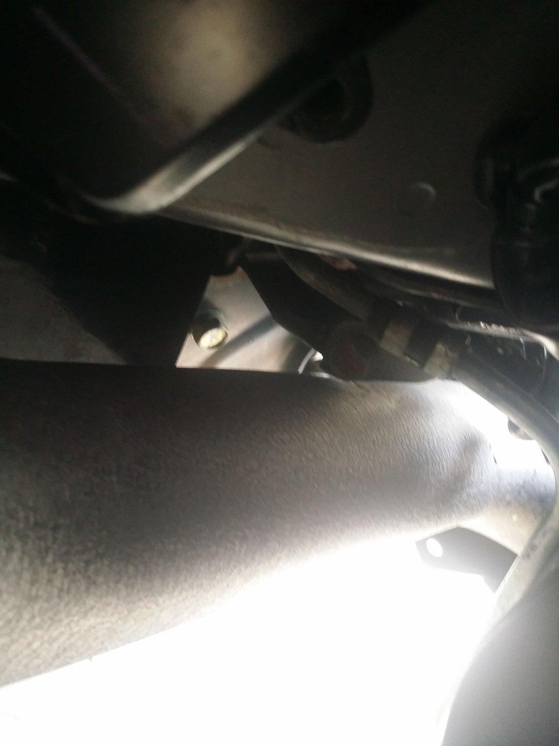

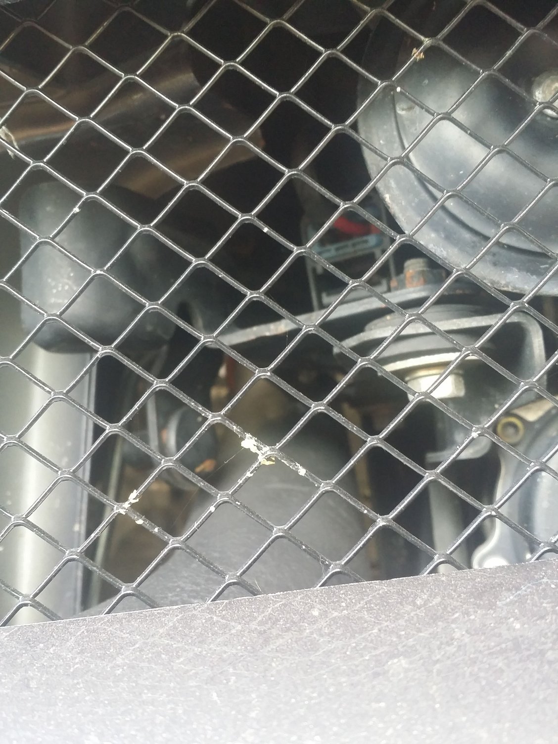

My uicp is hitting the bracket that holds the acd pump. I had my jm drag manifold installed couple years ago and I just can't get the pipe from rubbing. Anyone with advice please chime in. I was well aware that the uicp may need modified to use this manifold. The shop that installed this was well aware of this to. If it makes a difference it's with the Buschur race core.

pic?

Not the best. I took this from my phone last night. Ill take the bumper off and get a better one<br/>
Again bad ill get better ones tonight. <br/>

When installed my ETS UICP and intercooler, I had to clearance the bracket and bend it out of the way some..

could you slip a hard plastic shim/bushing in there until you get the pipe reformed?
