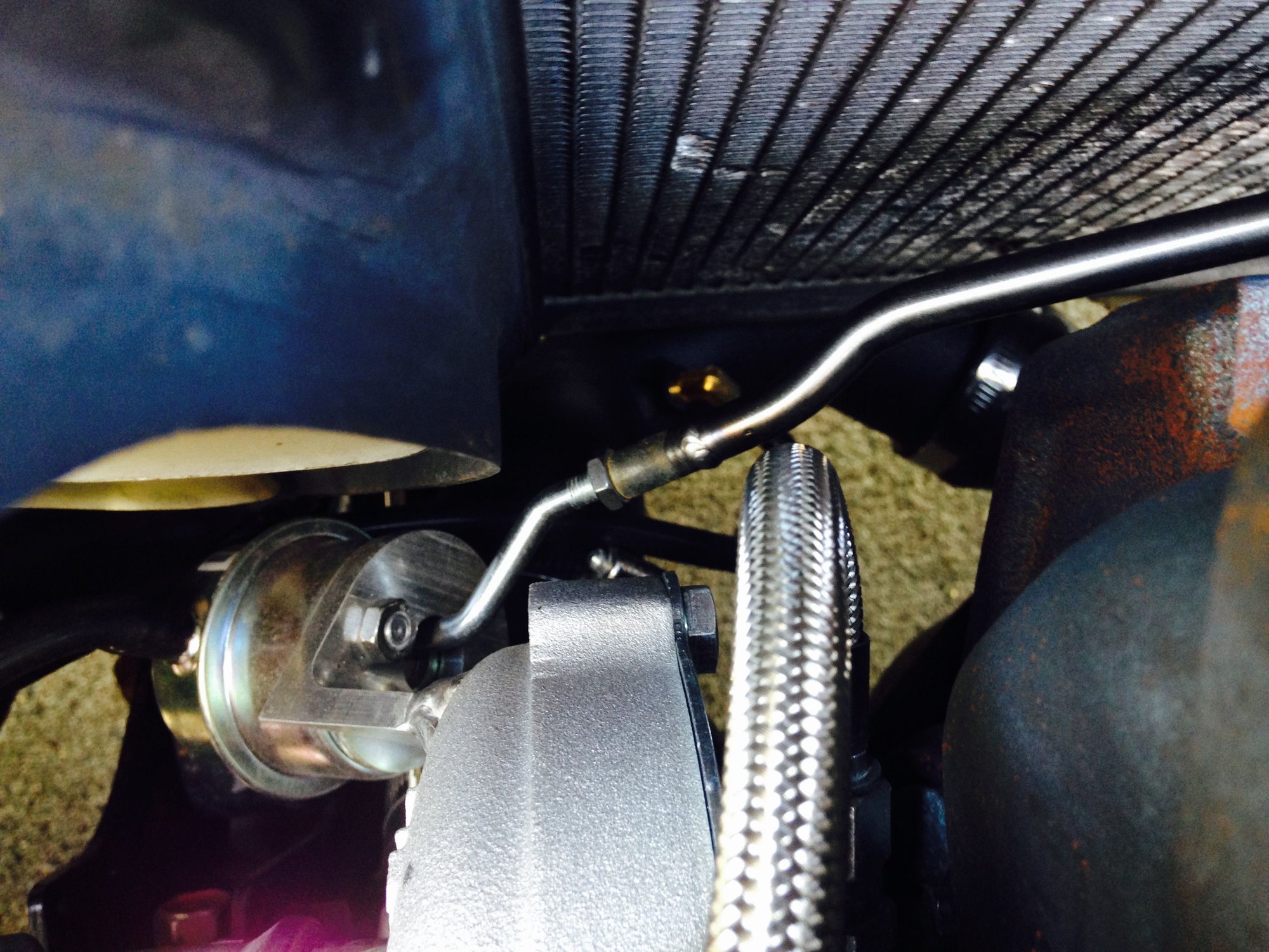

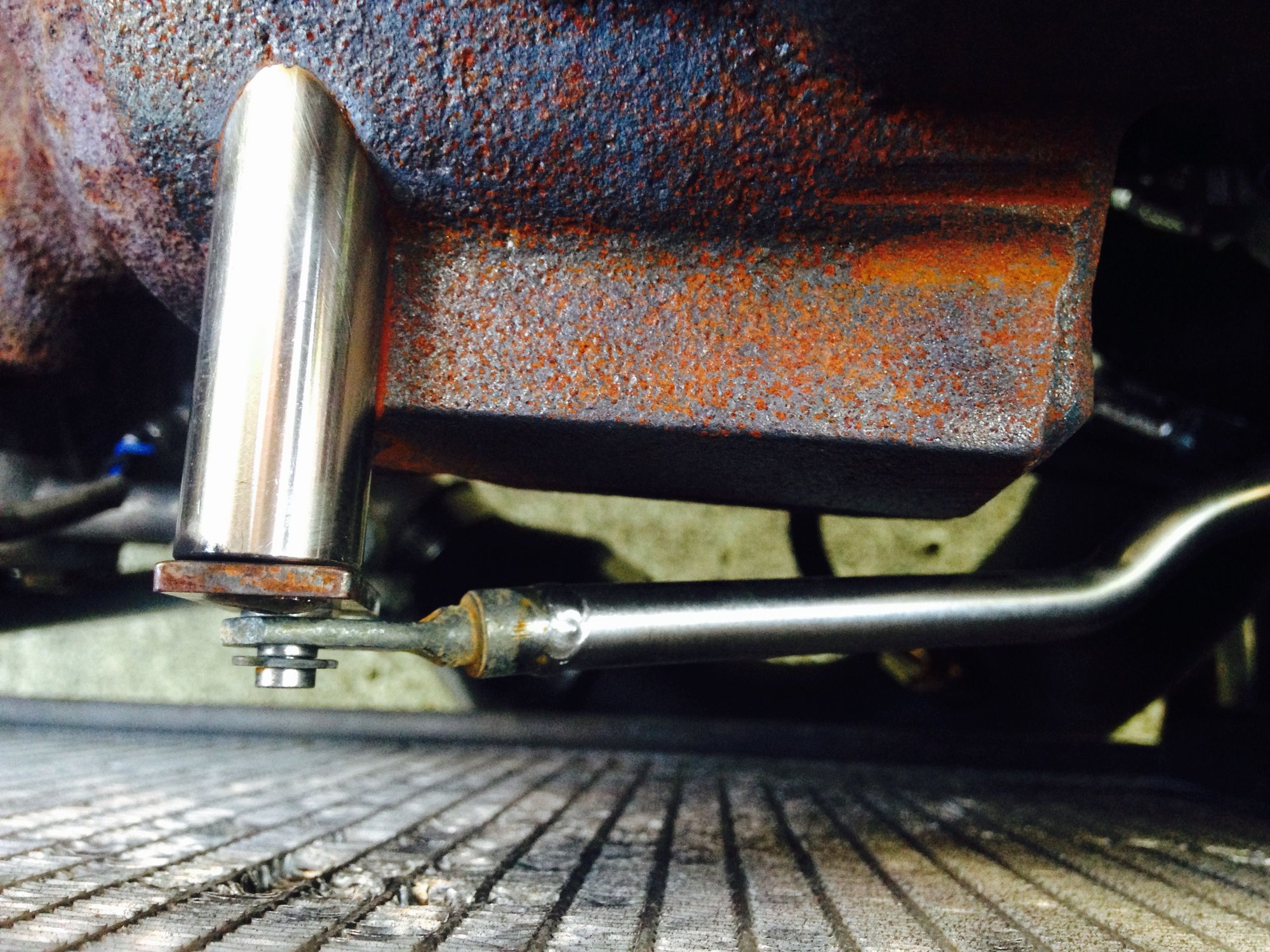

How much adjustability(how many exposed threads) are visible behind the turnbuckle and backup nut on the end of the actuator rod?
I am googling for an image of the wastegate setup on your ATP turbo so as I can visualize what we are working with since it is different from the stock frame actuator setup on MHI turbos.
Got a pic by any chance?: Does the actuator rod have an almost severe right angle bend to skirt around the turbine housing? By contrast, the Evo X ATP 3076 actuator rod setup is almost a straight shot affair axially.

there is only adjustment on the actuator side of the rod and there is probably 7-8 threads showing. the way the rod has a bend in it I will only be able to turn it full 360
