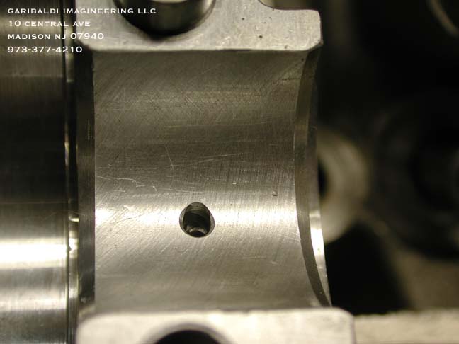

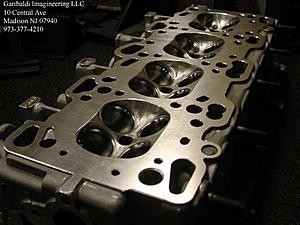

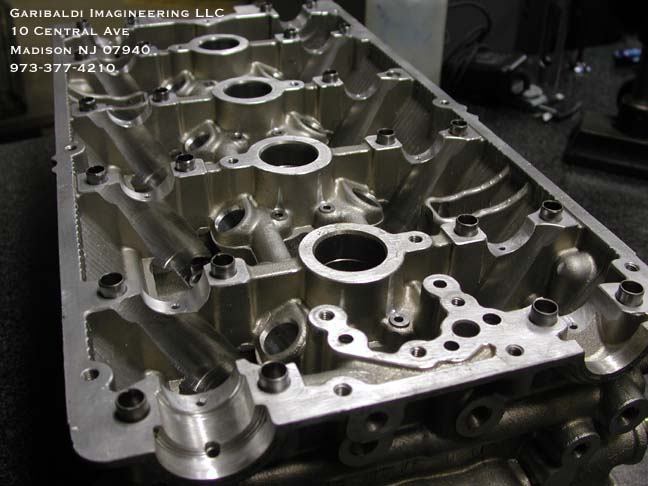

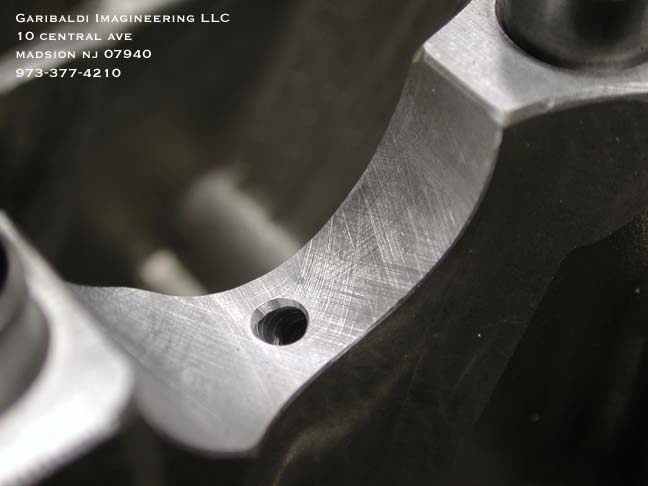

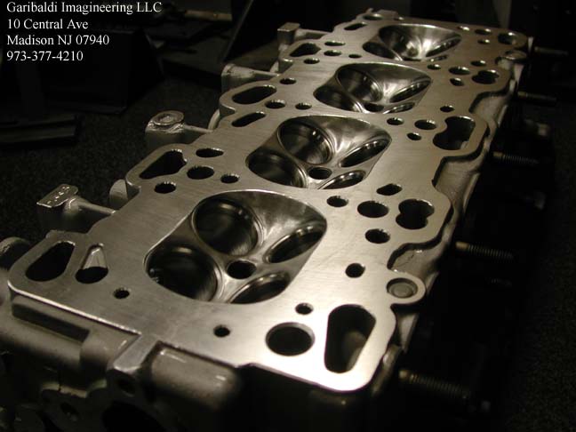

Just to add fuel to the fire..... The stock bolts are fine, and have been used for the production engines without problem. What Ferrarokid and Eric stated in the beginning is true, a stud would be a better solution, and to incorporate a locating shoulder on it so the you can get rid of those toilet paper locating holow dowels would be even tricker. It can be argued that its splitting hairs, but to use a nice and proper designed stud in that area would just make things a little more secure. If the cam caps are installed properly, the OEM stuff is fine. We just did a head that had cams installed and the caps were distorted due to improper torqueing. I had to clip all of the caps flat and square to be able to line hone the cam carriers again to proper size . In doing the job, I went to pull the hollow dowels out with a dowel puller and they are so flimsy that they collapsed during that operation. No big deal, you can buy new ones for about $1.00 each from Mitsubishi. The thing is is that if you had a nice strong stud, that had a locating shoulder on it, it would be better. The OEM bolt and hollow locating dowel is just cheap, and keeps costs down, but it works- unless you try and remove them. The other thing I had to do on the same head was helicoild a few of the cam cap bolt hole since when I installed a few of them and tightened them up, the threads pulled from the aluminum head. SO again, a stud would be better off there.
If the caps happen to get distorted, its possible to have drastic oil clearance between the cam journal and cap housing- this last head had some of them that were not only out of round and binding up on the cam when installed before the honing, but had cam to housing clearances of over .004. You dont even run half of that clearance on the main bearing to crank clearance. So yes, what ferrarokid says is true, in this instance the oil clearanc ewas so great that a large enough volume of the oil being fed to the head was dumping out around the cam bearings to starve the last lifters in the oil manifold and have it begine making noise when the temp came up and the oil thinned out. And also to verify what he said, after I rebuilt the caps and honed it, the cam not only spun so freely when installed, the engine was quiet as a mouse up top, and the oil pressure was not only increased, but steady as a rock.
The problem isnt necessarily the bolts that hold the cam caps, it was the install, but in rebuilding the head and having it apart, we looked at it and agreed that if we had studs there with the locator built into it, it would be a nice touch. Here are some pics.
