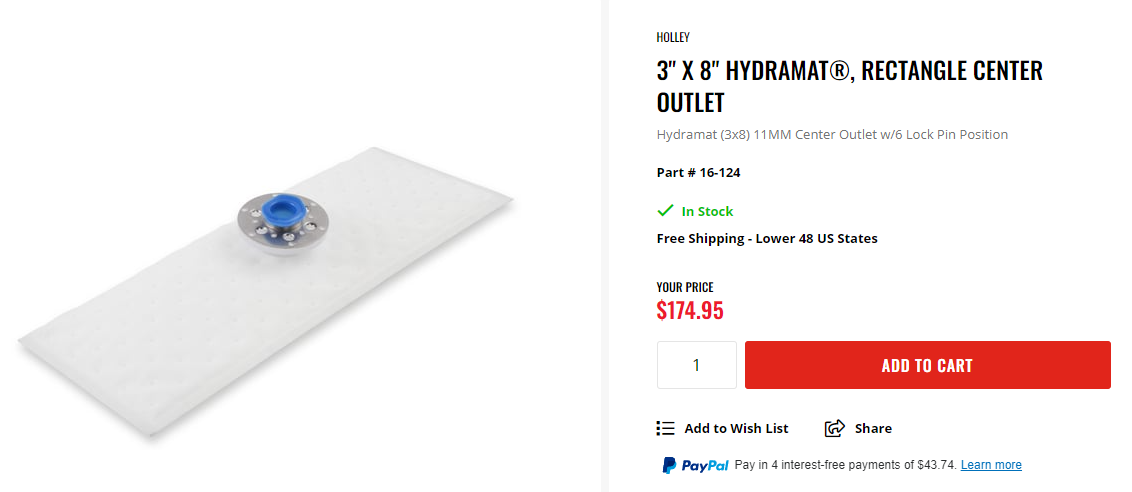

Holley Hydramat now has options for direct fitment to Walbro pumps with 11mm inlets.
I'll be trying this on my Evo 6, i'm getting fuel surge with only 15 litres used.
https://www.holley.com/products/fuel...s/parts/16-124

Curious to hear your results. One of my business partners has a Focus ST track car and those commonly fuel starve on track, the stock tank has almost nothing for baffling. He is trying a Hydramat before doing a surge tank. From what I've seen they work very well and are used in a lot of professional racecars so they're definitely an improvement in some capacity.
