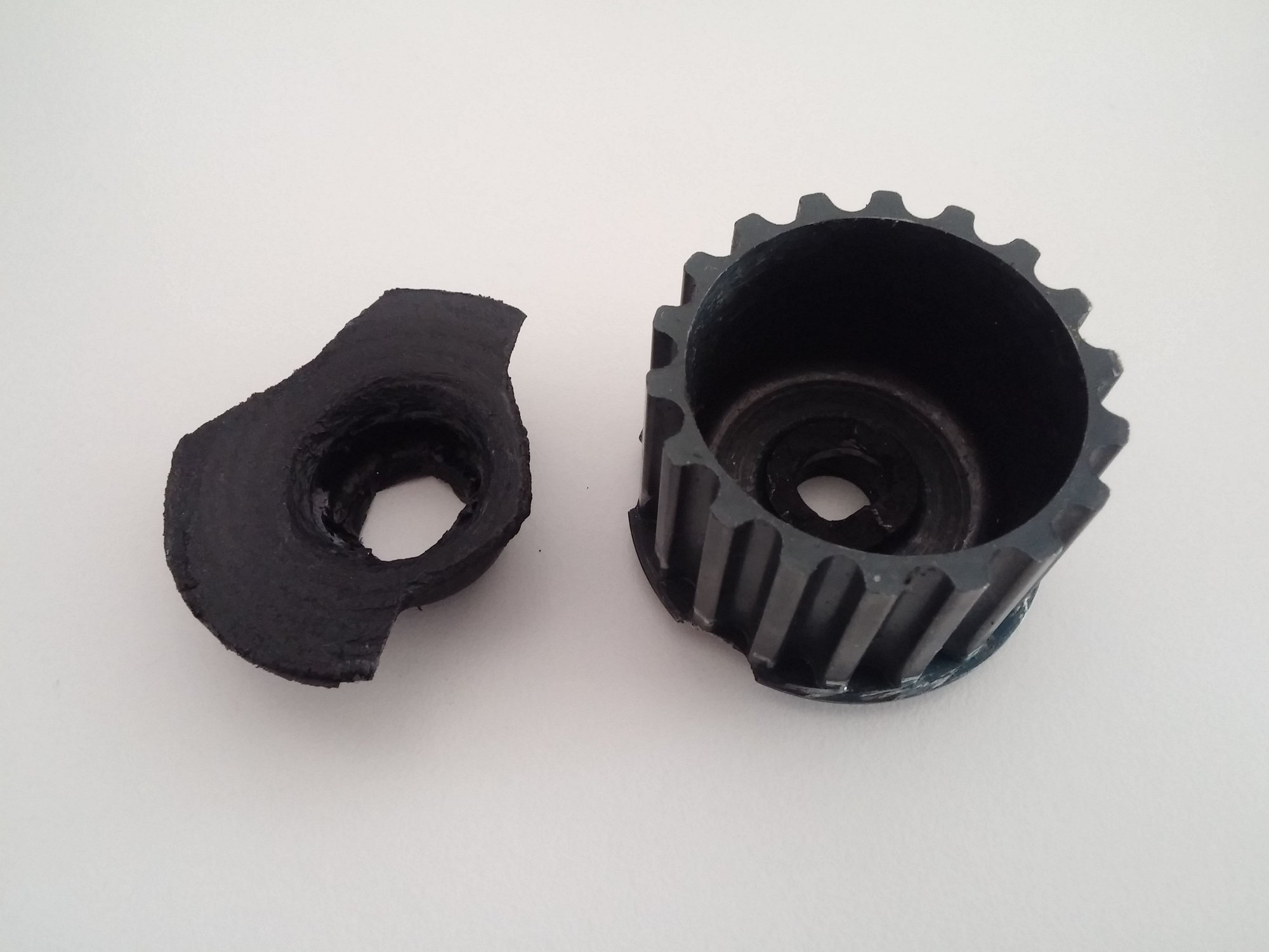

good day all,
also posted a few weeks ago about my oil filter became loose and i manage to save it on time until yesterday....
while was returning home with my wife/kids, stopped at a spotlight i noticed
a scratching sound , first i though it came from a car next to me but i was wrong....
after 30sec and while i started moving i noticed the red oil lamp was on
unfortunately i only thought to move right and stopped not turn off car at once,
after 10 sec engine simply blocked.....
aftermath:
the oil pump is connected with the cam timing belt via a gear which is simply attached
to the pump via a screw.....
the screw somehow manages to unbold itself causing the gear to hit the plastic
cover (thats why i heard a noise) after it broke it and fell of the belt was loose
causing my engine sto stall rendering the valves !@#!@!@!@
i dont know until now what the extend of the damage is (i will find in during the week)
maybe i am the luckiest evo owners on the planet earth...
has anyone else heard about a similar case before or i am the number 1 case?
A very sad evo owner,
Michael.

my mechanic replaced both belts & crank pulley but this happened in 4/2012....
the last upgrade work was a bolt on turbo swap 1 year ago.
when changing belts is also oil pump pulley affected?
thank you for your interest.
Michael.
Michael.
Yes. It's all connected the the main crank pulley. But it has been a long time ago I can't blame the last installer. What I think you called oil-pump pulley is actually the balance shaft. I have seen so many failed 4G63 due to this balance shaft belt failing and taking out/damage the main timing belt in the process.
