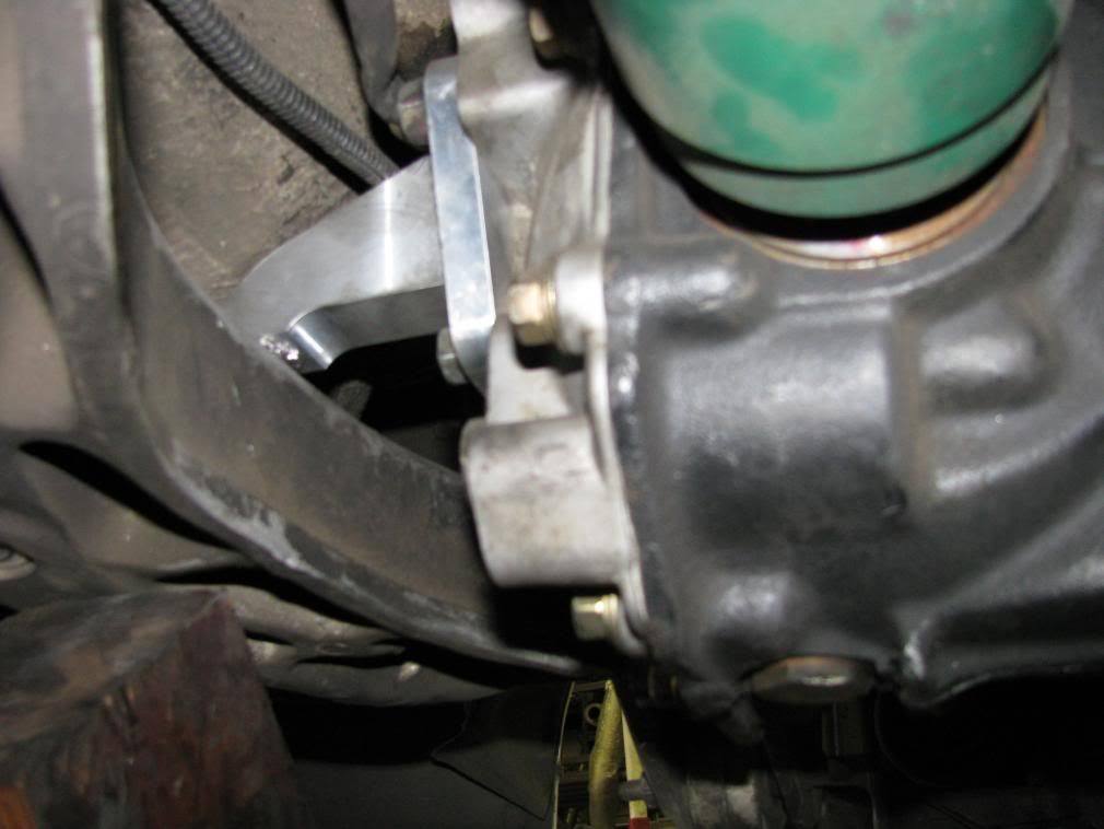

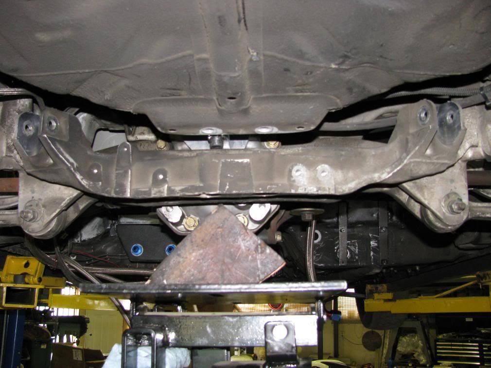

I'm confused. Ams sells mustache bar eliminator kit which includes diff supports.so it's ok to drive without that bar?
It's ok to drive without the full bar under one condition. AMS sells a small piece that replaces the bar so that you still have something there to keep the rear diff from rocking forwards and backwards on and off throttle. The side supports just help resist diff rotation.
So your options are:
1. Keep the stock bar and replace bushings when they go bad
2. Replace the mustache bar completely, which I'm pretty sure Buschur racing is the only company that makes a full mustache bar replacement.
3. Get a mustache bar delete kit that eliminates the bar, but gives you something smaller that successfully does the same thing with more added noise. Most people also report added vibration.
In this thread you can see exactly what the AMS kit does differently:
https://www.evolutionm.net/forums/ve...irst-time.html
Here are two pictures for a sneak peak.
Even though options two and three both offer significant weight savings, I choose option two because I don't like the idea of not having a bar that Mitsubishi designed to be there go missing when I'm doing more than just drag racing.
-pal215
