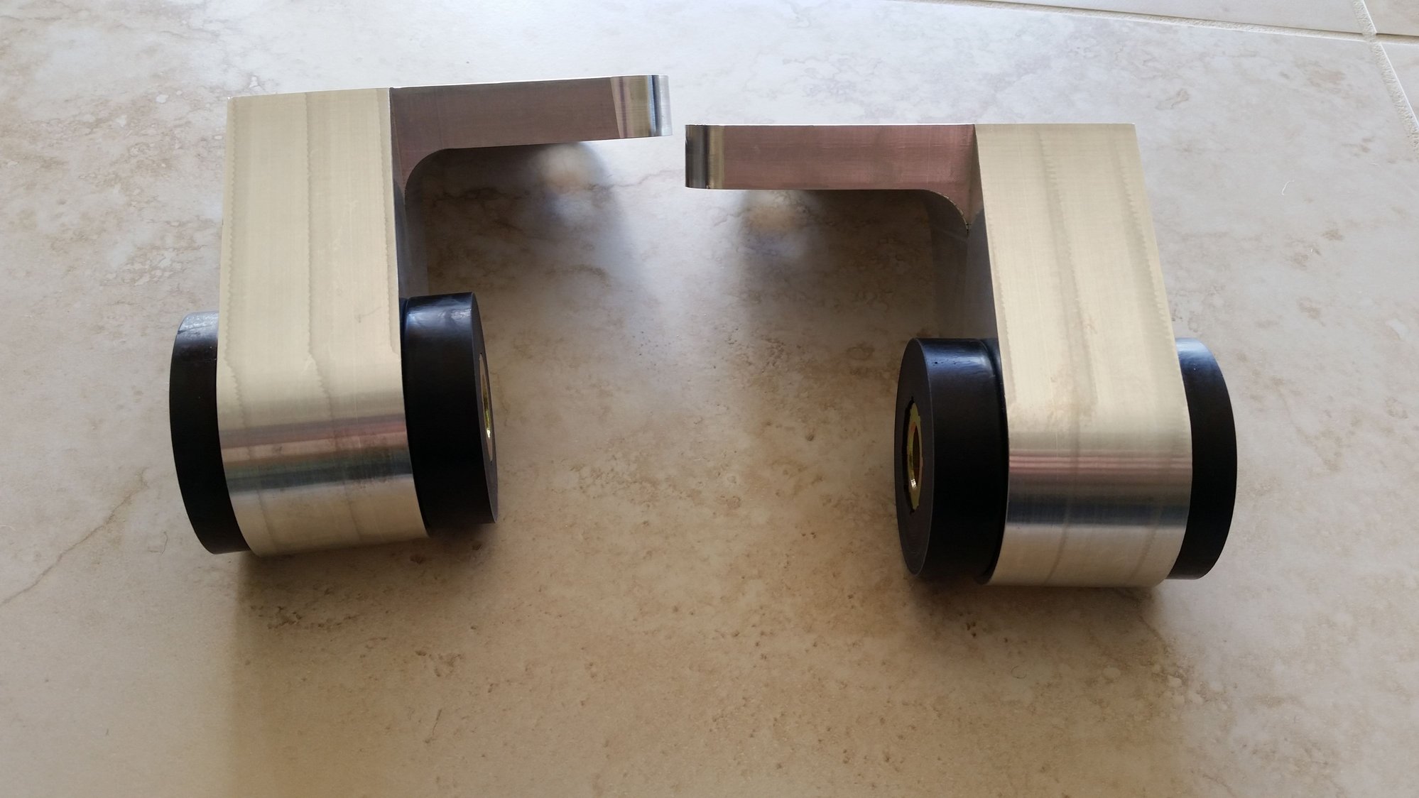

From a Billet block to Aluminum Perfection
Sunshine shots
The thickness of these bushings is confidence inspiring. This is why the noise level from these mounts is so little. Very daily driver friendly.
Here you can see the Grade 8 sleeve inside the <br/>urethane bushing.
Seems to be very well manufactured!
Mirror like finish, you can actually see my hands in the right mount.
Again, another detail shot. Trying to get up close and personal with these.
Here you can really see the detail that goes into the CNC work. No cracks, inclusions, or runs.

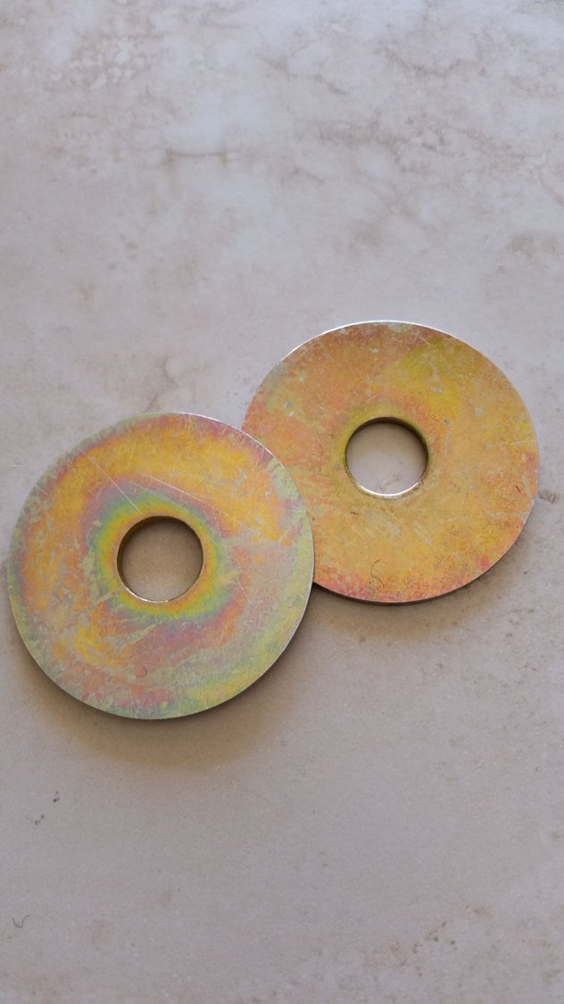

Grade 8 washers to place on your rear diff bolts before you slide them through the bushing sleeves.

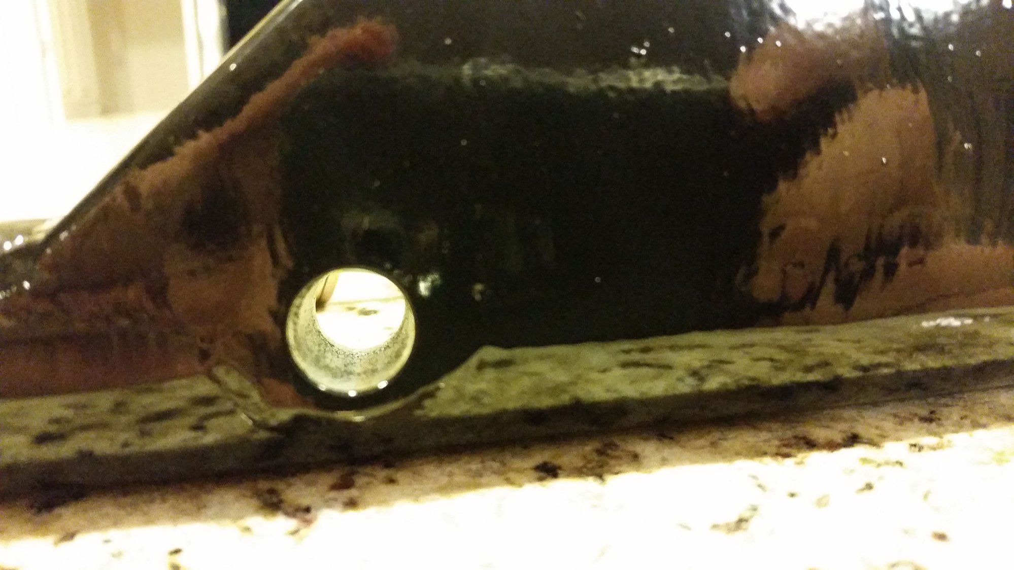

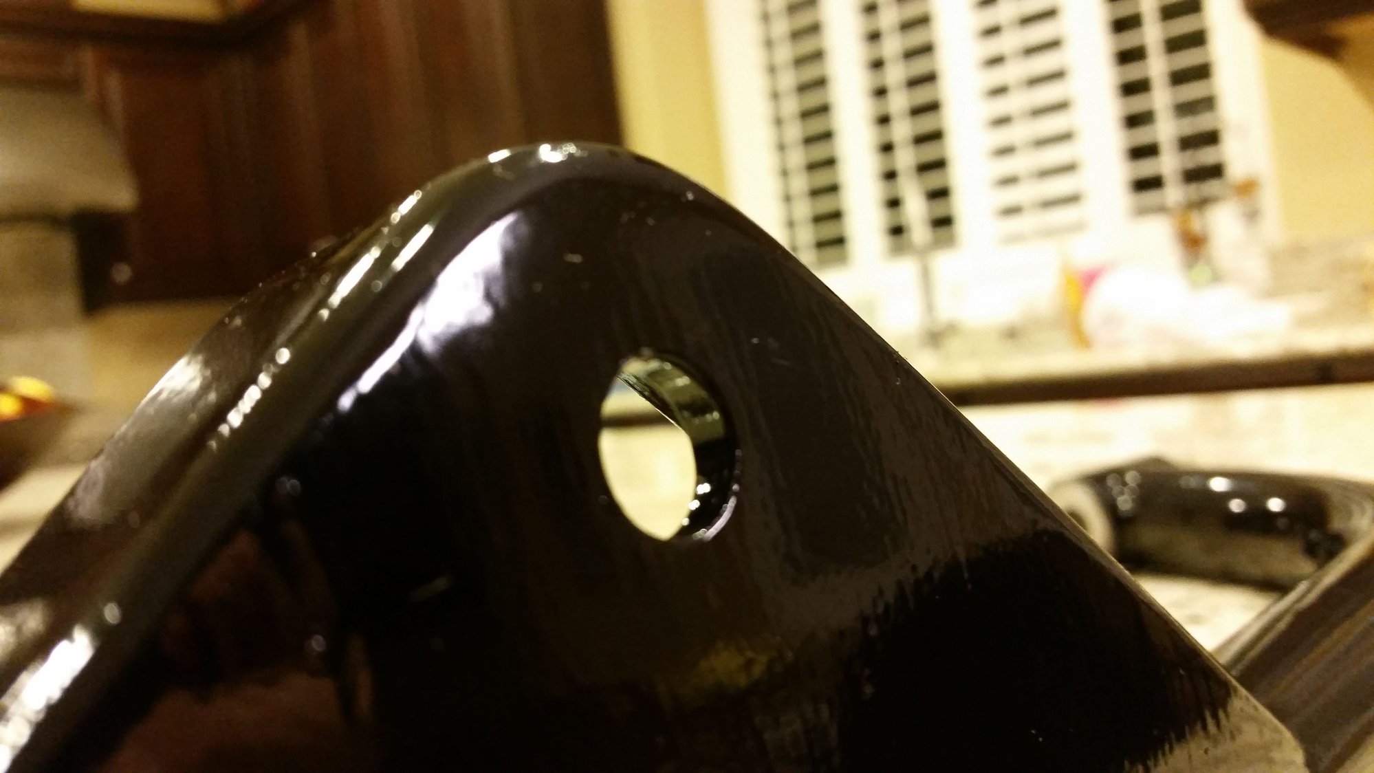

From this angle you can see the thickness of the steel being used from the hole.
Steel follows through the entire length of the hole, not just at the flat face.
The powder coating is really thick on this bar!
