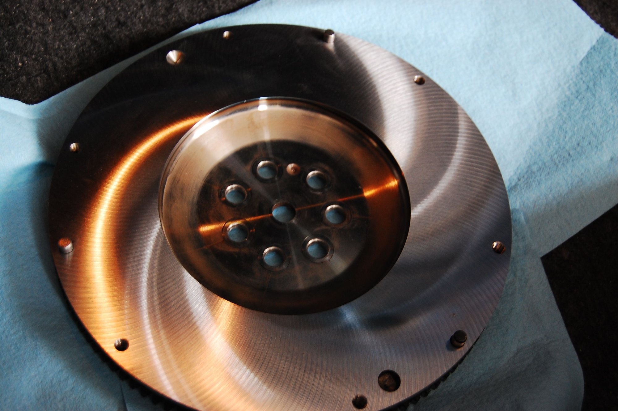

stay with the stock fly wheel, lighter ones will make the clutch more grabby and less subtle to drive daily
Old Apr 24, 2016 | 11:38 AM
barneyb's Avatar
Posts: 6,902
Likes: 151
From: Grand Island, NE
Agree but have it resurfaced.

Right now I am leaning towards the ACT HDSS + Streetlite flywheel.
I also like the price tag of the Comp Stage 2 and WORKS Stage 2.
How many miles does a resurfaced flywheel typically last?
Old Apr 24, 2016 | 06:03 PM
whtrice's Avatar
Veteran: Air Force
Posts: 1,352
Likes: 58
From: Sacramento
Normally as long as the car does. Resurfacing just allows the new clutch surface to break in. ACT HDSS is a good choice. Shouldn't need to replace your flywheel unless there is a problem with it.

Resurfaced flywheel or my definition of pretty. It provides a flat surface with no heat hardened patches so a new clutch can serve up a smooth engagement. The only downside is a little less metal to absorb heat but people who go with light weight flywheels are getting the same thing.
