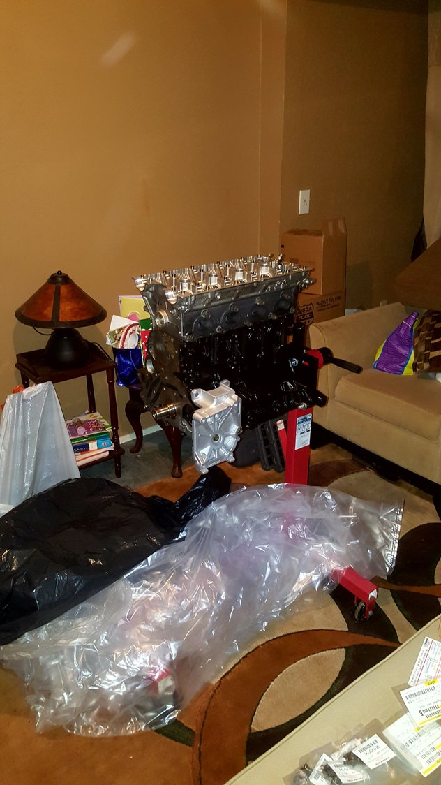

We make our own pans and I'm happy with my results, so far. The system has nearly 7qts, which I feel is necessary for a turbo car. My oil pressure has been excellent during testing so far. I highly recommend a better pan, if you get serious about track days.
Mine, before paint:

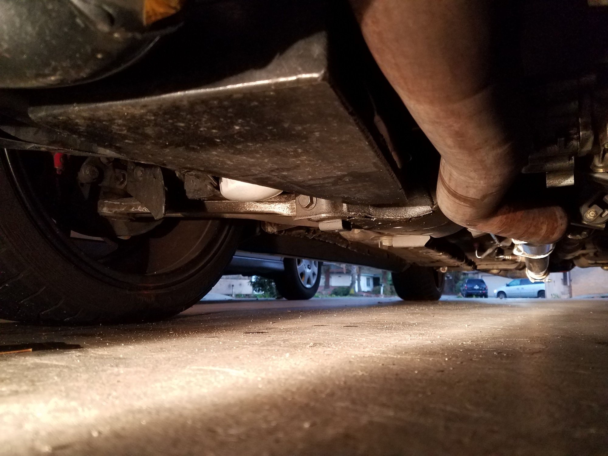

Kaj, That pan looks nice . That angle makes it look pretty tall.
Can you grab a picture of it on the car from below at ground level? I'd like to get an idea on ground clearance. Thanks

It's hard to get under there, but even the down pipe is lower.
