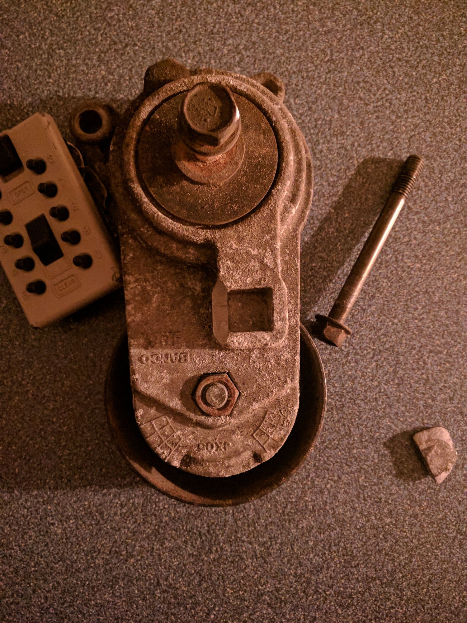

So I was replacing the crankshaft pulley and I wanted to see if the tensioner was seized (it wasn't) I come on the forums today to see if I can work my way around this any other way to get the belt back on! Let me know thanks in advance

No fix, replace. I got mine from Advance Auto. It was OEM with the part number ground off.

Same thing happened to me. I was able to still loosen it with one side broken off, then another side broke. Got one at napa. Seems sturdier than oem's and works fine.

This happens a lot. I think the problem is people not realizing it will break if the 1/2 inch drive isn't bottomed out in the square hole. It is a cast hole and tapered. I've wrenched on mine a number of times and never broke it. I replaced my tensioner when the tensioner bearing was noisy.

Hey guess thanks for the help turned out it was seized I was able to fix it with a pipe wrench and a **** load of wd40 now works great!
