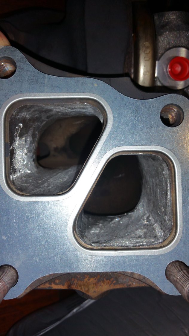

I don't see the problem. I shaved it slightly on mine to help flows away from wastegate side but nothing more. Exhaust manifold side is smaller than the turbo entrance, so I dont see a problem. Please tell me what I'm not seeing.
Turbo Inlet
On the turbo inlet, I will open up the lower right corner of the left hole to match gasket.

Inlet to the turbo should be gasket matched. Exhaust manifold exit can also be opened to match the turbo gasket.
I'm sure porting results can be skewed, but there are some quality porters out there...or you can do it yourself if you have the tools.
You can do A LOT more porting on that turbo hotside than you've done. Since you're in Cali, you could check out SoCal Porting.

Okay, I'll open up the turbo side, but I will adjust the gasket to be conservative on each side (probably stop at 1-2 mm smaller than gasket). There will always be a little play/movement when I bolt it back together and I don't want it to have any chance of gasket blocking the path between the 2 parts. I already grinded out parts of the O2 housing gasket that was in the flow path.
I'll open up the exhaust sideways where possible but I'm planning on leaving 2-3 mm metal (smaller than gasket).
Thanks!!
