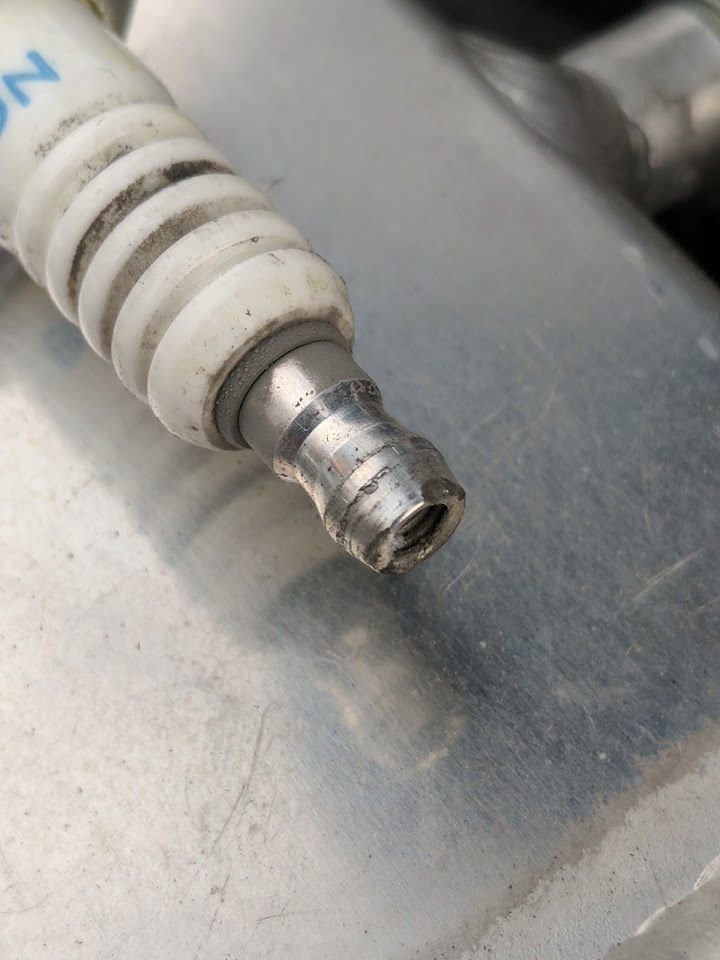

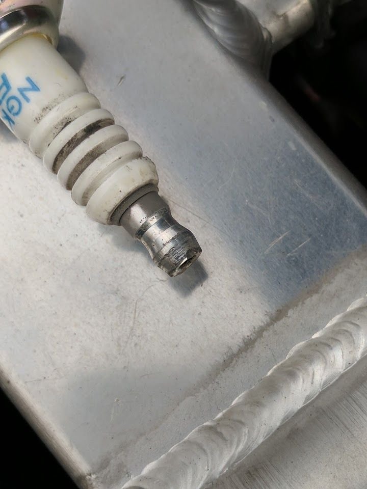

last plug change... i stopped and noticed white residue building up within the coil boot and on the coil spring itself within it...
the non sparking end of the spark plug also would have this residue on it or a build up of it over the connecting area....

Also any pictures of the electrode side of the plug?
Marios

no pics of the electrode side... but they all checked out fine...

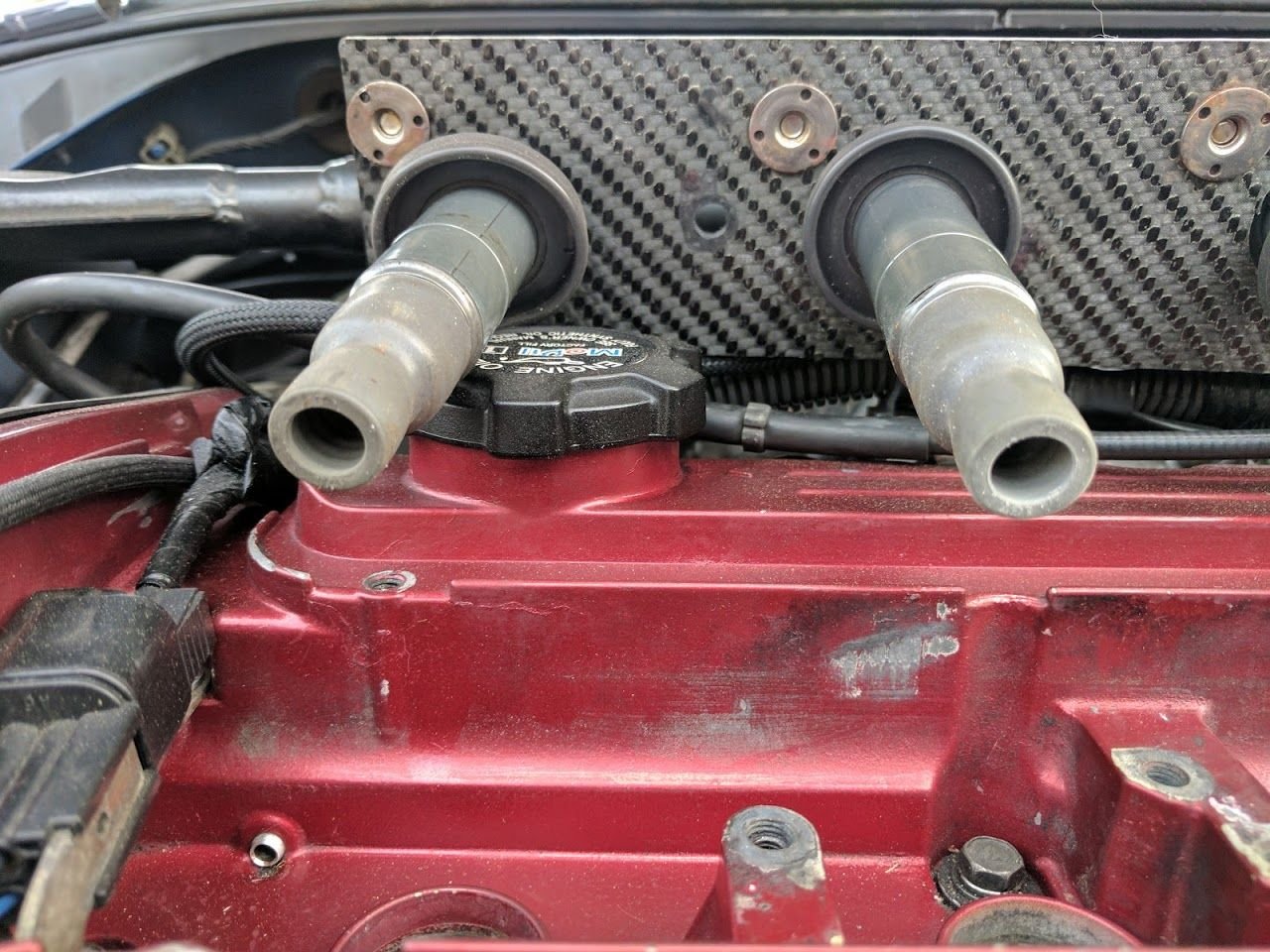

it was nearly impossible to take a picture of the actual coils without damaging the rubber end of the boot...
basically the white residue that you see all over the end of the boot, is caked/built up all over the coil

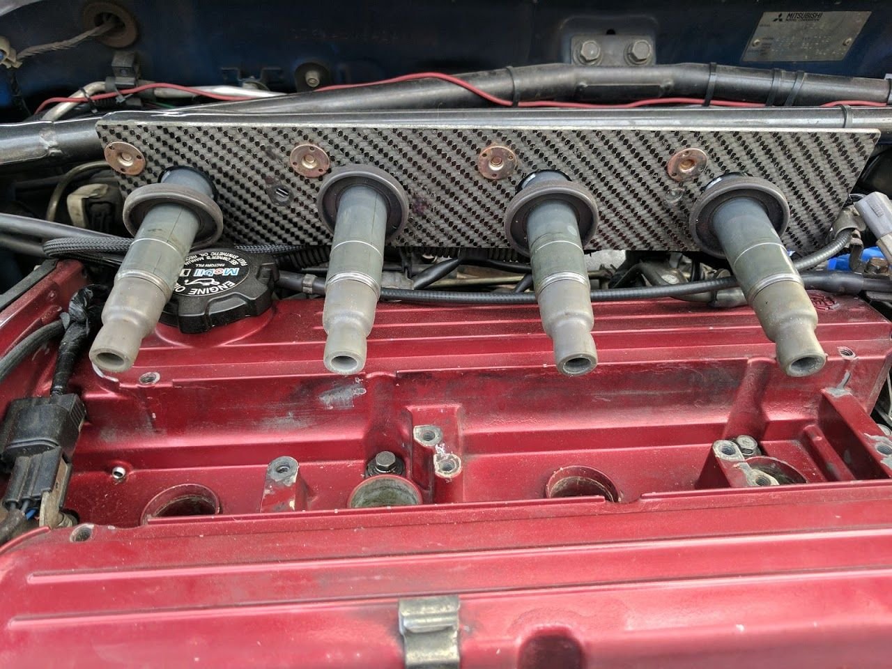

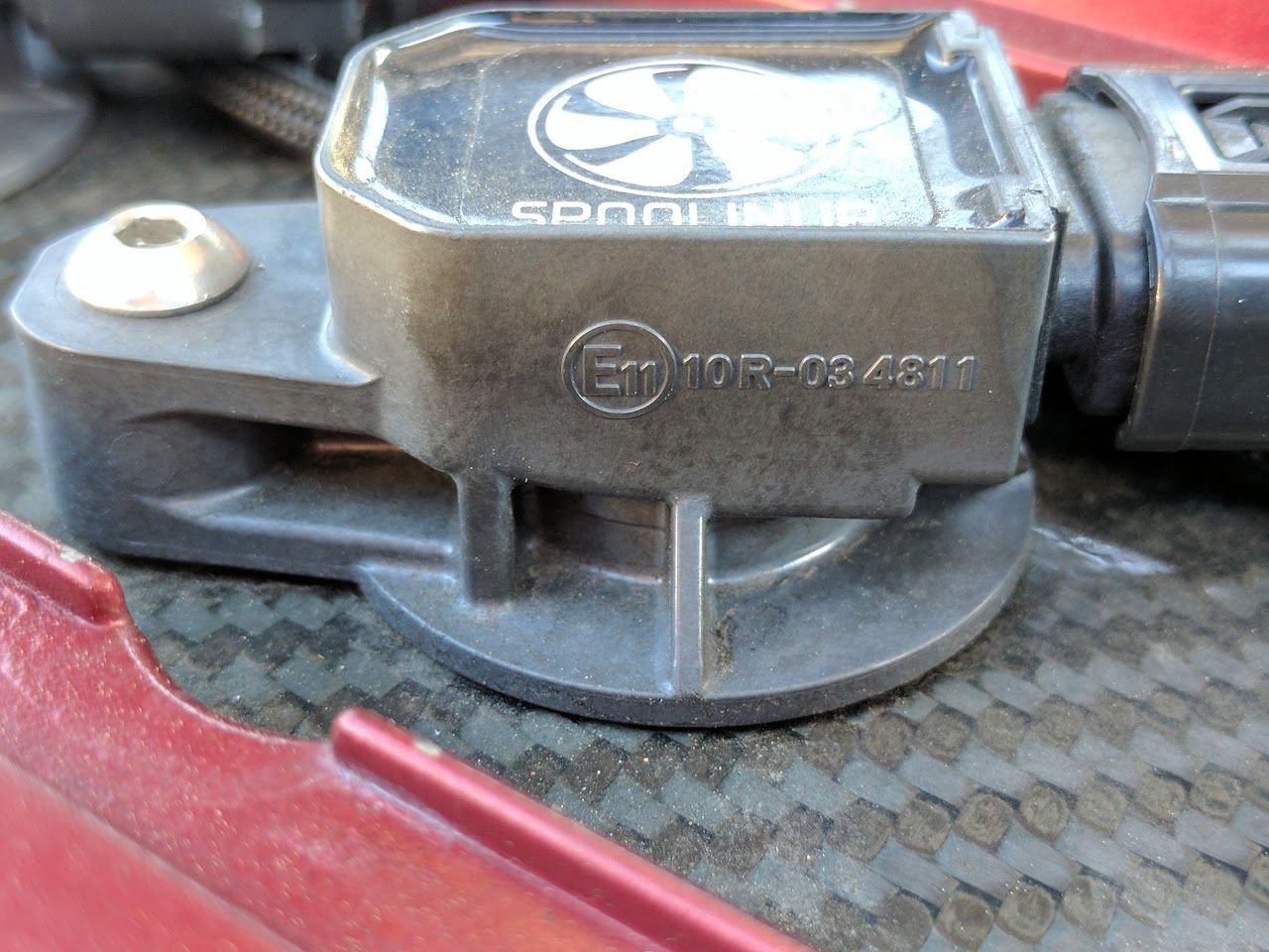

I took a picture of the coils that are currently on the car...
this doesn't match what SpoolinUp has in their DIY and i'm having a hell of a time trying to cross reference the part #

toyota 90919-02240

is this basically the same as to what I posted a picture of on my previous post?

The coil is probably too short so it's sparking from the coil to the plug.

there should be a part number on the other side of the coil from what you showed in the picture above, but yes that part number is the same as the coil you have
he means the spring inside the coil itself. on those short coils with the flat connector you'll need to stretch the spring out
pull the boot off, the spring should be at least even with the plastic housing on the coil. from the factory they aren't
