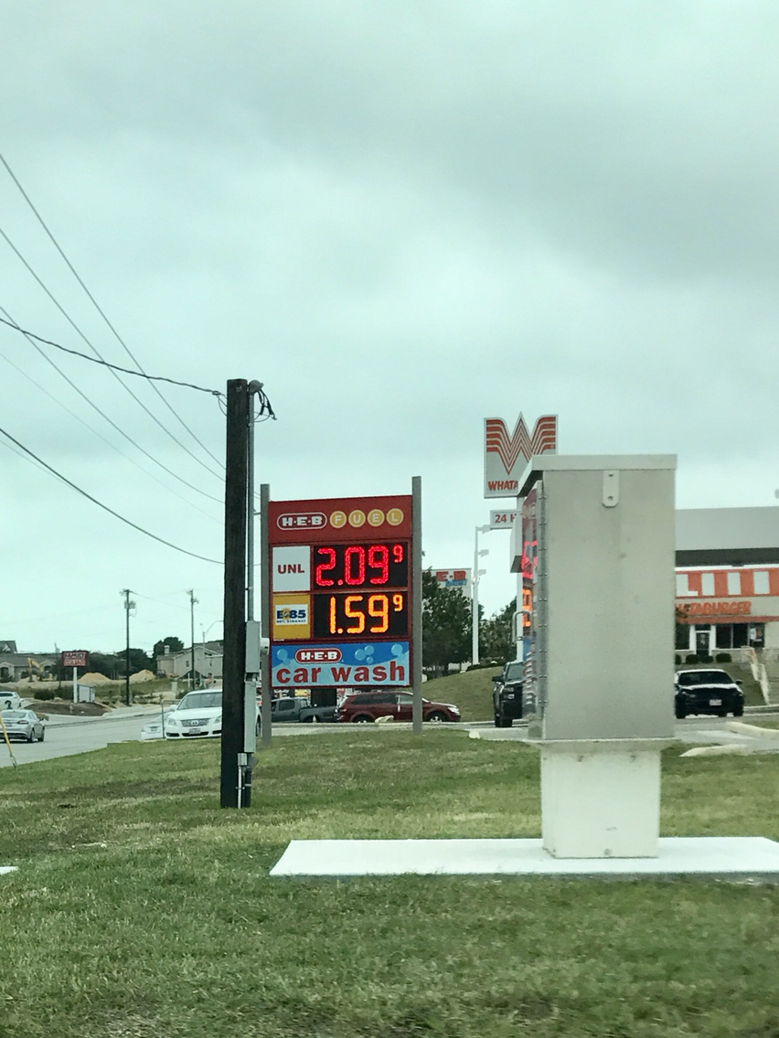

I'm visiting Killeen, TX and it shocked me to see the price of e85 at a local gas station. E85 or 93?-photo293.jpg
Old May 28, 2017 | 08:41 AM
kaj's Avatar
kaj
iTrader: (60)
Posts: 13,634
Likes: 824
From: Fresno, CA
That's awesome. It's a LOT more expensive where I'm at.
