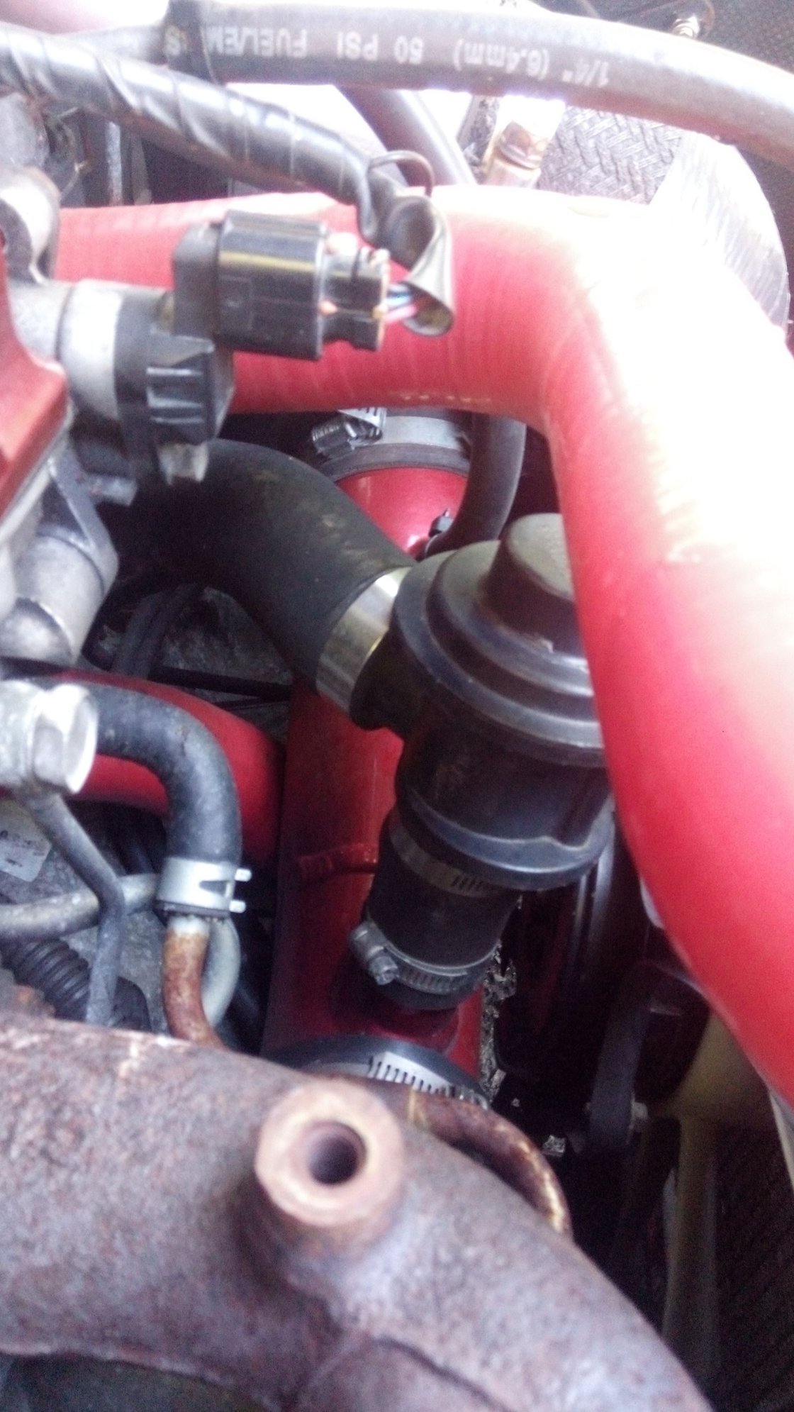

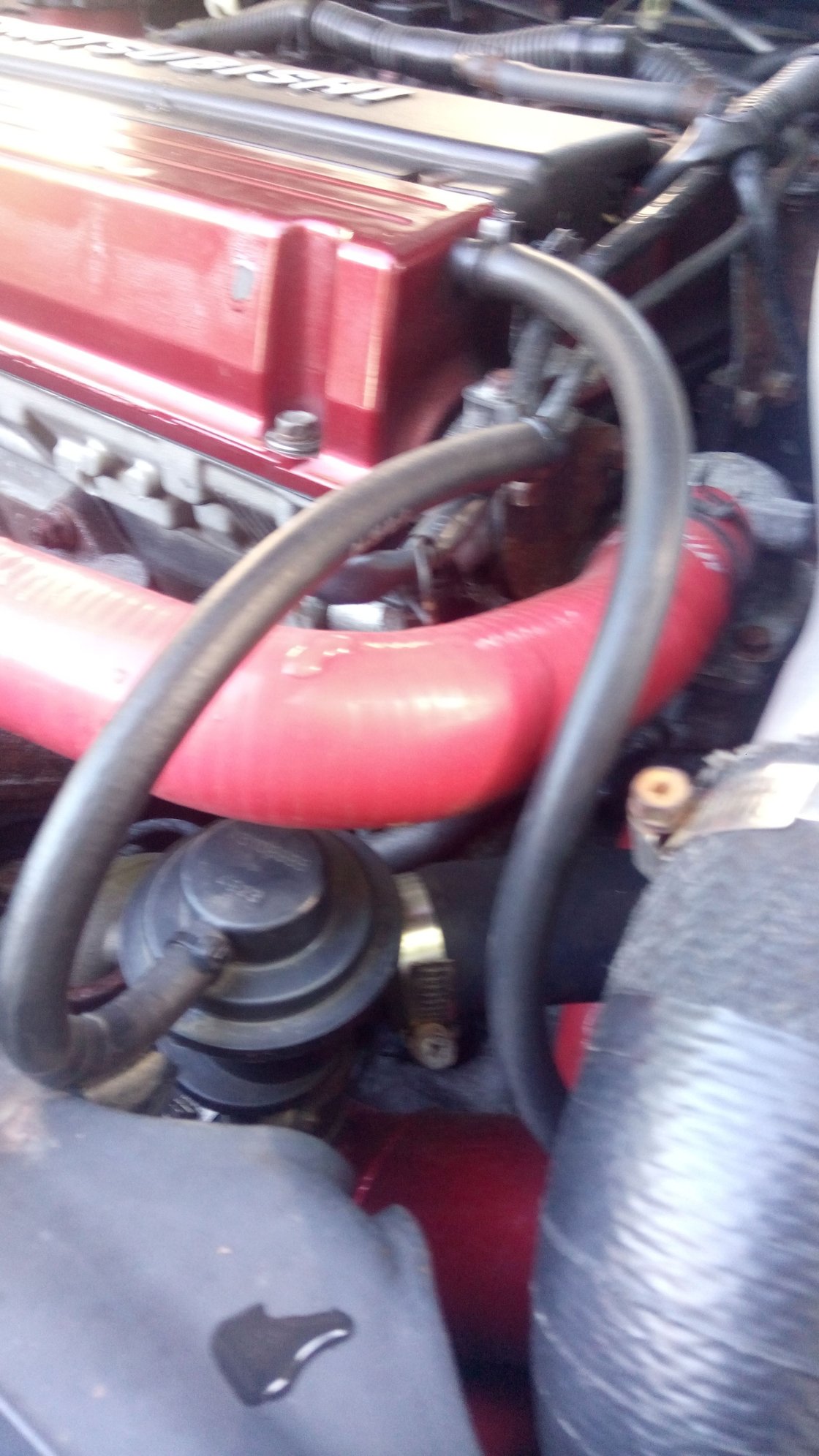

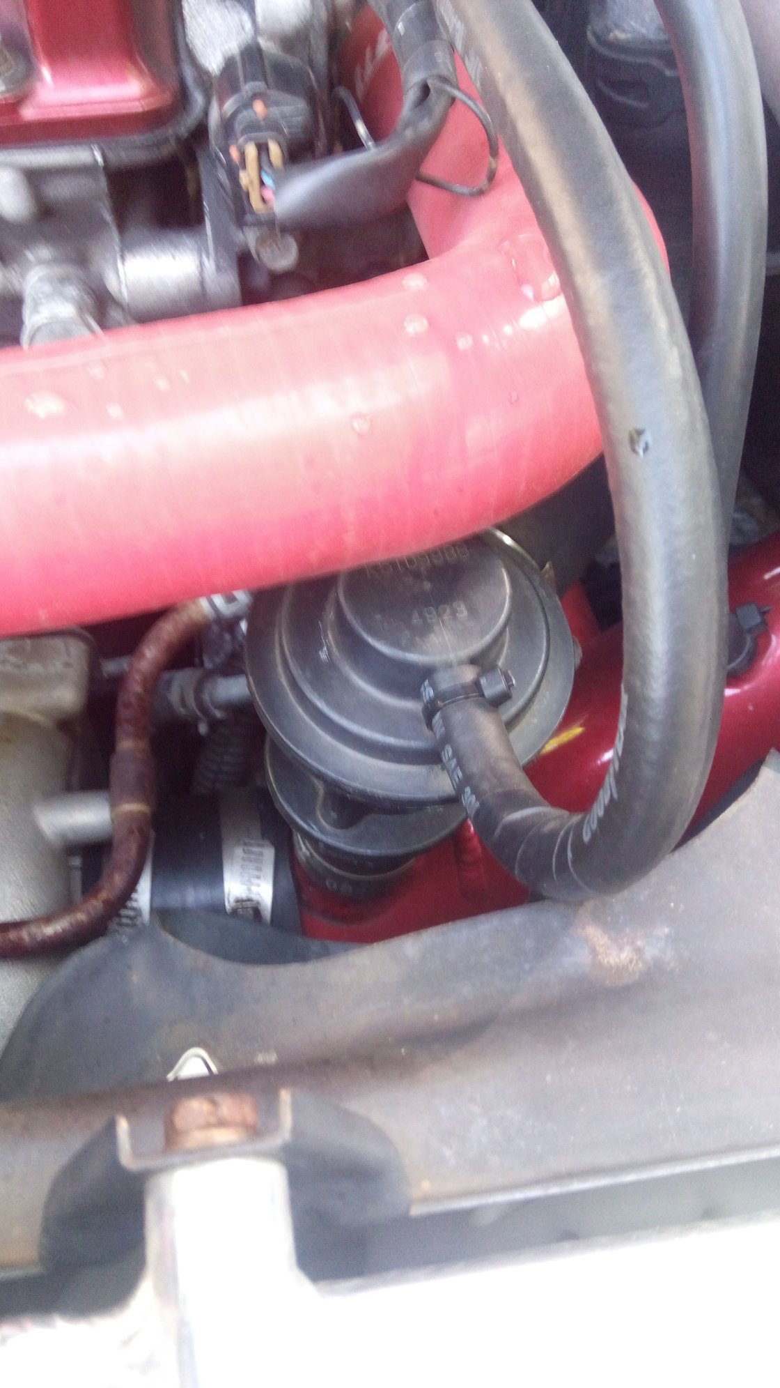

Here it is.... I think its stock

Backwards..

Originally Posted by 211ratsbud
Backwards..
here ya go:
http://www.evomoto.com/article_image.../step_282.jpeg

Most likely not. Its hurting the response of your car some however .

As stated above its routed backwards.
You should fix that. Its not doing its job installed wrong. Sounds cool doh

Another DV installed backwards. Seems like many people don't pay attention to its position before removal and reinstall it backwards since backwards looks better. Being backwards, it's not opening when it is supposed to and opens only when intake manifold has big enough vacuum. And the valve won't open as big.
