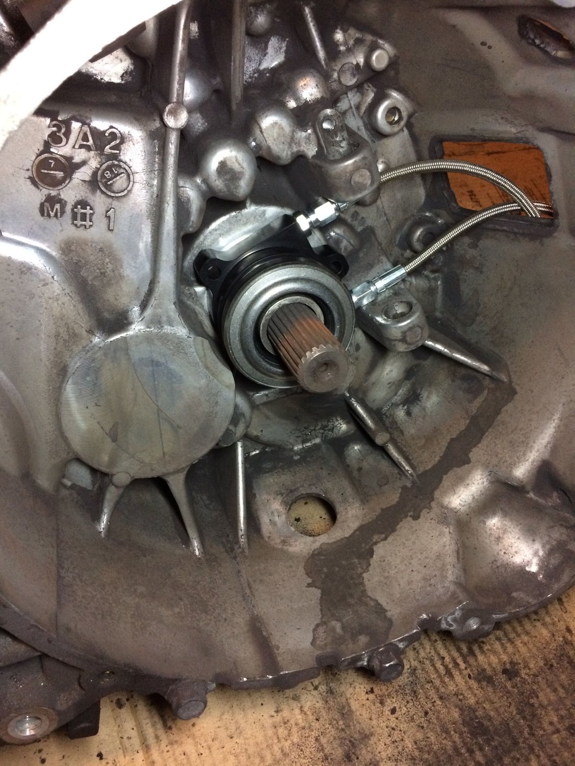

Anyone install a Quartermaster hydraulic release bearing in a 6-speed trans? I haven't seen any pictures of it, but all the writeups say it just bolts on. Problem is that there are no bolt holes for it to bolt onto...

Yes, I got everything sorted out. The kit I purchased didn't have a bushing that should have been there. I'll give you the details and then what I think of how it goes together...
The missing bushing goes around the input shaft of the transmission and the throwout bearing goes around that bushing. There are no screws needed, but the hydraulic cables definitely need to be positioned properly. On the outside of the transmission, the kit does not include the right connector for the hydraulic line from the stock master cylinder. I'm not sure exactly what coupler is needed since I just searched my junk bin for the right one. The starter also needs a minimum 2mm shim to prevent the starter gear from continuously sitting on the flywheel.
What I think of the kit:
I definitely don't like how the throwout bearing mounts to the input shaft of the transmission. The bushing is extremely tight and I had to use a combination of filing, sanding, heating, and hammering to get it on the shaft. The bushing doesn't stop the throwout bearing body from spinning, so it's likely that the hydraulic cables whip back and forth inside the bell housing sometimes...
Other than that one thing, I like the clutch and throwout bearing very much. The pedal feel is really nice, shifting at high speeds is crazy smooth, and starts from stopped are not as bad as advertised.

I just picked up the Quartermaster Street Kit part# 28962P1636 with hydraulic bearing, For the 6 speed. I've got the Albins gearset and 4.09 FD...Gathering parts to build 1000hp 2.0L... I'm not installing it till the Spring time. Maybe I'll make a custom bracket to support the cables. Any extra pictures would be great. Thanks

Sorry for bumping an old thread. Do you have any picture of the item being installed? I cannot visualize on the item being installed
