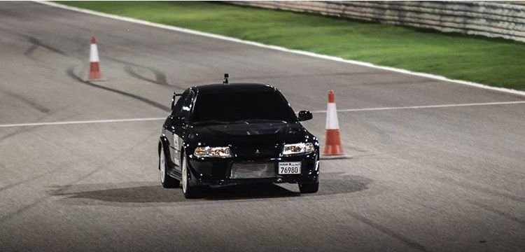

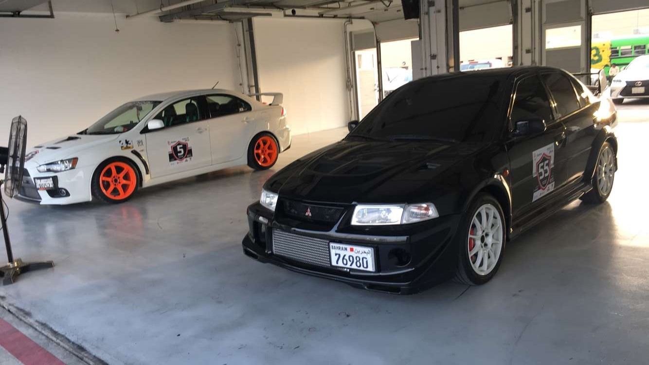

Hello. Moved your thread to this section, as you will likely get a better grouping of responses
Any chance you can post up a pic or 2 of this EvO6.5?
