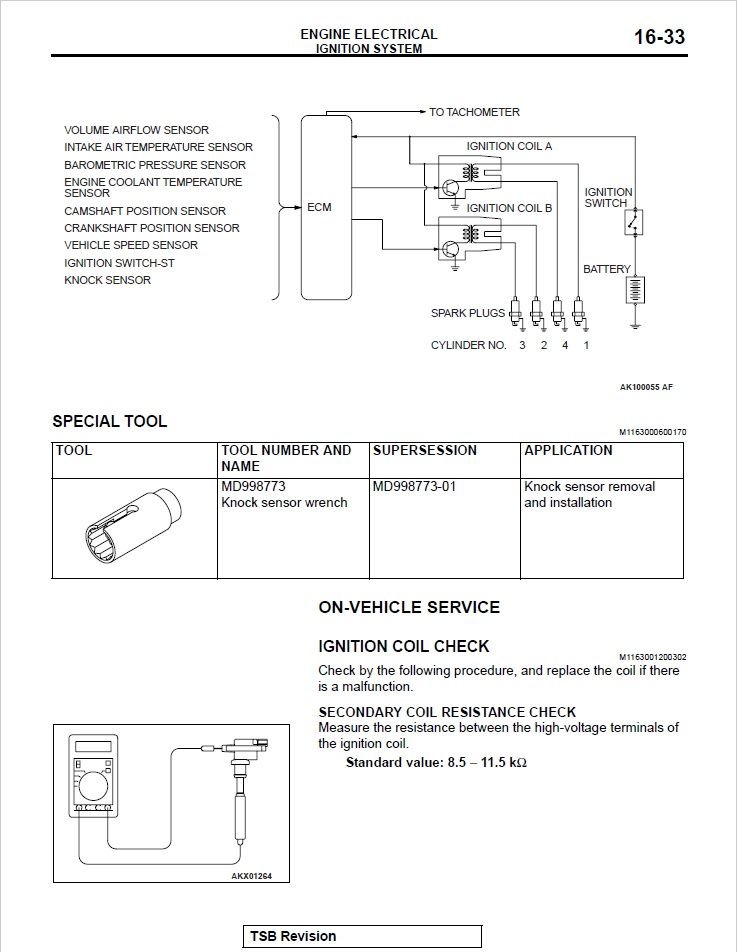

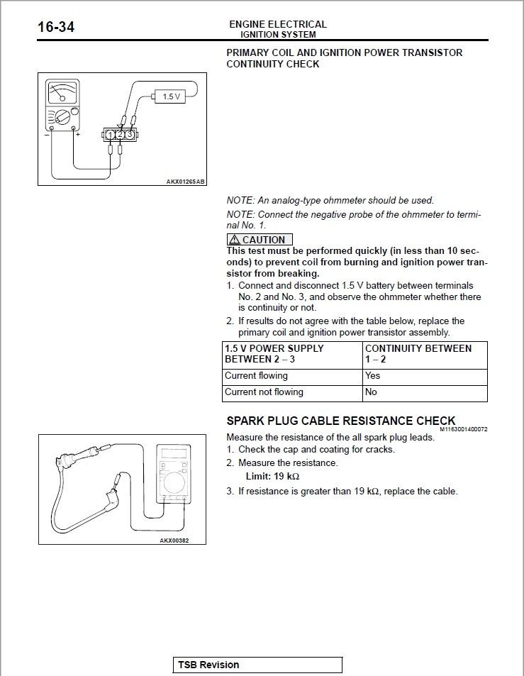

this is how its done for the factory coils, you will have to do some google-fu to find the correct readings for your specific coils
