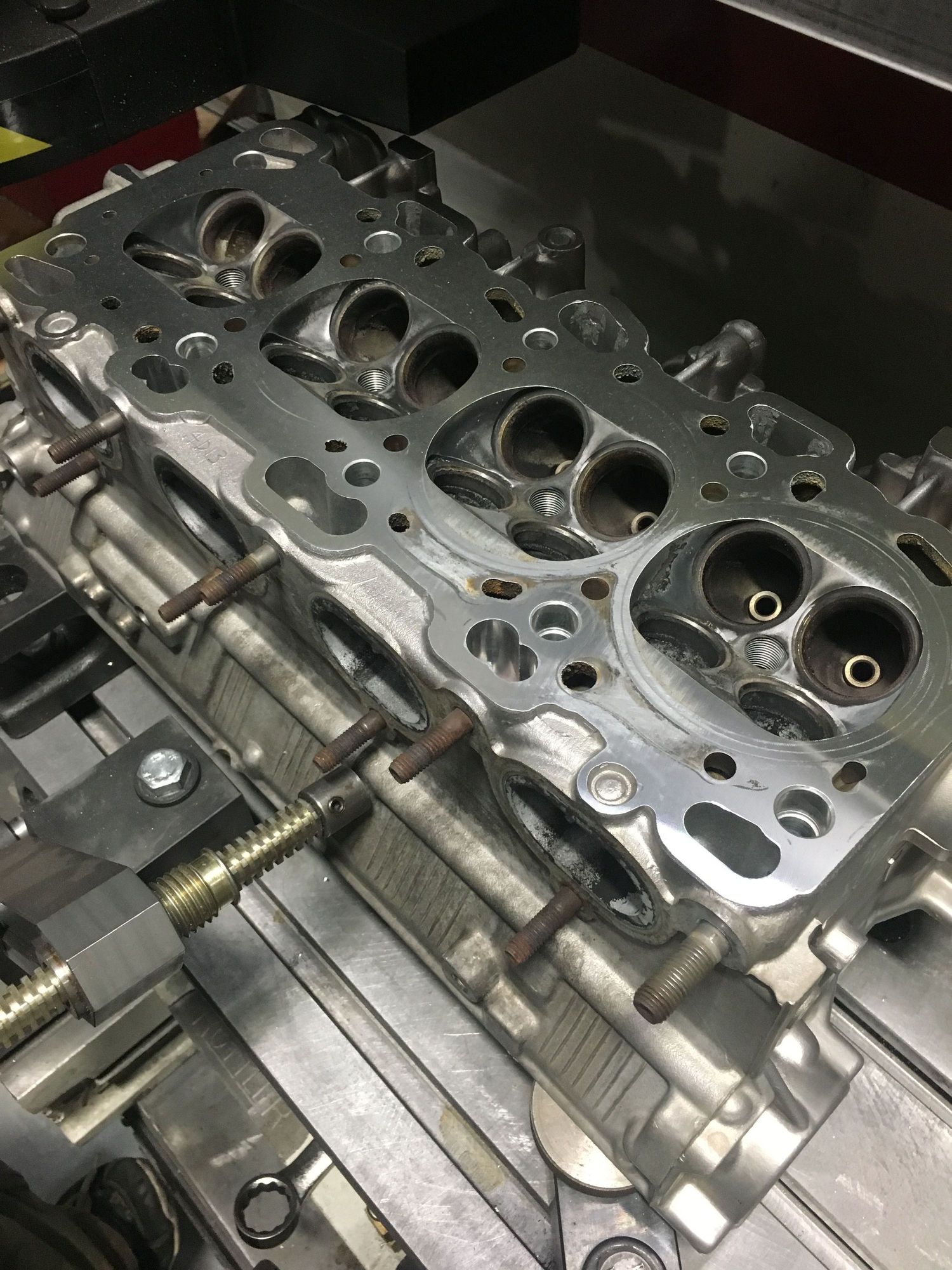

The gasket is but the fire rings on it are what seal the cylinder head and block to the head gasket and those are often a viton type material. The fire ring will usually blow out before the head or block gets damaged.
My head gasket blew out a couple months ago on cyl 1. Check out the fire ring on cyl 1 in this pic, note how half of it is gone.
First pass on the resurfacing machine shows where the head was warped. It's the same spot as where the fire ring was blown out. The head is usually the next thing to get damaged as aluminum will warp a lot easier than iron. OP if your head gasket is blown out then definitely get the decks on your head and block checked out.

Thanks for all the tips guys, will definitely get the decks checked. I could live with head warp but f*** im hoping the block is fine.
