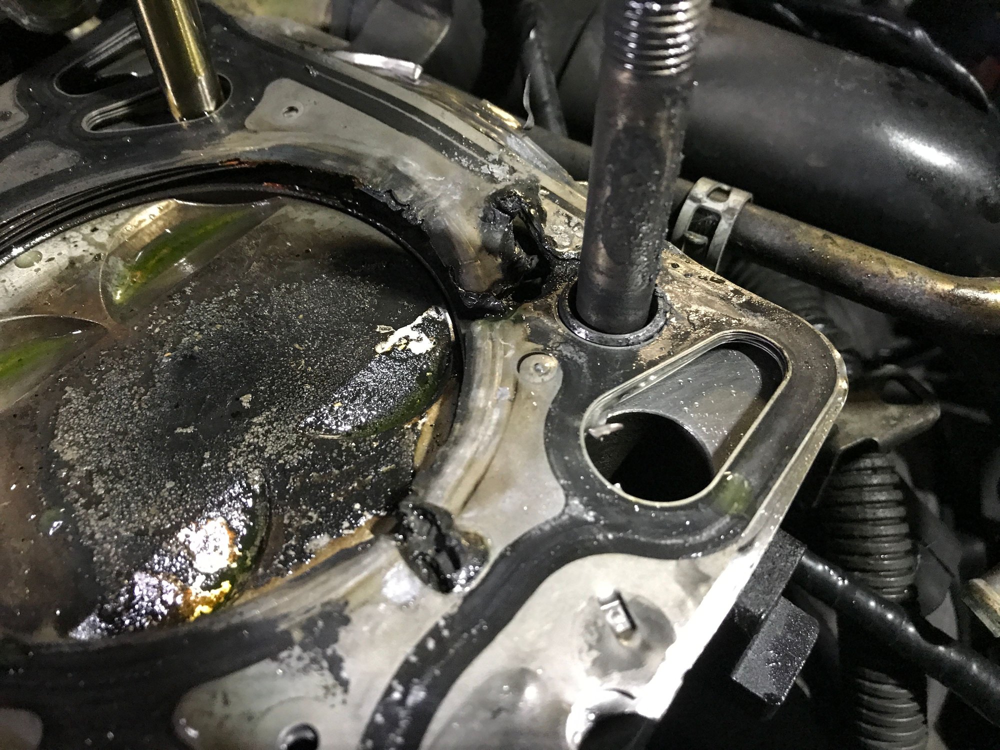

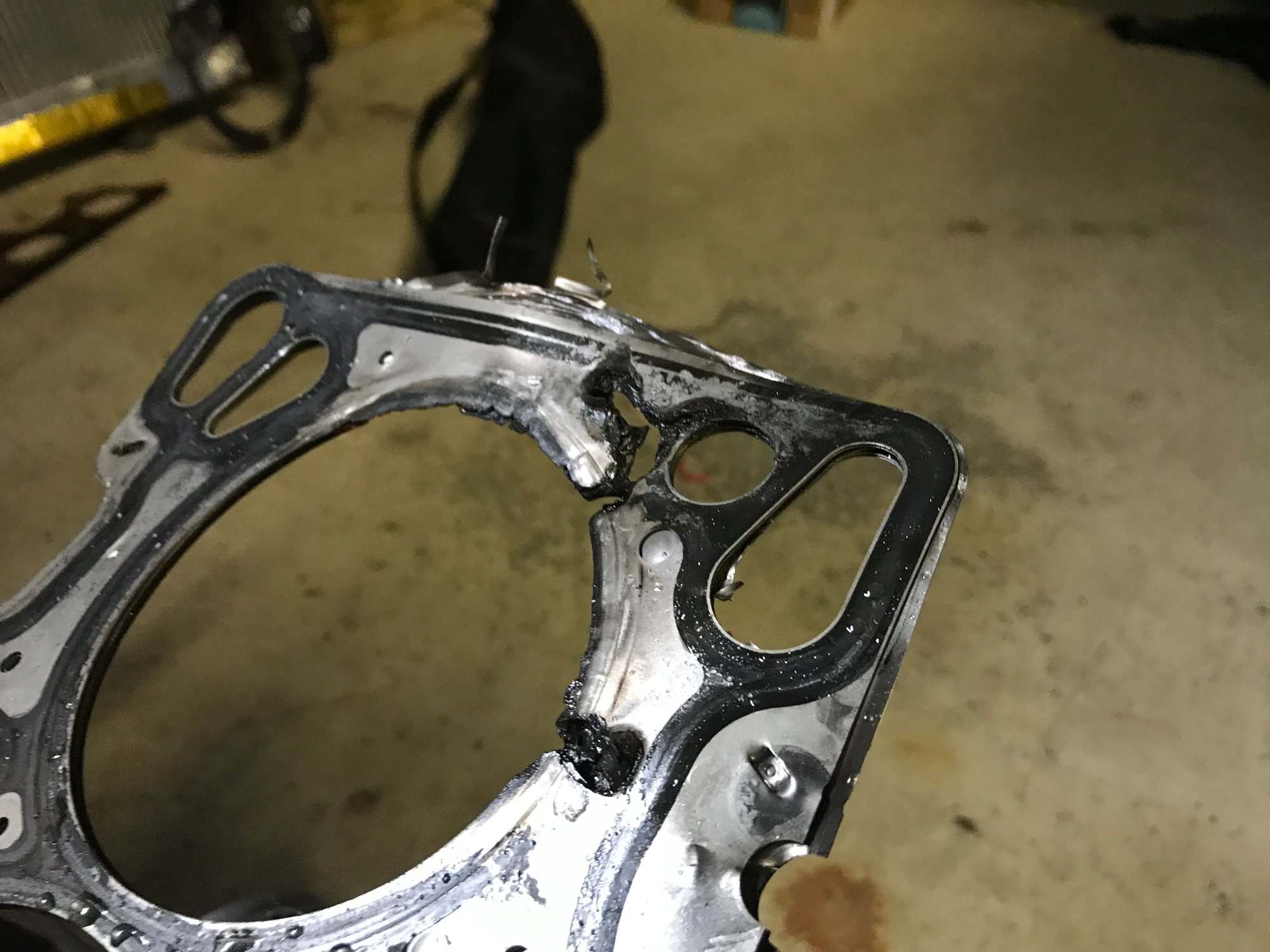

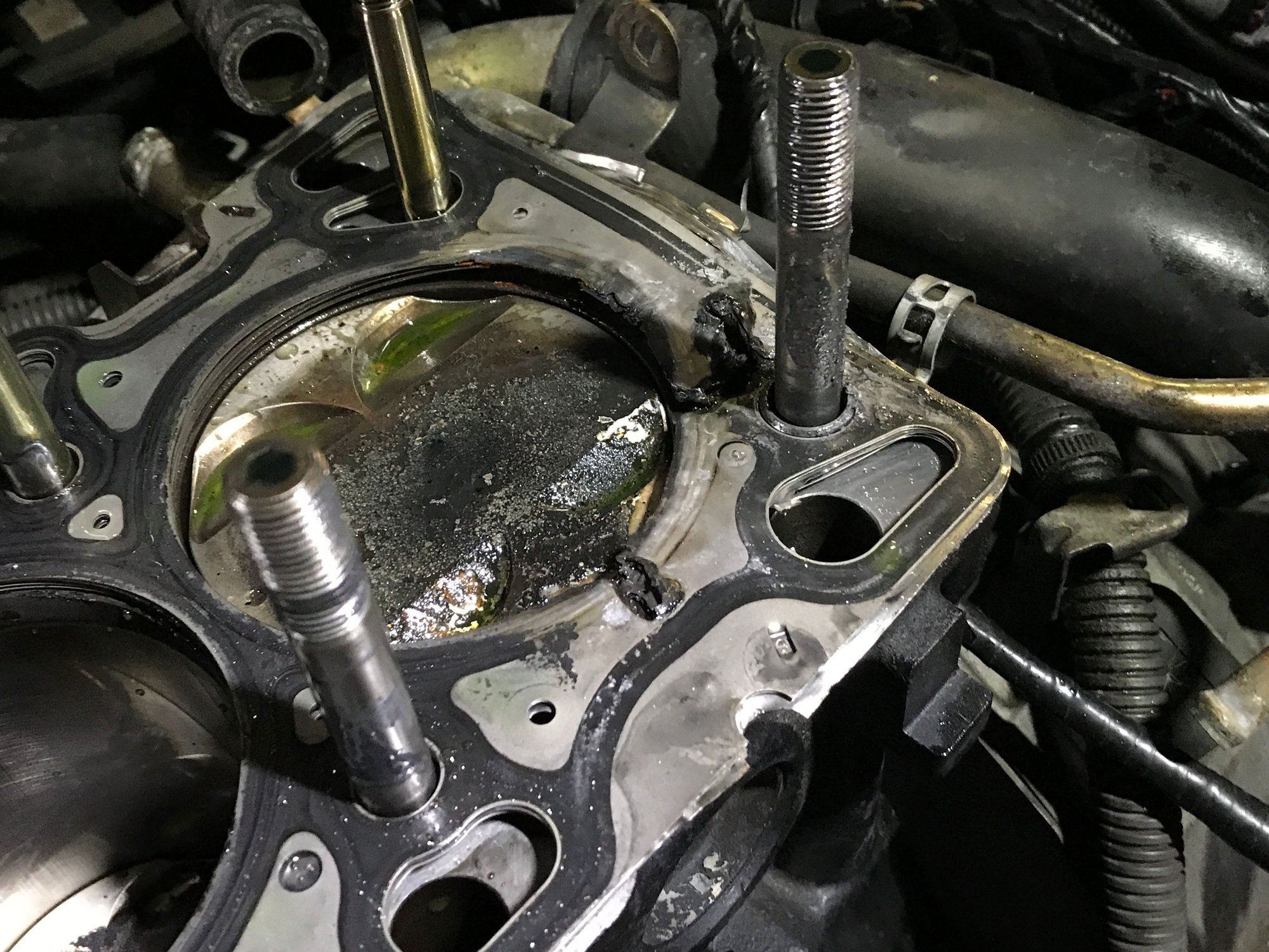

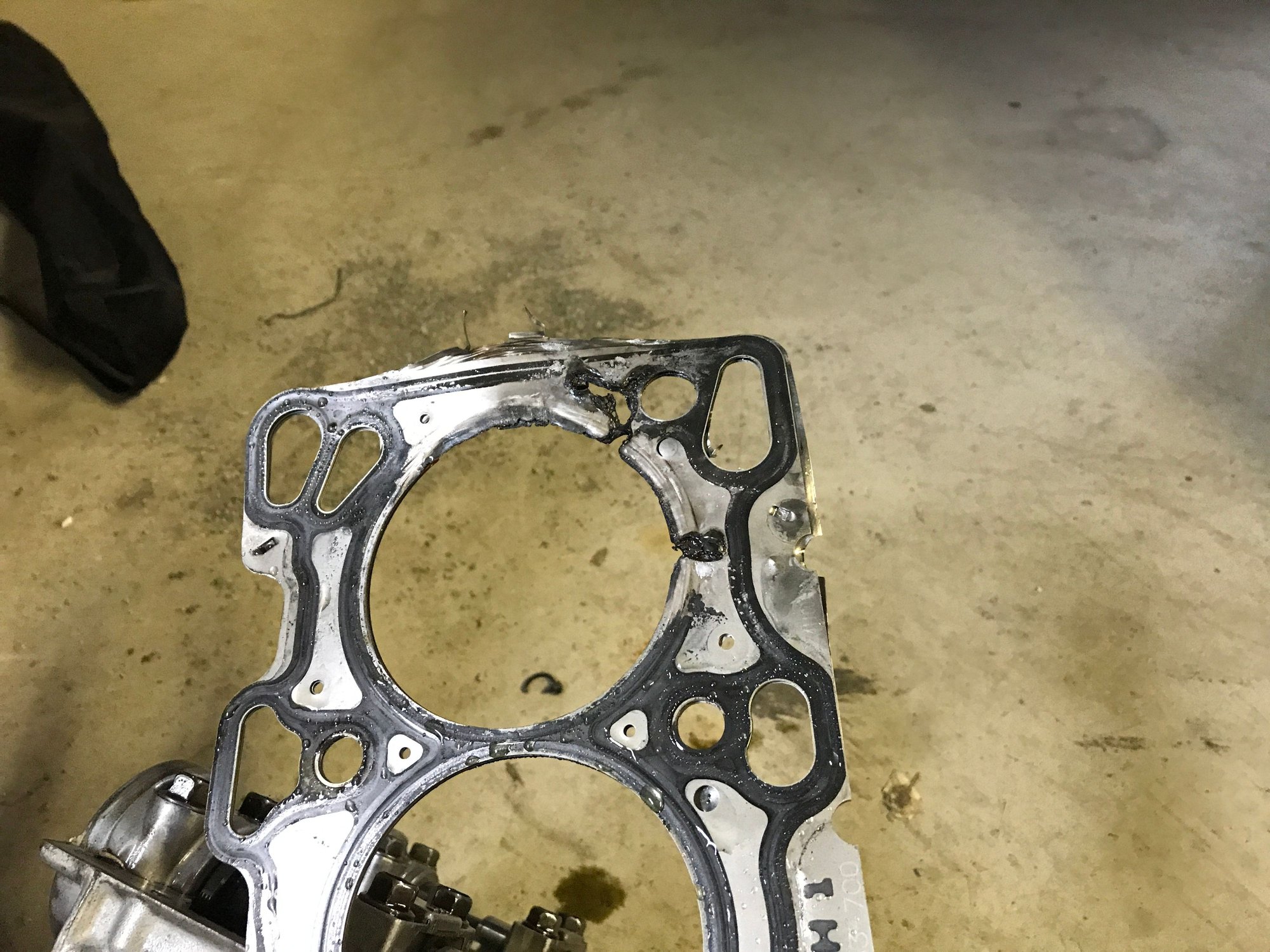

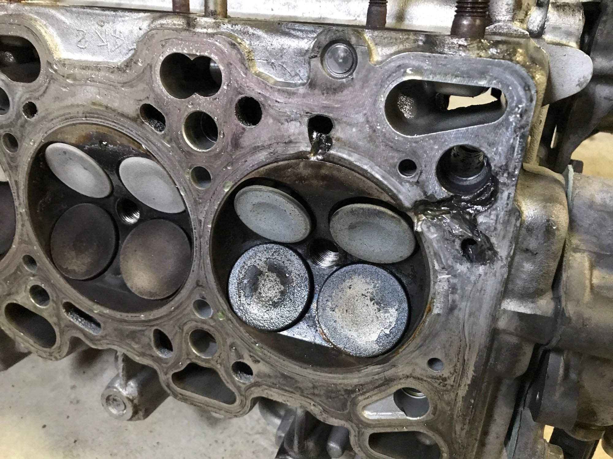

Old Oct 31, 2017 | 11:48 AM
N3WBI3's Avatar
Joined: Jan 2013
Posts: 65
From: Delano, MN
The carnage
Old Oct 31, 2017 | 01:20 PM
heel2toe's Avatar
iTrader: (41)
Joined: Jul 2007
Posts: 4,690
Likes: 128
From: Massachusetts
Ouch head looks trashed bummer! Hows the surface on the block?
Old Nov 1, 2017 | 12:17 PM
N3WBI3's Avatar
Joined: Jan 2013
Posts: 65
From: Delano, MN
Block surface looks OK thank god.
