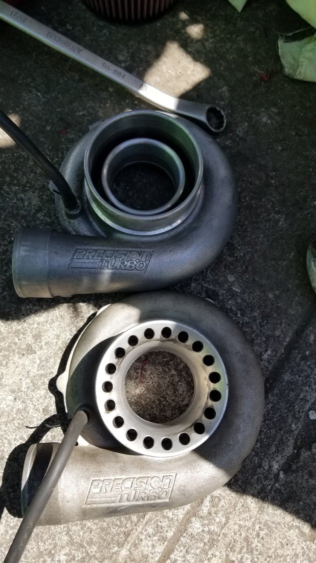

Problem solved...
The problem was the Slotted anti surge compressor cover of the turbo..
After change for a drilled anti surge cover, the afr put normal in idle 15-16 afr (kelford cams). I think the MAF read different with a slotted cover, although my tuner said the slotted its better but I need re scale the maf sensor I think...
Slotted cover its on the top and drilled anti surge cover is down.
