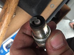

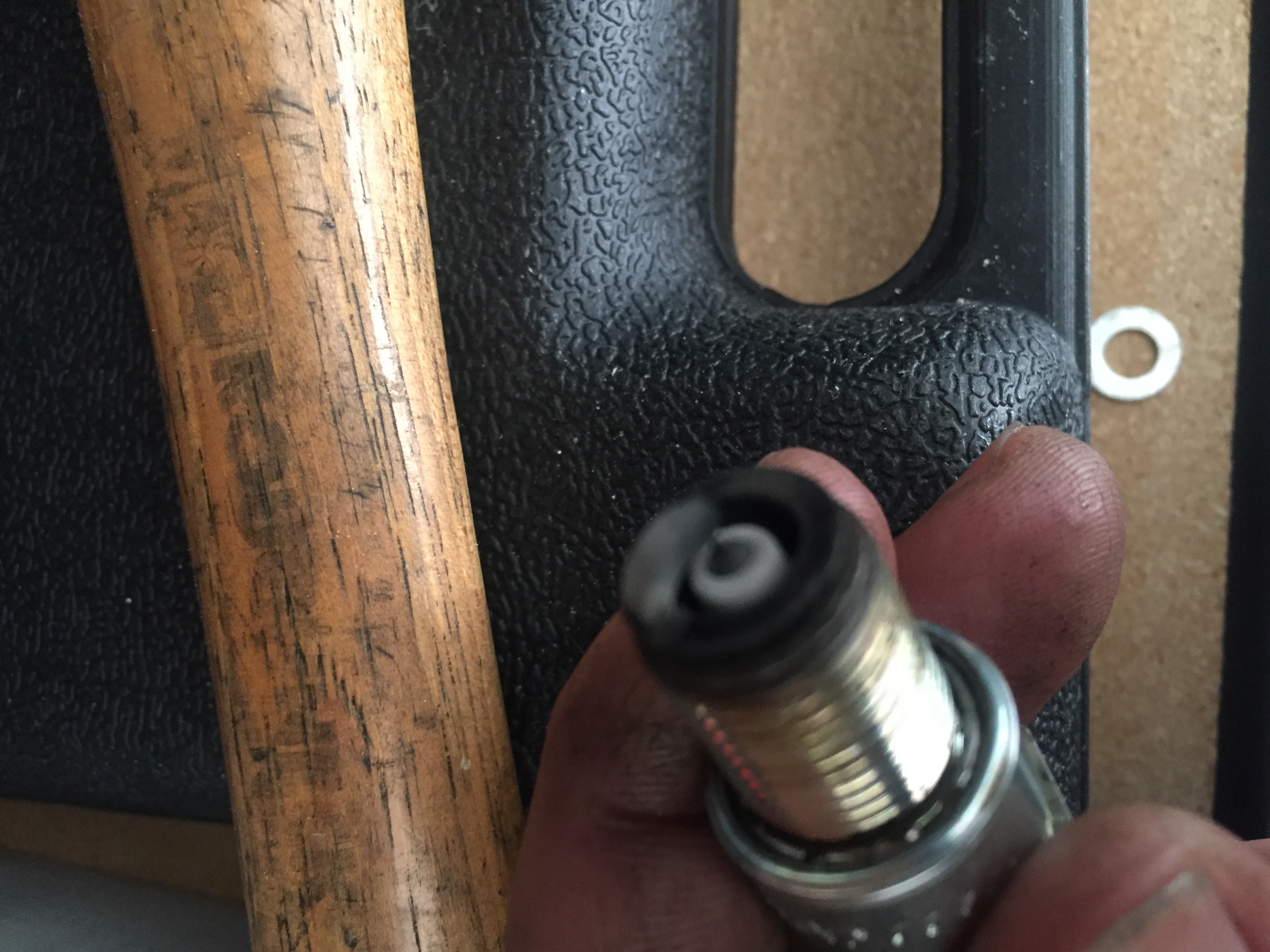

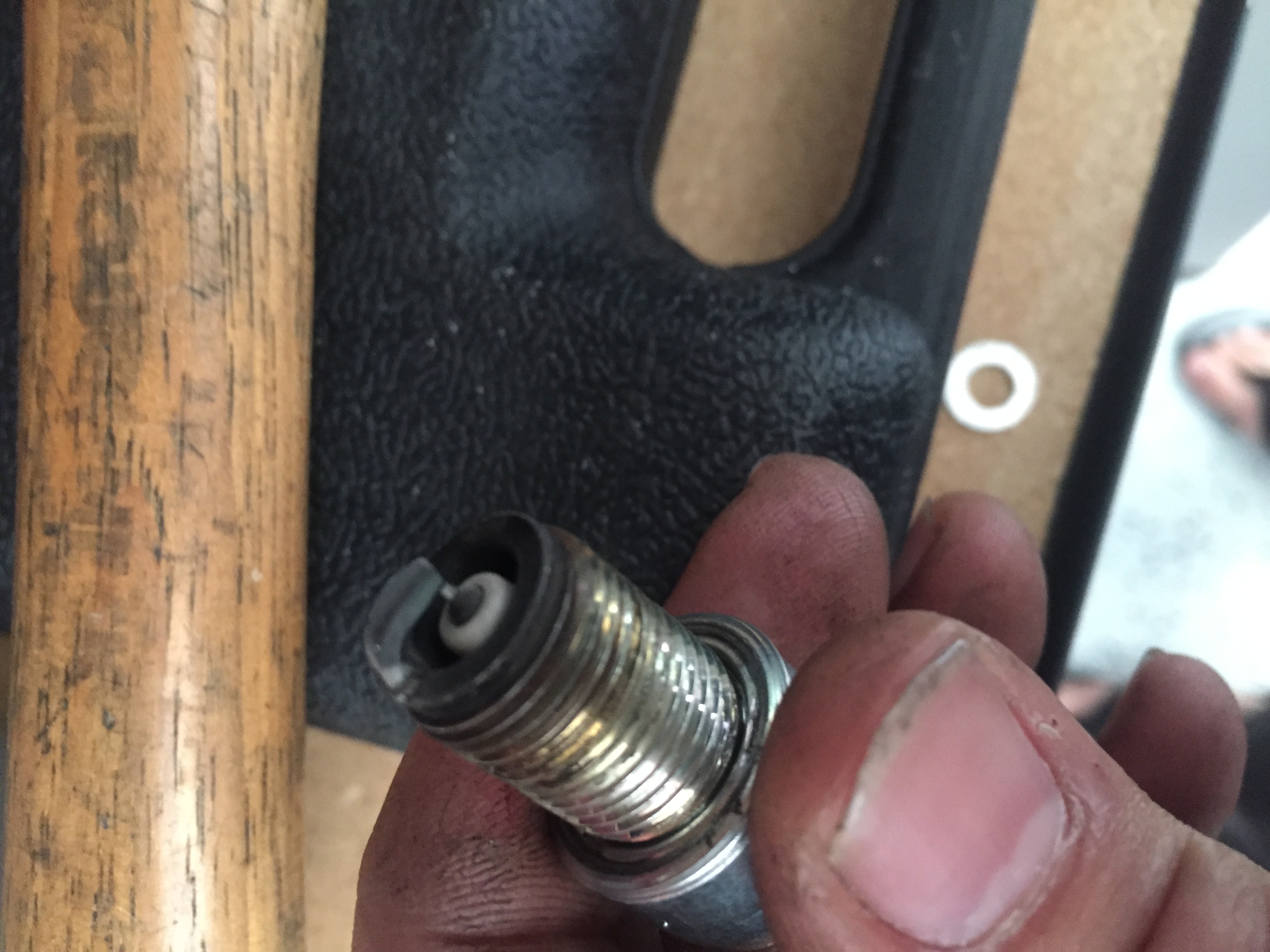

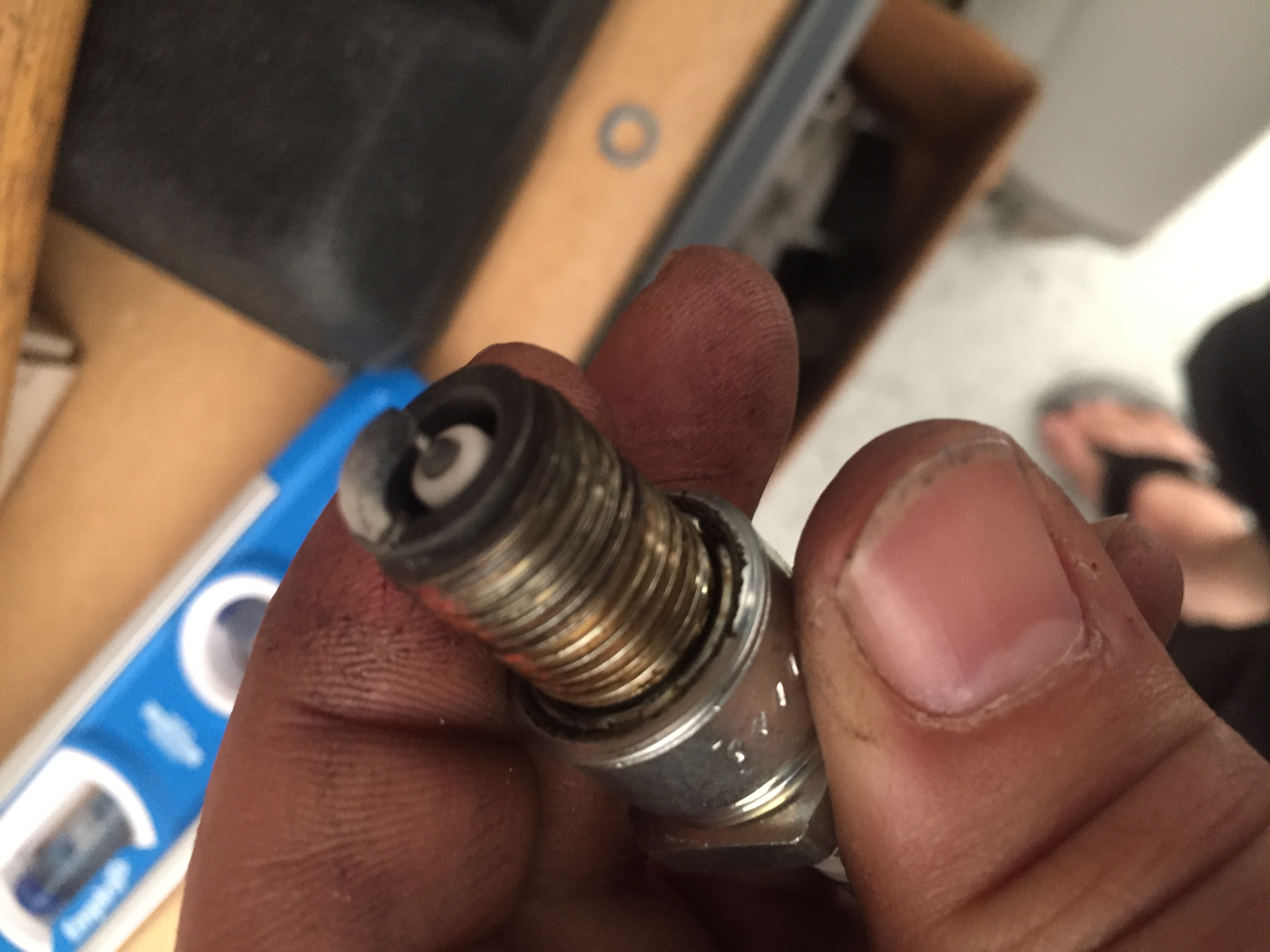

FIrst to last cyl 1 - 4...
Attached Thumbnails low compression-a45f86f3-42e6-4b5f-8790-a378ddfbb9b7.jpeg   low compression-028bbdc8-7dce-465c-b921-08742b80f495.jpeg   low compression-8af61bfa-1ead-468f-b386-2cbb997679cc.jpeg   low compression-17c15c85-3a5d-4b28-91f9-c8d1ee0092c1.jpeg

Originally Posted by nor11384
They’re bc cams which are ****ty but car runs fine. That’s the weird part, no signs of any damage.
The cams weren't degreed when they were fitted.
The plugs show no signs of oil which is good but it's running too rich at low load and quite lean at high load.
But that all fits in with your previous posts.
