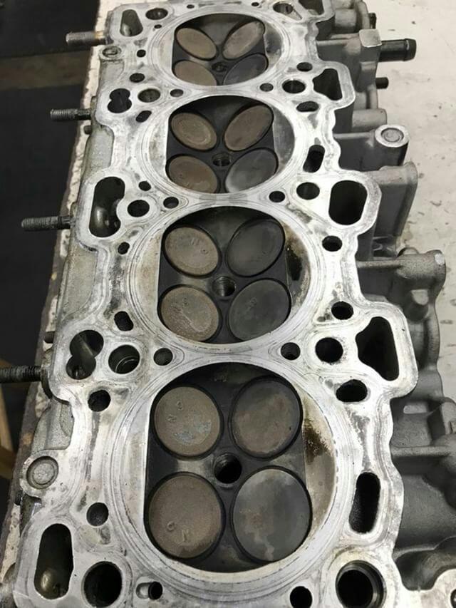

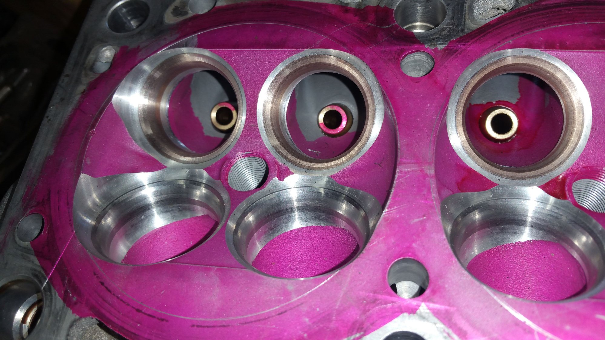

It does. I think every cylinder was leaking something at the valves. Time for a machine shop to perform their magic. I chose a shop in Riverside to do the work. Arlington Machine. Pictures to come.
This is someone else's evo 9 head. I should be getting the same work done to mine. This isn't done yet (this is right after the valve seats were cut). They still have to blend the cuts to the chambers.

Way to go there Donald. Great work & attention to the important aspects of the rework

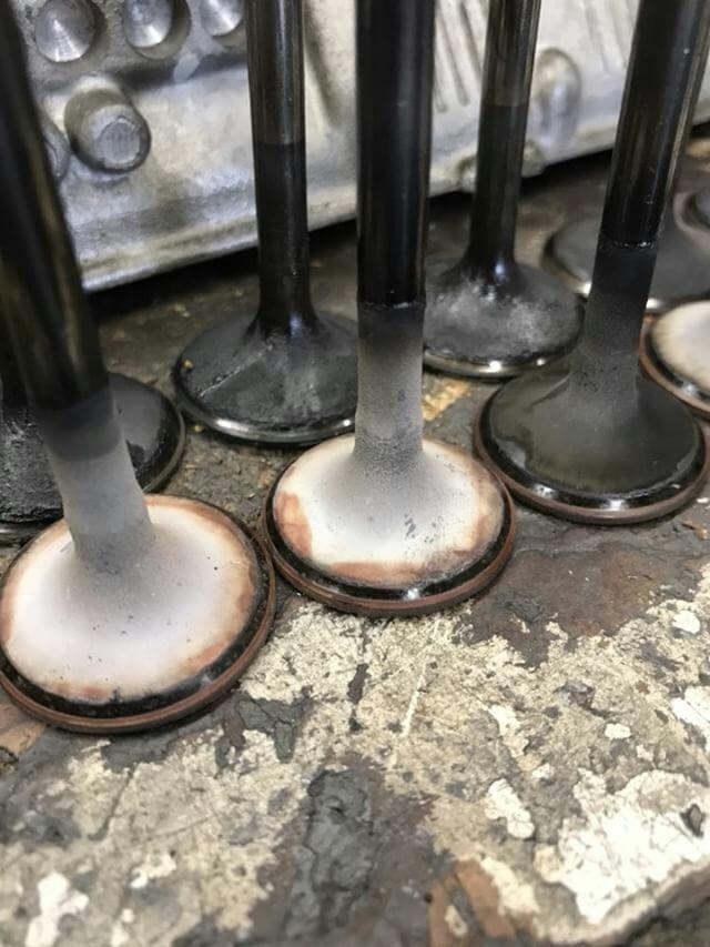

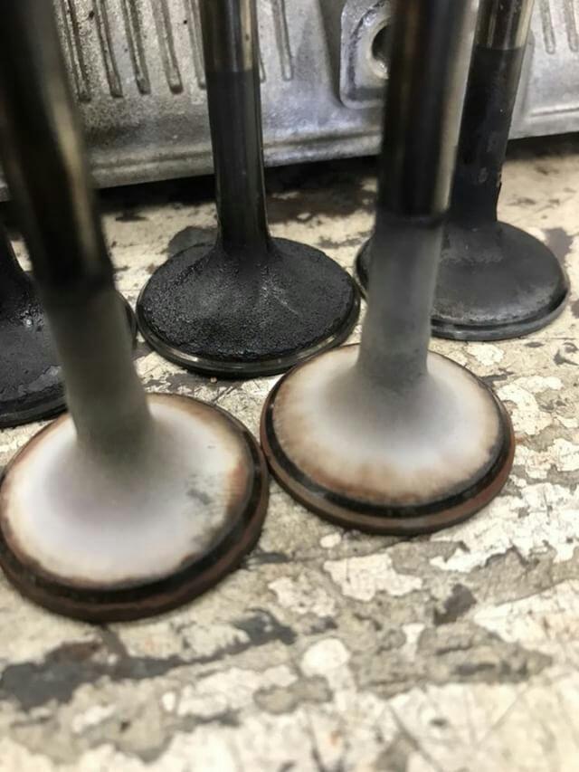

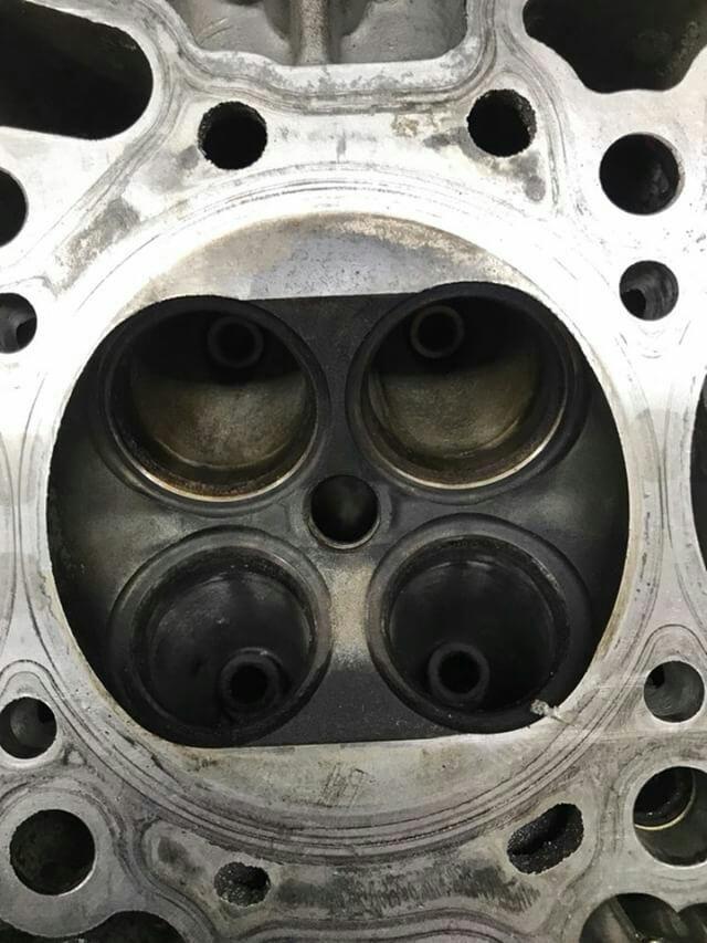

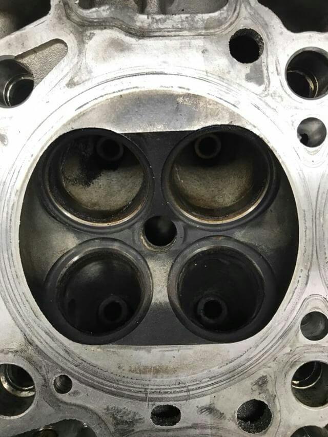

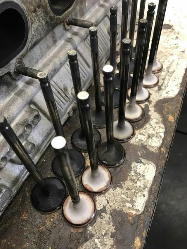

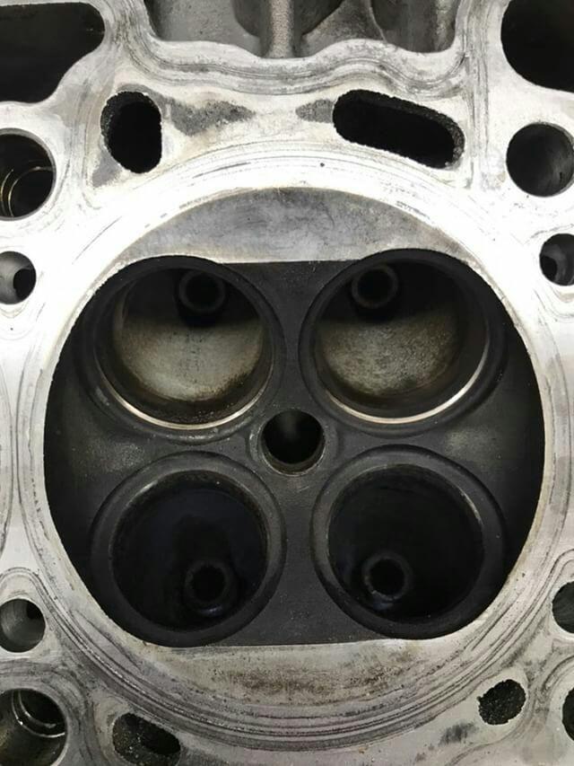

Ugly duckling head..

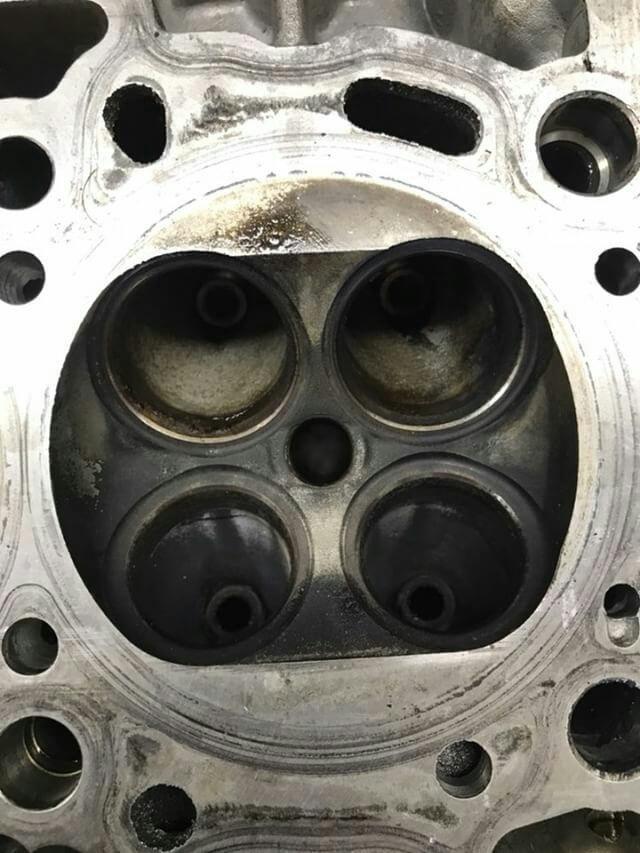

From: California

Looks normal to me
Old Mar 30, 2018 | 05:06 PM
  #44
How long have you been on E85?
Old Mar 30, 2018 | 05:13 PM
  #45
2006EvoIXer's Avatar
Joined: Jul 2012
Posts: 3,294
Likes: 197
From: California
Since May of last year.
