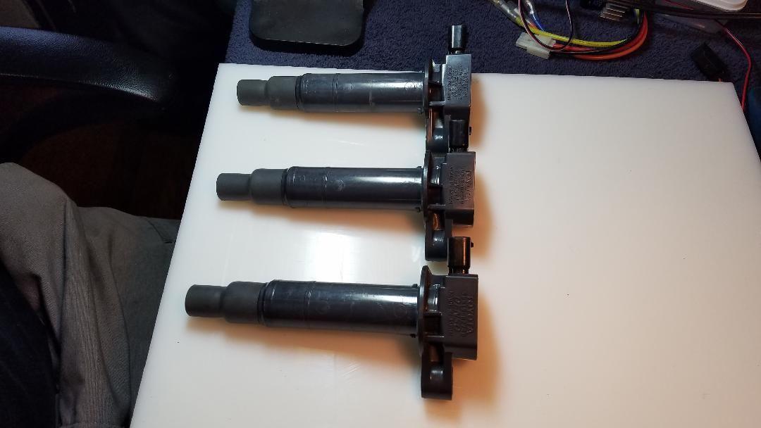

Sorry, misread. Do you have picture of your failed coils? I suggest checking your black ground wires. With the COP, you changed the pathway of how the spark moves. The OEM travels from one spatk plug to the other is the system (1&4 or 2&3) and returns to the coil (see diagram).

Here's a pic of three, the one on the left is still known good, and the two on the right misfire when isolated. There is no warping, bulging or otherwise overheating happening. I have melted coils on prior cars when I set the rise/fall option on a Motec incorrectly. Melted a pair of AC Delco (vette) coils and they looked obviously melted. These Densos aren't overheating as far as I can tell.
I test these by installing one of the factory coils for cylinders 1&4, then I run the COPs on cylinders 2&3. I then swap out coils until I find the one that misfires. I've also swapped this test around using a factory coil on cylinders 2&3.
OK, so you're suggesting I literally drop another ground wire from each side of the coil harness right to ground on the engine block? Just making sure I get the concept here. And thank you for the suggestion!
