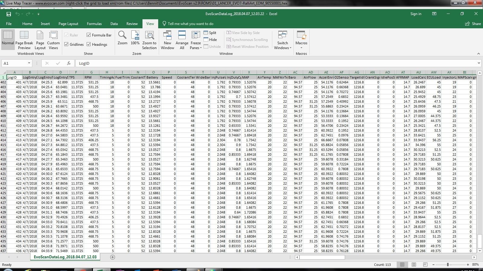

I was able to log it at low idle before it stalled. Not sure exactly what these cars deisre but this is what I am trying to work with. Maybe a second opinion from someone would be benificial

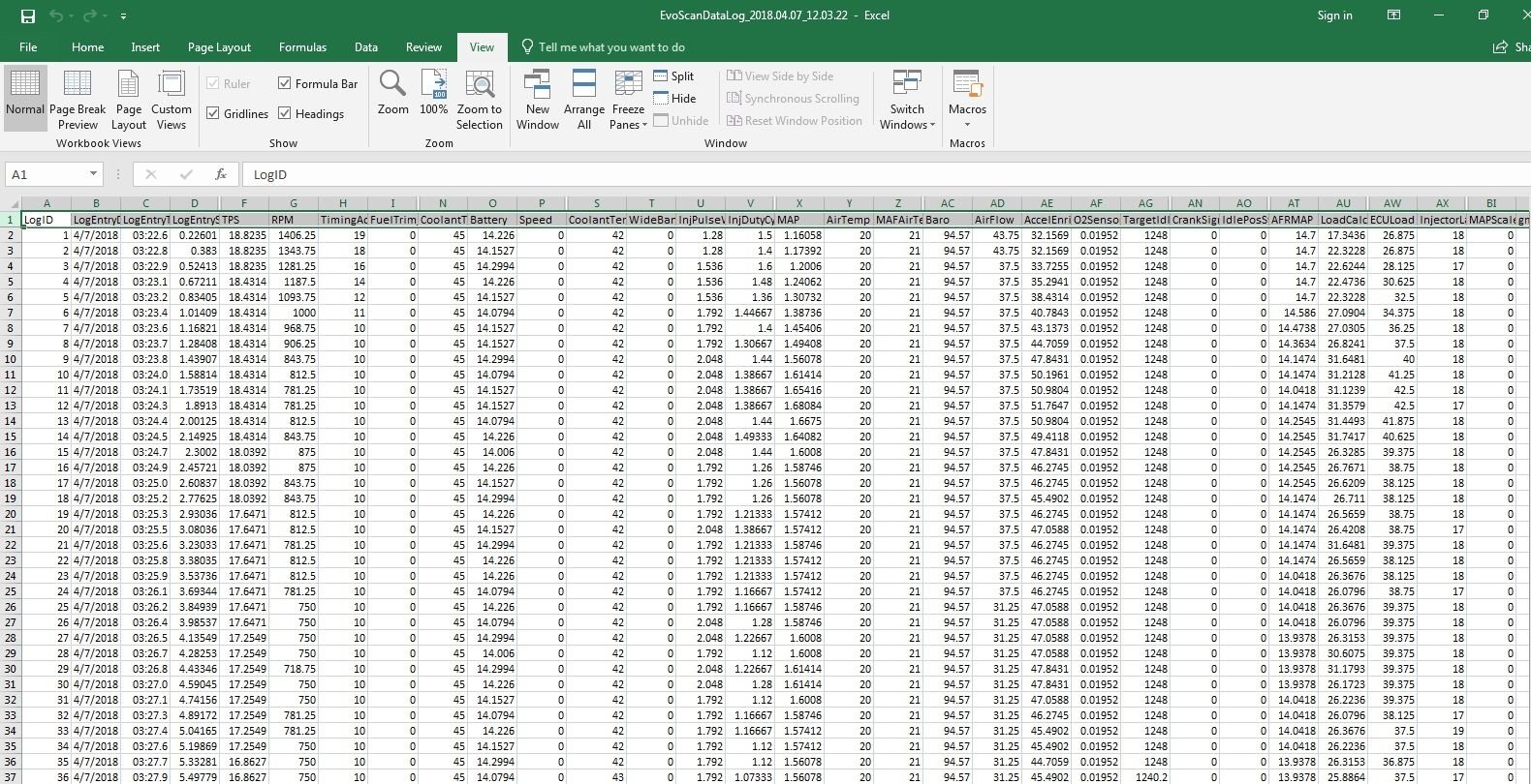

This is the initial start up holding throttle to keep car running before letting it idle on its own, otherwise it just dies.

Only thing I see that could be worth checking is the O2 sensor. I assume that reading is in volts? Idle/cruise should be 0.5v. Yours seems to be jumping all over.
