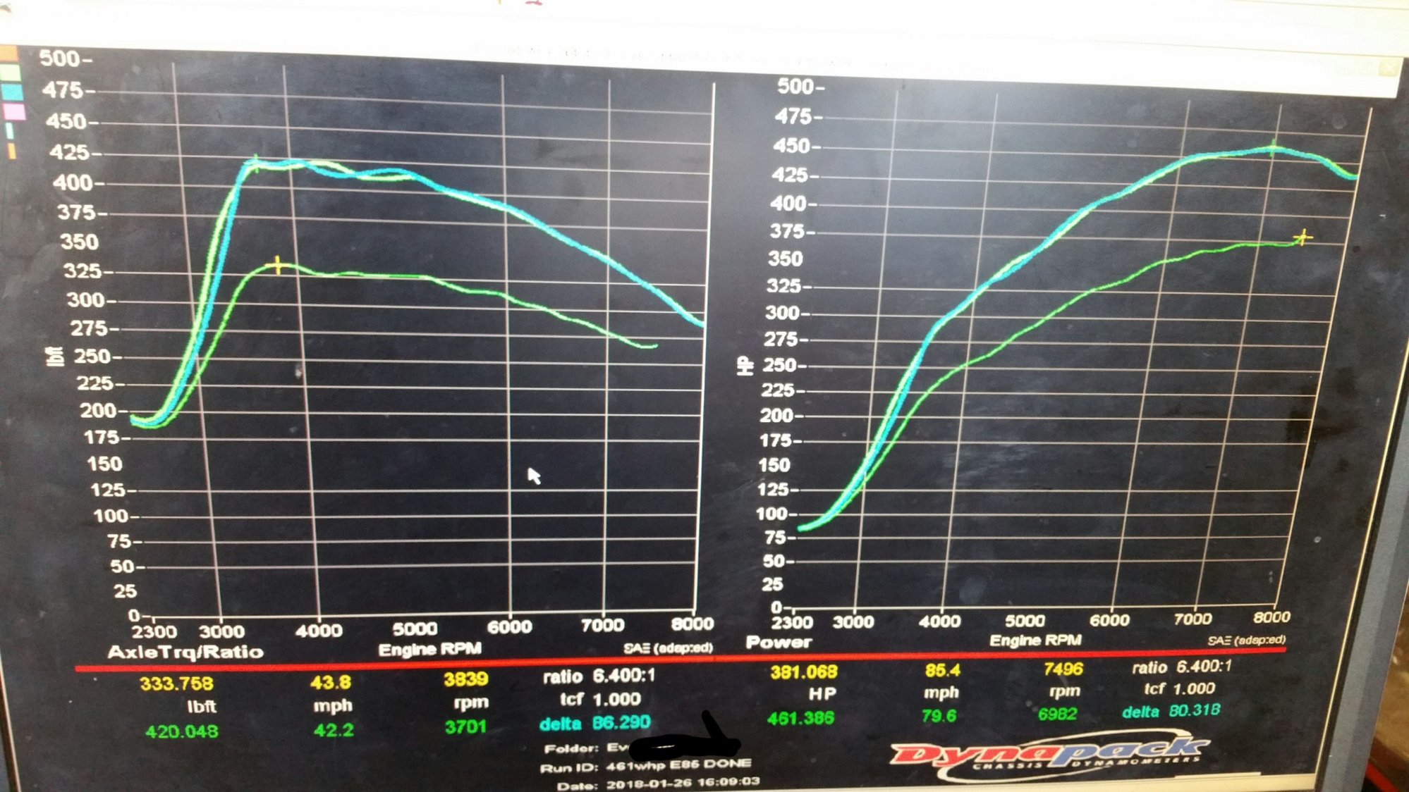

yes, 461 hp / 420 tq without rewire and injectors hitting 104% IDC.
