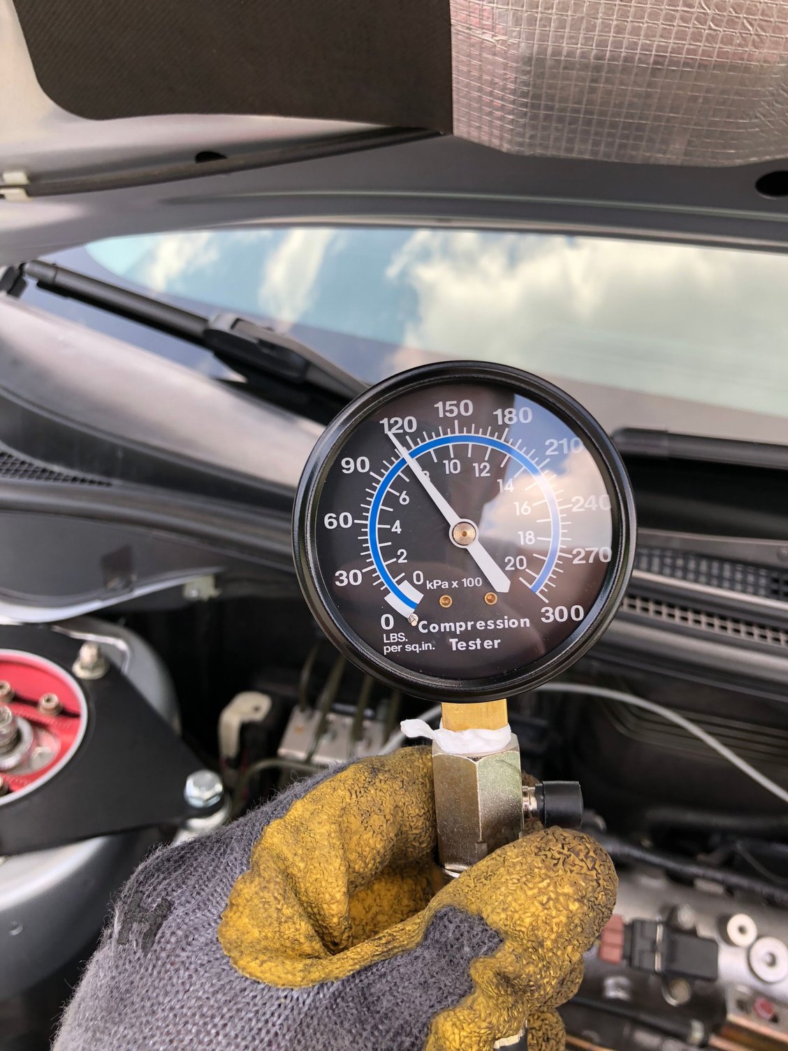

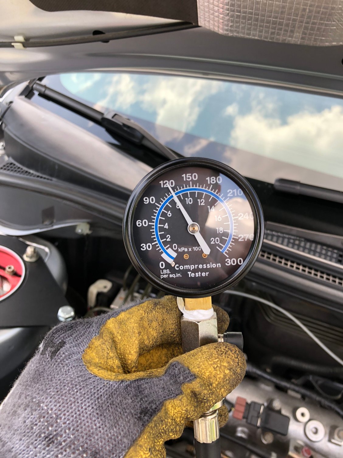

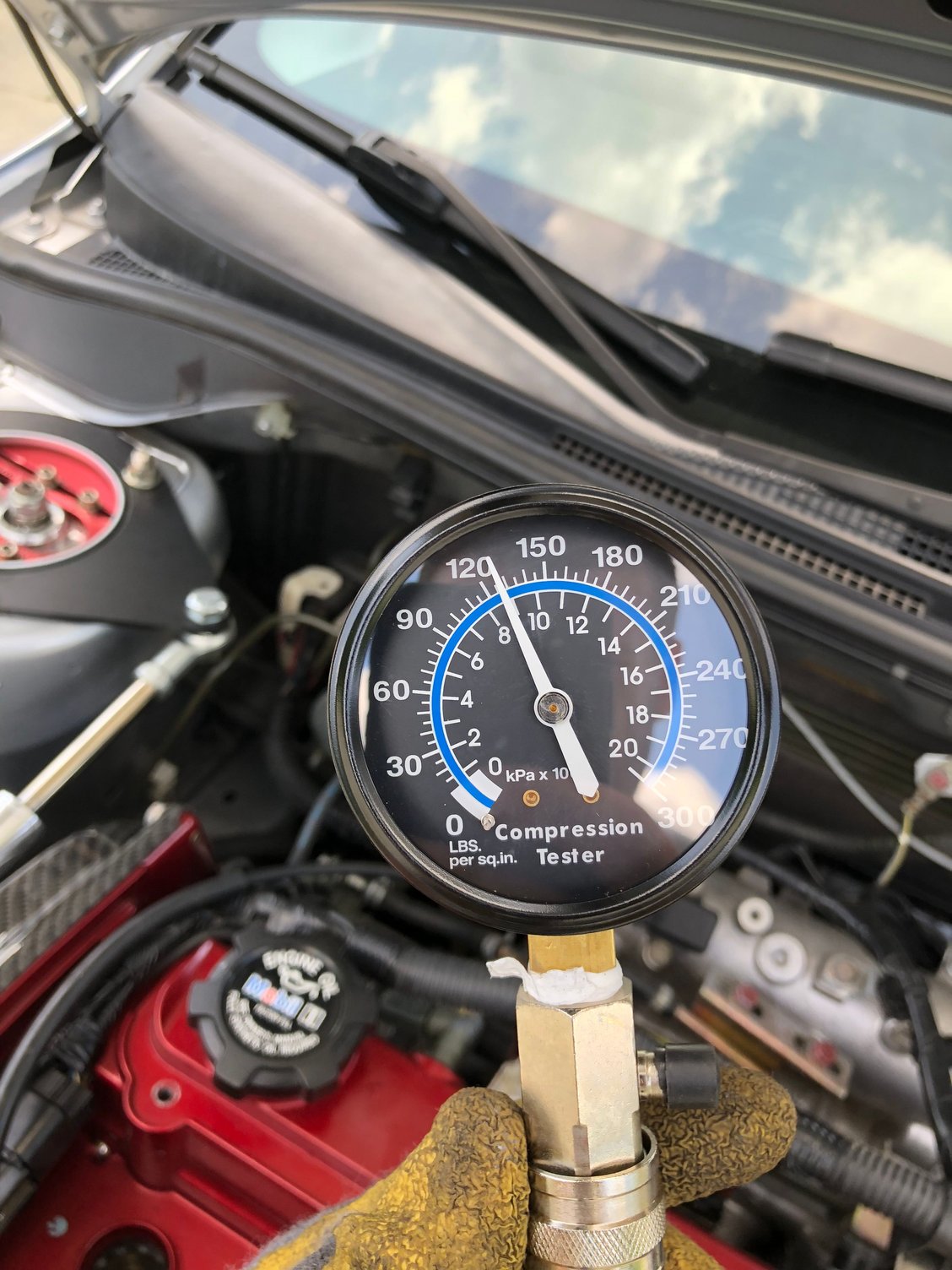

Okay here are comp test #s. Obviously low..
Old Jun 7, 2018 | 03:56 PM
Pal215's Avatar
Joined: Apr 2008
Posts: 2,925
Likes: 361
From: San Diego, CA
Those compression numbers are normal for a IX with aggressive cams. The pictures shows your oem pcv valve still in place which is good. I wonder if it's stuck closed.... How often do you top off oil?
