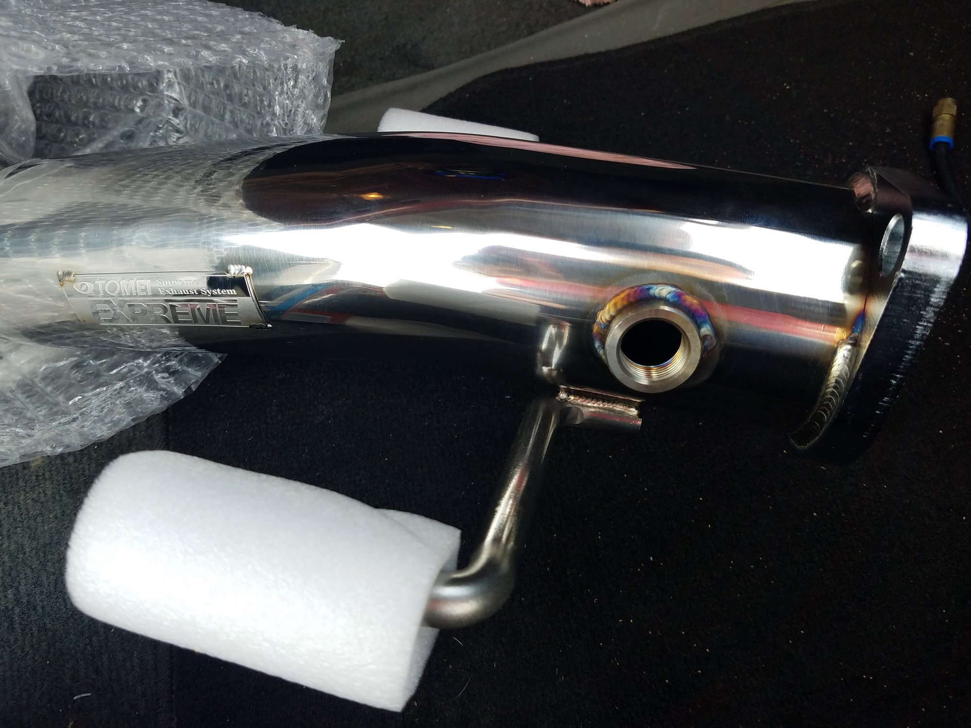

This is the downpipe, its already got a bung, so I would need to weld another one either for the 02 or the wideband correct?
doesn't your O2 housing have a bung for the upstream o2 sensor?
