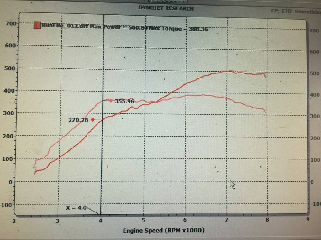

Yeah that's what I thought was weird considering I've seen some evo 9 turbos make more.. here my thread with all the mods and the graph. The shop before only got 350whp from the car with this setup which I thought was really weird.

Looking at your dyno results it seems like your fuel set up and/or wastegate might be whats holding you back. With 1000cc and e85 you might be running out of fuel so your tuner might have compensated for that. Or the wastegate isn't doing its job good enough. Also you didn't list an o2 dump or downpipe in your mods list, if you don't have them installed you are definitely leaving a lot of power on the table.

An aftermarket o2 housing will make a significant difference, thats part of why your dyno results are low.
