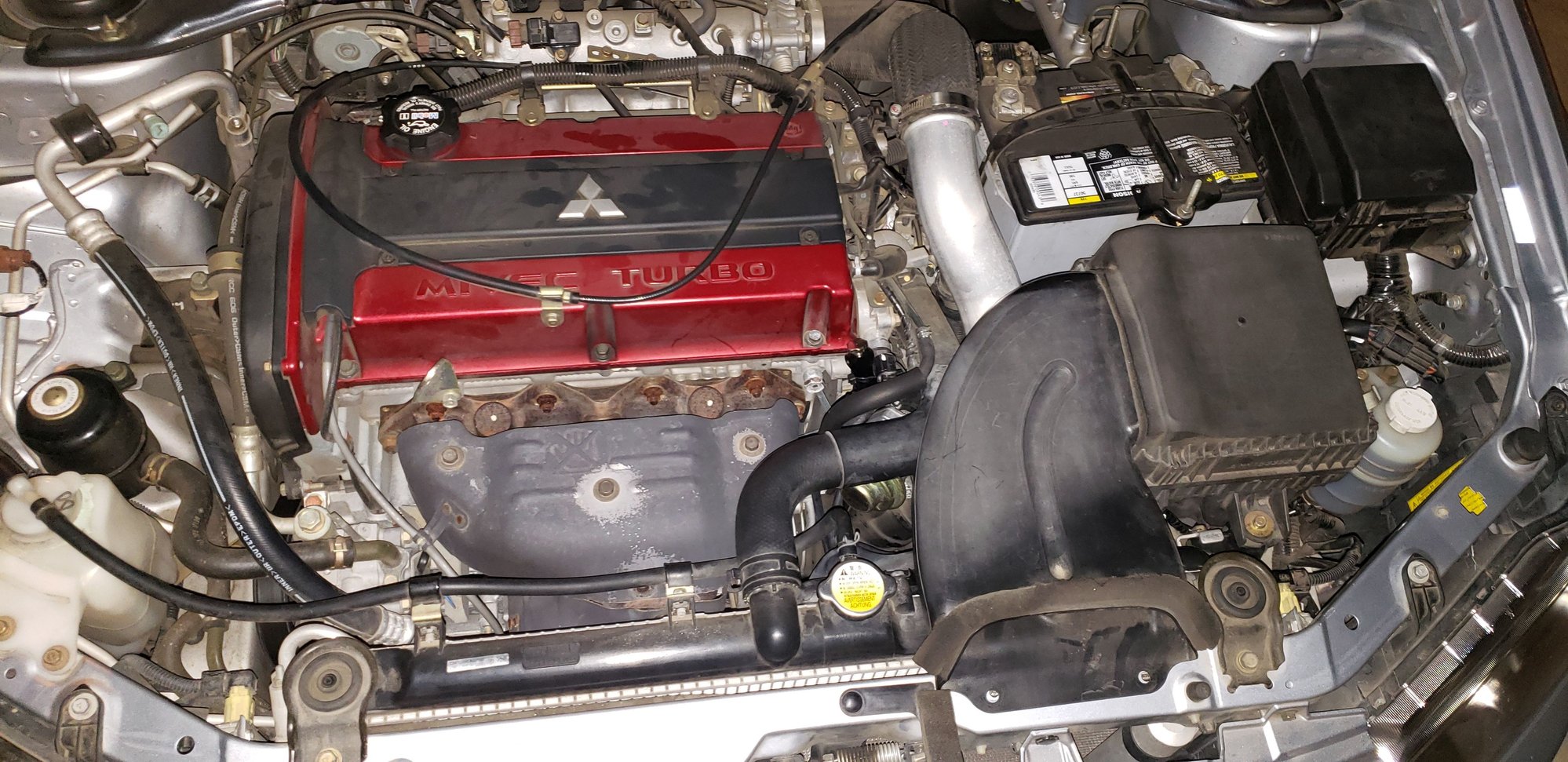

Will you take a picture of your engine bay? Just to see if anything looks out of place.

Ya I'll get a picture of the engine bay. The snorkel currently does not have those little plastic hold down clips in it. But when I had them in, it still did it. Air filter is fresh too. Had it installed while I had no issues with boost.

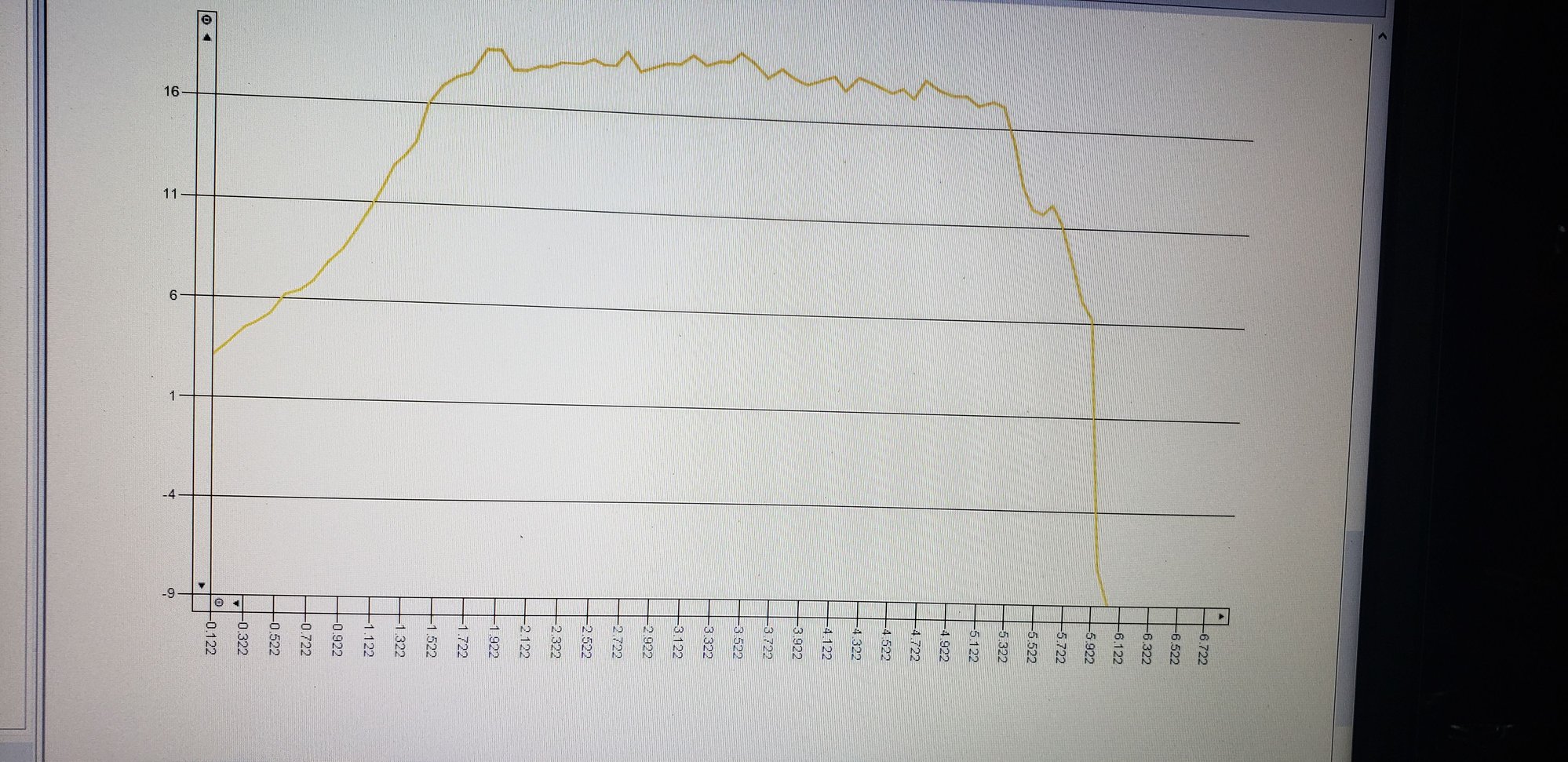

Here is a 3rd gear pull rolling into the throttle. Solid boost until 6000 rpm, then down to 6 psi. Top line is tps, middle is rpm and bottom is boost.
This proves that it can hold boost and should not be a boost leak. It's the magical 5500-6000 rpm where it drops, every, single, time....
Zoomed in on the boost area. Instant bye bye boost.

Oh yes, you can feel it. No question about that. You can see it on the mechanical boost gauge too. If I stay in it in 3rd gear to the point where boost is cut, I feel like it will never hit the rev limiter, even going downhill, with a tail wind. Feels like it gets cut to 25% throttle. You can also hear the boost getting bypassed when it happens. It honestly sounds like the BOV opens up.

The only thing I can come up with is there is some kind of restriction in the intake, but that doesn't get support from the higher gears holding boost ok. Something is bleeding off the boost.

Also, on my test drive tonight, I did some other tests i haven't done before. I held it at 5k in 2nd and mashed the throttle, instant low boost. Did the same at 6k with the same result. Tried it at 4k and right as it hits 5k, boost dump. Start it at 3k, still dumps at 5k. Still seems like its still rpm related. Also, when boost dumps, the afr stays in the 11s. Not a fuel cut issue.
