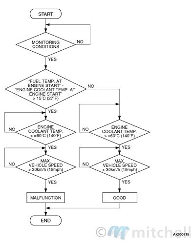

I just had this code pop up last night as well & this is what I found:
DESCRIPTIONS OF MONITOR METHODS
If the fuel tank temperature is found to be higher than the engine coolant temperature by a prescribed value, through a comparison
between the engine coolant temperature and the fuel tank temperature when the engine is started cold, a malfunction is determined
to have occurred.
MONITOR EXECUTION
Continuous
Check Conditions
The engine coolant temperature - intake air temperature is 5°C (9°F) or less when the engine is started.
The engine coolant temperature is between - 10°C (14°F) and 36°C (96.8°F) when the engine is started.
Engine coolant temperature is higher than 60°C (140°F).
Maximum vehicle speed is higher than 30 km/h (19 mph) after the starting sequence has been completed.
Judgement Criterion
The fuel tank temperature - engine coolant temperature is 15° C (27° F) or more when the engine is started.
I've also attached the complete article just in case you really want to dive in head first..

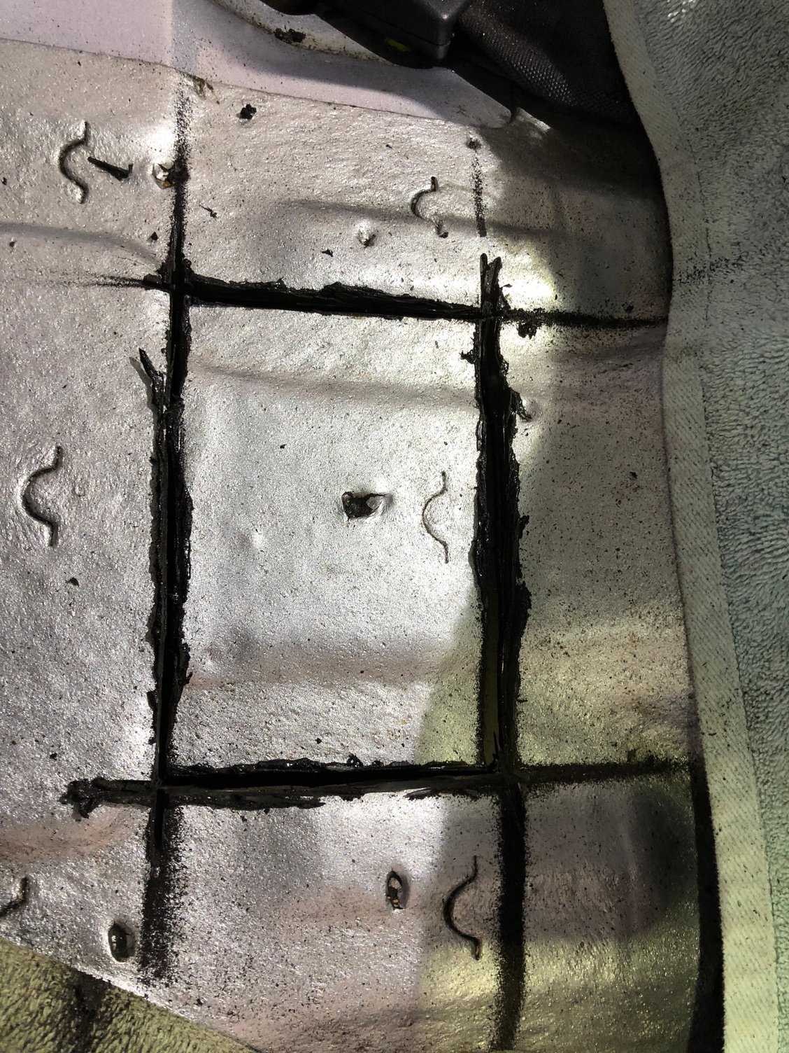

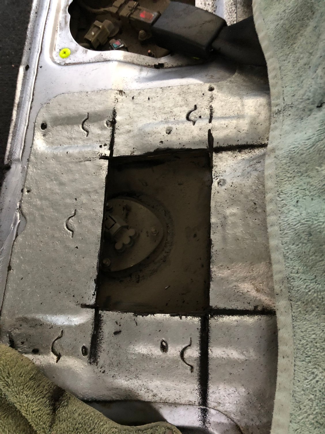

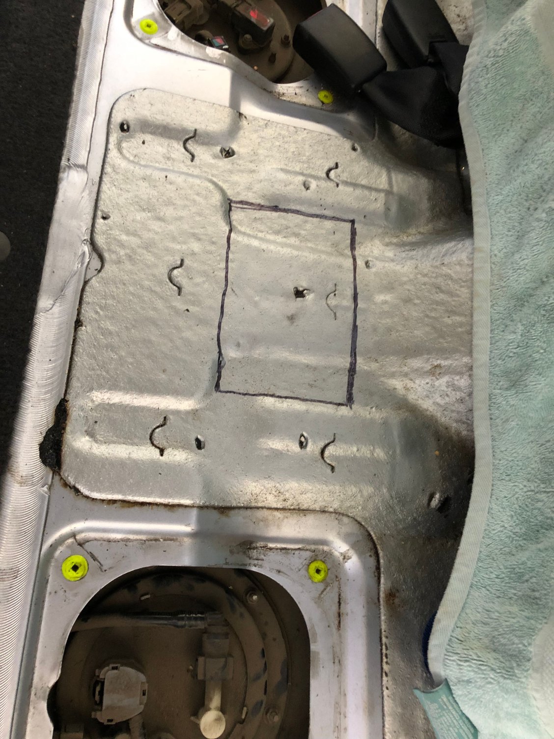

Tackle temp sensor from up top
So I decided to tackle the temp sensor from up top, since disassembling everything underneath would be very time consuming and have a number of more things giving headaches. I made a fairly good approximation for where to cut. I used both a rotary tool and angle grinder with cutoff wheel. Please use caution with sparks and take your time. I would cut a bit and check frequently for clearance.
I can reach the harness and all nuts but it’s somewhat tight. If I were to do it all over again, I’d shift that rectangle about an inch toward the front of the car. You can patch it up any way you want.

Awesome, I don't understand why mitsu didn't make an access. The other two are there, whats one more. You saved several hours for sure.

Took about an hour, carefully cutting. Melted sound deadening gummed up cutting discs that added time.
