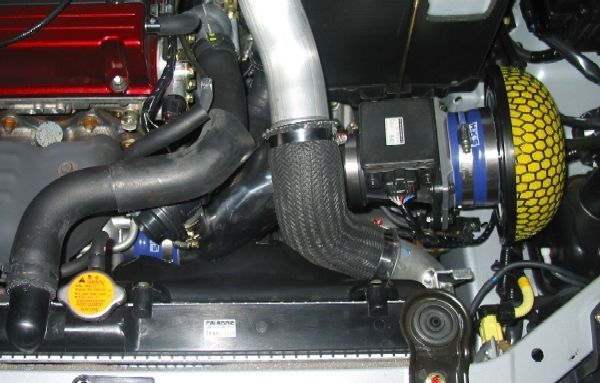

Hi Guys,
I just installed my HKS Racing Suction Intake today. Took a total of two hours to do since I have to remove the stock intake flex tubing from the turbo inlet. Removing the end that connects to the turbo was a beeatch to do because somehow, the clamp screw was underneath the tubing... I cut my hand about 3 times on the fan shroud trying to unscrew the clamp...YIKES! Someone must have had really small hands or was just trying to be mean by leaving the screw underneath the tubing. I couldn't even get to it from underneath and had to perform some cirque du soleil twisting with both my hands just to get to it!
Anyway, it was all worth it. I reset the ECU and everything seems fine so far. The butt-o-meter can't determine whether there is HP improvement yet...BUT the sound difference is incredible! With the window rolled down, I can hear the intake sucking in air at 3K RPM's and the stock BOV recirculating with a loud Pssshhhhhh! If one is planning to change the BOV for sound...do the intake first - it will be pretty loud already...I plan to do an aftermarket recirc BOV when I will be going with higher boost and an e-BC and tuned ECU anyway, but the sound of the stock BOV is already pretty impressive!
Attached is a pic...
BTW Some of the stock plastic parts for the intake are pretty cheap and fragile...that's fine because all the cost went into the good stuff!
The HKS materials were high quality stuff!

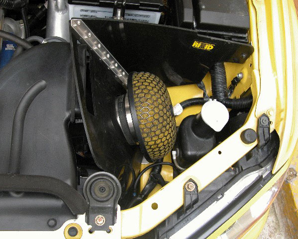

You may want to create a heat shield and refit the intake duct....
The aerodynamics as far as the inlet is concerned, are designed around that scoop... don't get rid of it.
also if you live in a dusty area ... monitor the HKS's filtration .. Its one of the poorest filtering solutions available!
