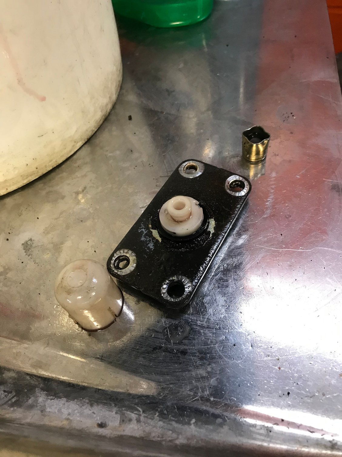

i have atf oil coming out off the breather anyone can help me out ??? Trying to bleed the cda ??

usually this is due to broken diaphragm in the central diff.. unfortunately it is not a part that can be bought by itself..

just to clear the issue up a bit.. the clutch pack is pressurised by a piston driven by red hydraulic oil.. the piston has 2 O rings and while those are not availabe from mitsubishi, they might be sourced elsewhere..
