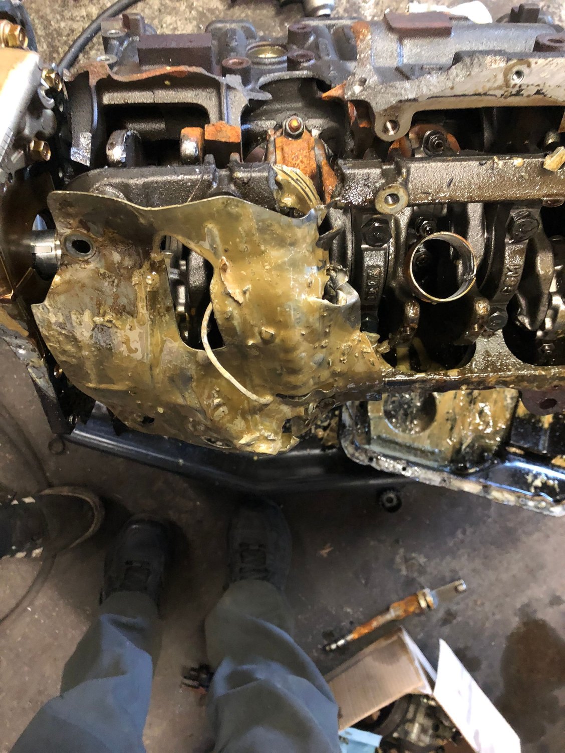

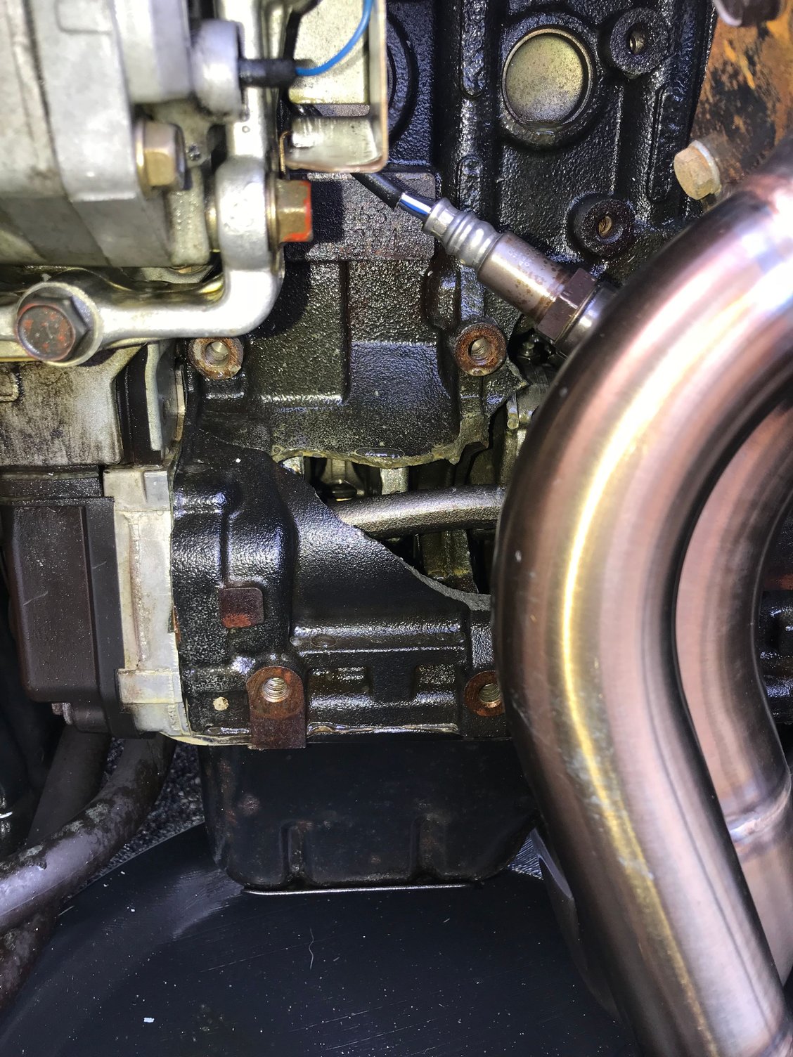

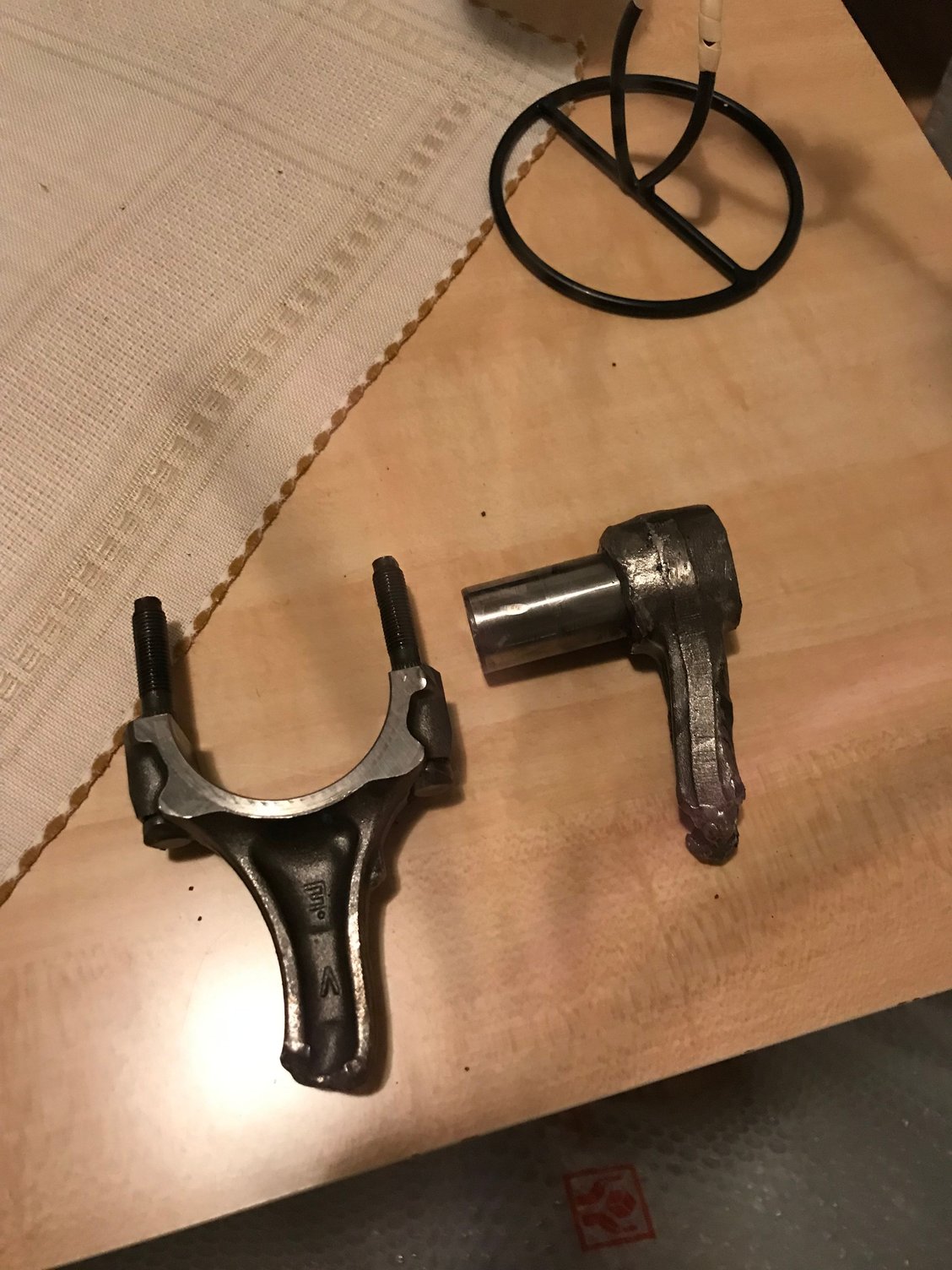

Hello everyone I bought my evo 9 in Sept of 2017. It was stock with a cat back 44k miles. From nov - feb the car was off the road because I was in the process of putting bolt ons on the car. Feb 13 car was tuned Feb 14 motor detonated on the highway. Coming to realize the car spiked to 35lbs on the dyno could have bent the rod but wasn't fully on its way out who knows.. Later that night after my tune car sat for an hour or so and when I went to drive it the car started breaking up.. brought it back the next day (the 14th) one of the plugs electrodes tips broke.. (another sign) He put in new plugs gapped them to .022 then went out and adjusted the tune and sent me on my way and 7 min later this occurred going into my first pull with the new plugs. 3rd gear 3800rpm it detonated right as it spooled. Car made 404hp/369tq on a dynojet.

Is that cylinder #2 that failed?

look at that balance shaft, that thing literally grenaded. There is an epic engine failure thread you should x-post this into.
Yessir half the rod hanging there upside down

Strange how it was cylinder 2 that failed. 1 and 2 gets the least amount of air from inrake manifold, so it's strange that it ran leanest. Maybe injector 2 was getting clogged? Or they all went lean and 2 failed first?
I had the map read by a friend of mine I was told my "injector scalings were off and my boost duty cycle was really bad".
Old Mar 14, 2018 | 10:43 AM
2006EvoIXer's Avatar
Joined: Jul 2012
Posts: 3,294
Likes: 197
From: California
If scaling was bigger than actual injector size, you ran every cylinder lean. Check your head for any melted aluminum in the dome. Are all your spark plugs intact?
