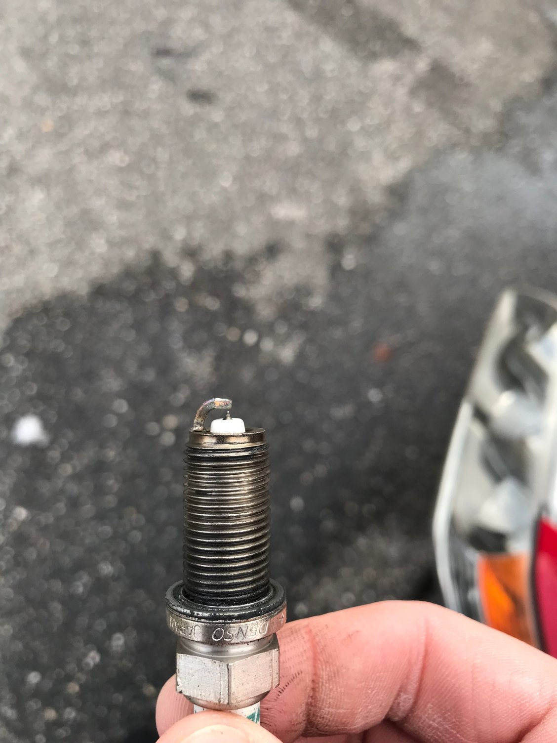

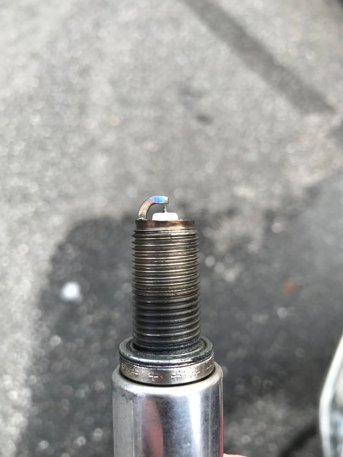

Just got the plugs out here is 1-4 in order and the old plug that went bad which was cylinder 2 which is also the cylinder that detonated.. As far as I can see there is no piston in cylinder 2 either might be in my oil pan or somewhere else. The little porcelain piece under the tip on the new plug is also cracked in half.

That electrode being eaten up, and the surrounding areas of the plug shows pre-detonation.
The other 3 plugs surrounding areas looked similar as well
