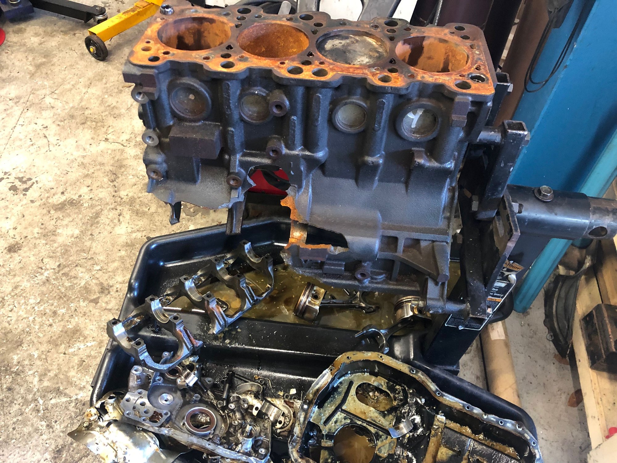

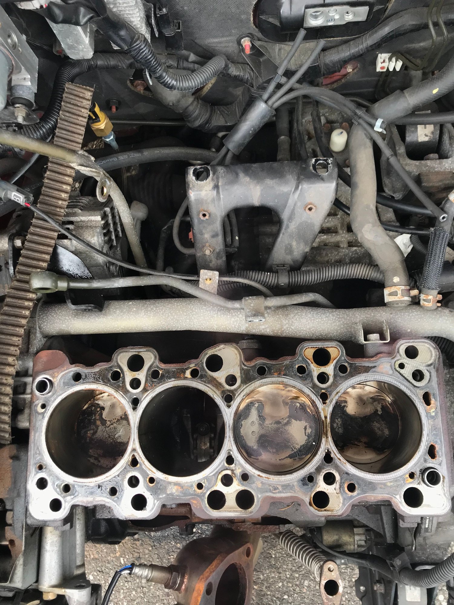

Dec 26 Cyl 2 piston MIA half of the rod is still bolted onto the crank
New Heart

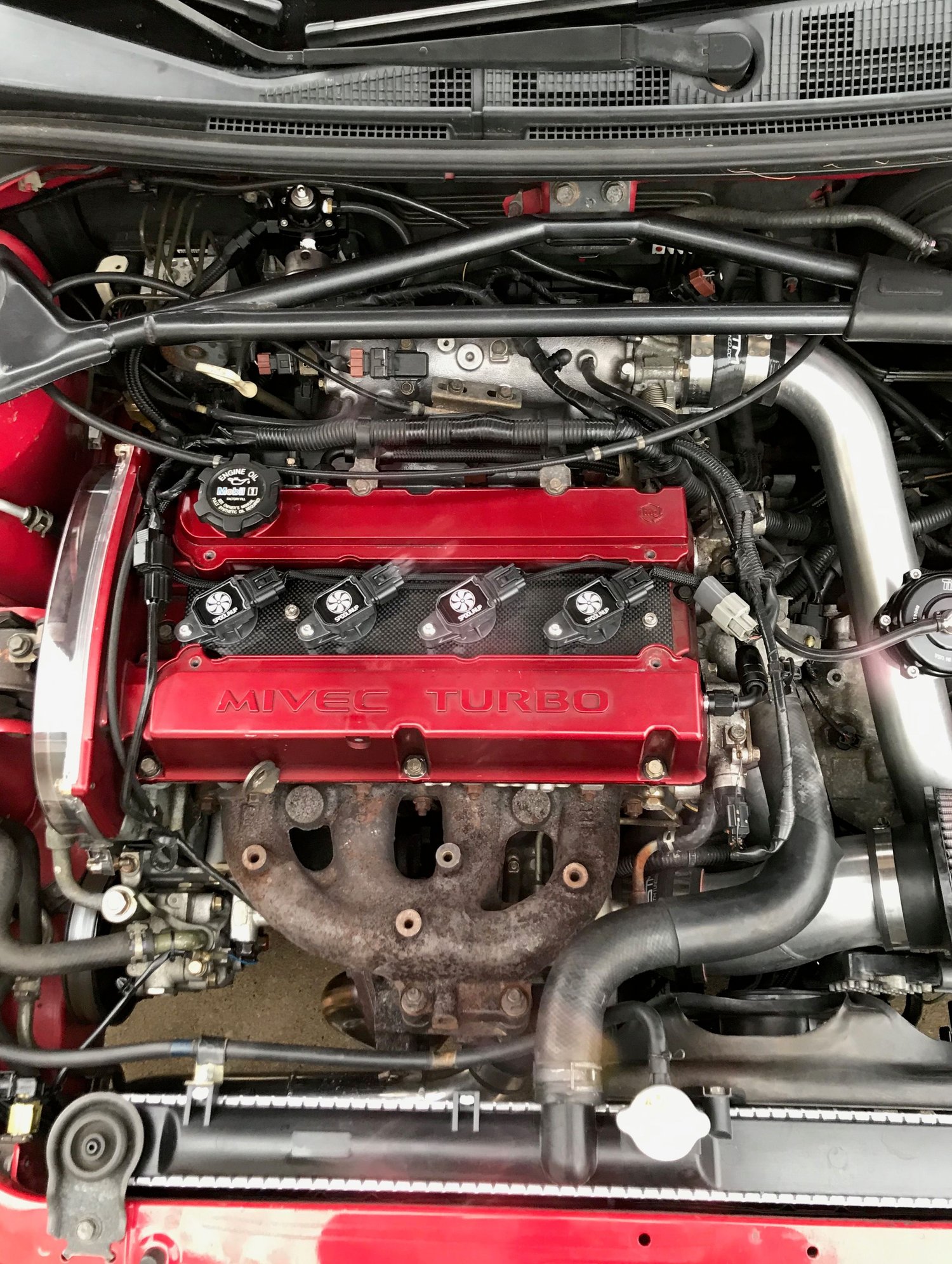

I bought this JDM rear bumper and this exhaust 2 years ago and finally got to put it on lol. Also put on my Spoolin Up COP, Zaklee Clear Timing Cover and took off the spoiler. I'm covering the holes with red label circles

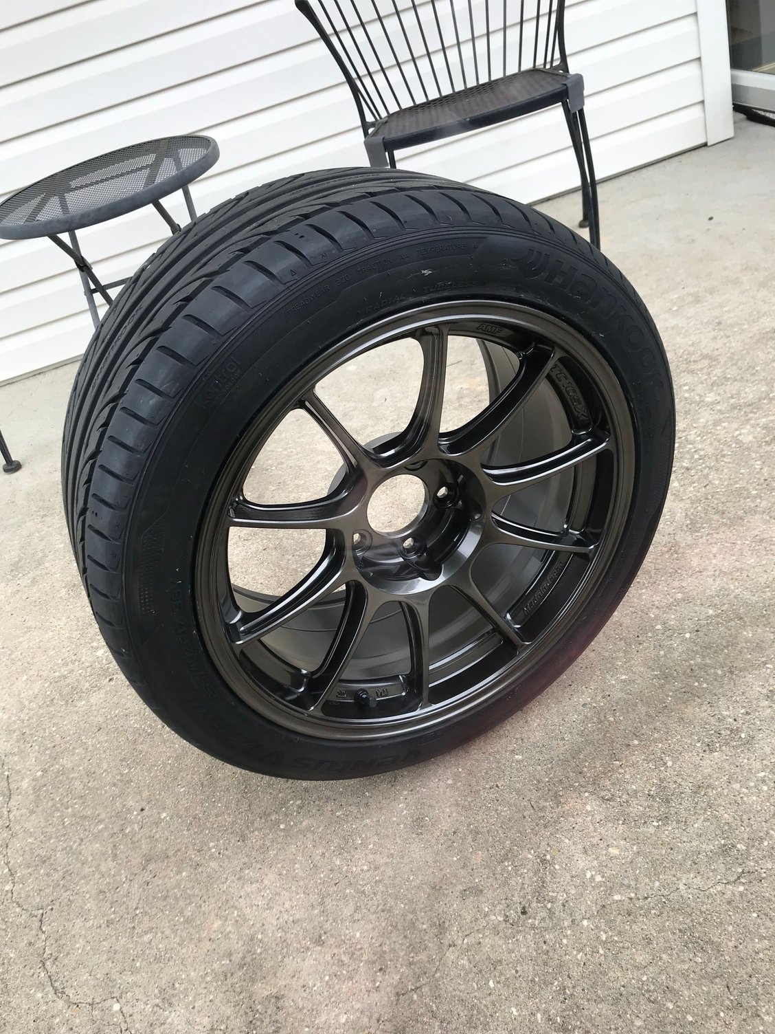

Got her straightened up and now she feels great. These are 255/40 17x9.5 no fender rolling or cutting never rubs.

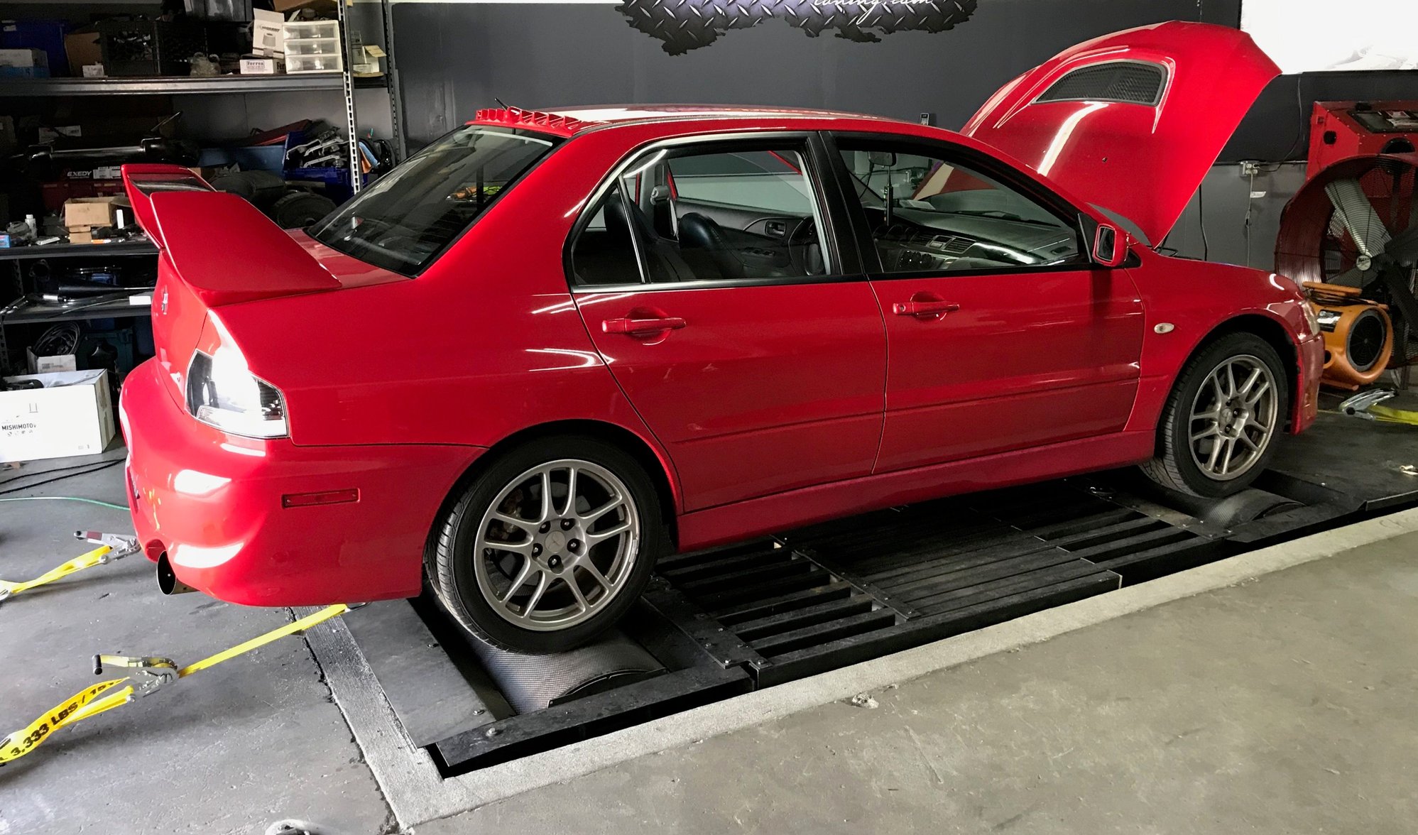

Hello everyone back for an update. I finally got my car done for now. Made around 700hp 500tq on mustang dyno ~40psi. Pics below.

Sorry to hear of your motor failure, but my question is who tuned it? I don't see any reason with the low mileage you have at that power level on E85 that could destroy the motor. Whoever tuned your car obviously didn't tune it properly.
Old Oct 22, 2018 | 07:57 AM
Big_Mike1's Avatar
Joined: Mar 2009
Posts: 81
Likes: 8
From: NYC
It was a local tuner here and unfortunately I do not have the map the car was on when it pre detonated as he took it off the day it detonated. Live and you learn is the only thing I got out of this whole situation

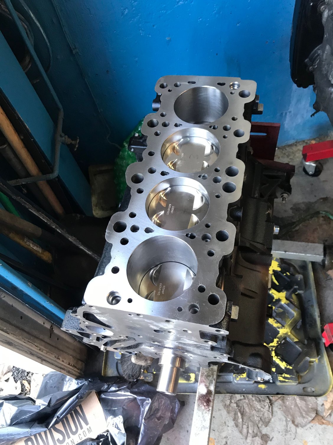

Do you have a trustworthy machine shop to install your head components and do your block machining and assembly?
Old Oct 22, 2018 | 08:03 AM
Big_Mike1's Avatar
Joined: Mar 2009
Posts: 81
Likes: 8
From: NYC
Raif up at RRT currently has all of my engine components and is going to build the motor and tune the car.
He installed my exedy twin and went over the tranny for me in the beginning.

I hope you got upgraded wrist pins. I don't see oem oil squirters and check valve bolts. You could have cleaned and reused your oil oil pan/pickup/baffle.
Are you going to upgrade to fluidampr & English Racing oil sprocket?
Old Oct 22, 2018 | 08:32 AM
Big_Mike1's Avatar
Joined: Mar 2009
Posts: 81
Likes: 8
From: NYC
The pistons, rods, and cams haven't been ordered yet was waiting to hear back from Raif, he was going to measure the cylinder bores and take it from there. My old pan baffle is destroyed lol looks like the rod or piston slammed into it and plus rather play it safe than sorry. I didn't order new oil squirters or check valve bolts. As for the the fluidampr and ER oil sprocket I would have to speak with Raif to see what his opinion is and if he likes using those in his builds. I haven't heard any bad things about either and wanted to upgrade to the fluidampr.

My guess is he'll tell you to go with long rod setup. 156mm rods.

Should not dona long rod setup. The r/s ratio of good. The Wiseco HD pistons come with HD wrist pins, they don't need upgraded.
Hopefully your turbo kit is twin scroll. It'll help it a spool a lot faster and make more torque.

I just looked at a Raif build and it's a normal 2.0. Bmurry is making some serious power out of it. I was confusing Raif with a Buschur built 2.0LR. If it doesn't already come with it, take a look at DLC option for wrist pin

Nah we spoke about it I'm staying standard rod. Aluminum LR later in the future lol.
