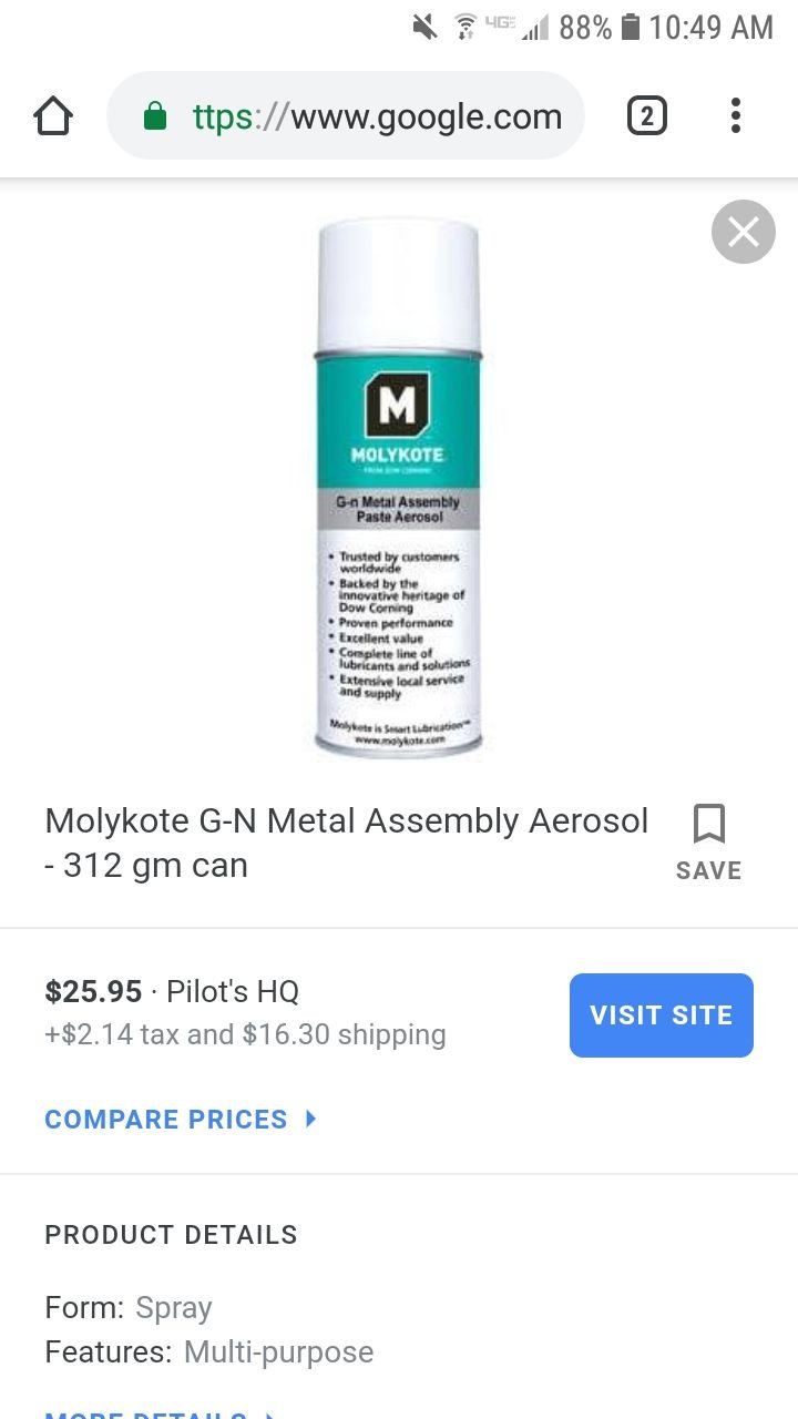

It's at most 1.2% open which I was told we could compensate with the tps adjustment
It's the extra airflow that's coming through that's causing the idle being at 2k
Gonna remove the whole thing this weekend and put the moly on there too
Crossing fingers 🙏🙏🙏🙏🙏

https://www.evolutionm.net/forums/ev...AfB3HZGqvXpj5c
This is where i got the idea
I figured the 1.2% (at most) throttle being open is gonna be covered by this stuff and i can zero out via tps adjustment
