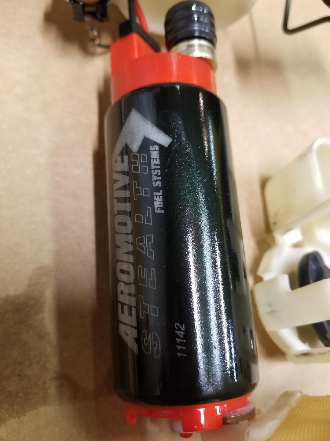

Took it to a shop and a few parts have been pulled. Got a act clutch that will go in soon. Check out this pump, do you think this will work with the setup? I decided to upgrade the car more by changing the injectors and turbo.
