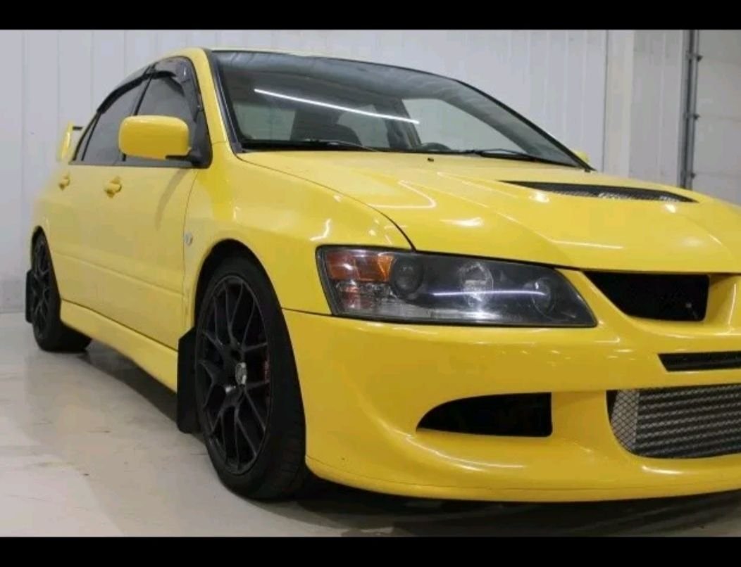

first time owner of an evo. Bought it a month ago, has 35k miles and super clean. Guy I bought it from did some crazy mods and it flies (will spin all four wheels), couple issues though maybe you guys can point me to a thread or let me know what I can do. Just a quick background, I bought this evo super clean with low miles as a nostalgic car that I loved when I was a teen. I bought it from a dealer out of state and everything seemed cool (though still is), I do not intend to tap this car or track it or launch it, it will be garage kept and taken out once in a while (pick up my kids from school and make the teachers mad haha).
1. Clutch is so difficult to drive. Extremely difficult. It's either on or off, though i do not want to go with a completely stock clutch because my friend told me i have too much power for a stock clutch even if i drive "normally "(well i do like a little throttle) what clutch would you guys recommend that would satisfy my daily driving and the power output?
2. When the car arrived I drove it around and it had over half tank of fuel, I filled up with e85 and it runs much smoother however when the car is cold it's an extremely rough idle but when warms up it's great, is this a concern? Should I stick to the e85 or go with pump gas?
3. The spark plugs I unscrewed and they seem to be very dirty and look like cheapos, any recommendations on plugs for my setup?
it has the current mods....
evo 9turbo and manifold.
skunk throttle
850cc injectors
haltech standalone ecu
8 leg triple disc ceramic clutch
Full exhaust 3"
head studs
stealth performance fuel pump
full intake with cold air
skunk throttle
850cc injectors
Full exhaust 3"
head studs
