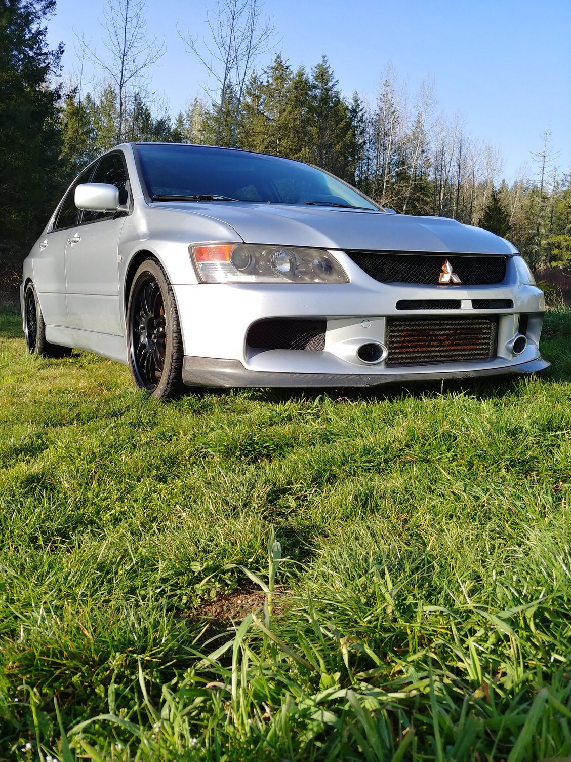

I'm aware of the block plate. It is a 4g63 block. I was wondering if someone knew of a shop that stamped the blocks they built. It's an out of state car. I have tried to find info or the previous owner but to no avail. It's a built long block, gsc s2 cams, og fp green, ams intercooler, fujita charge piping, 1650cc rc injectors, wally 255, agency power fuel rail, egr delete, 2.4 block to head oil line, oil cooler, demon racing cop, innovate gauges, is robi spec coilovers, and volk re30s. Apexsilver from California.
