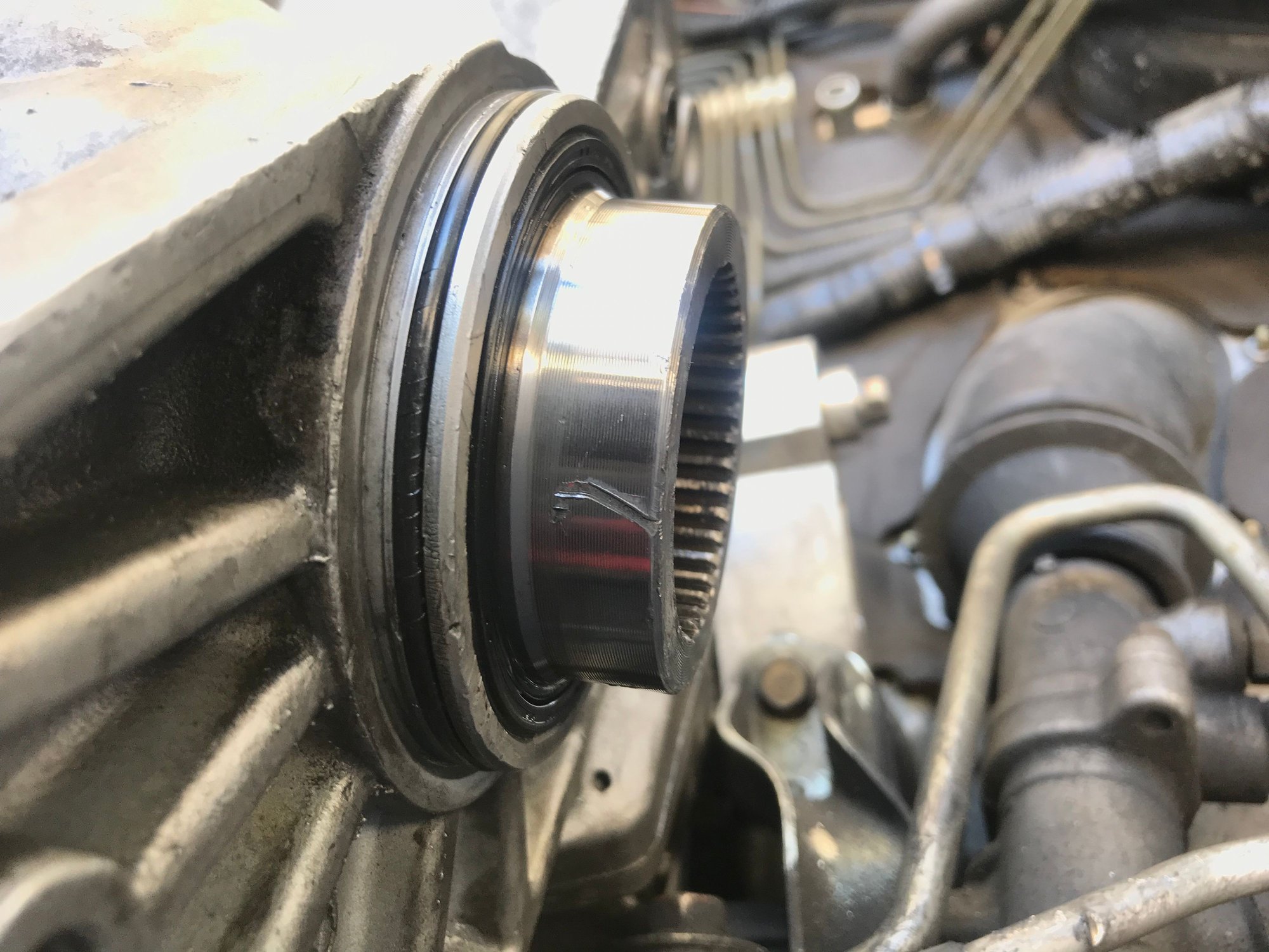

Transfer Case Outer Shaft Scratch?
Tried lowering the engine in the car about a couple weeks ago and decided to wait for the head to be ported.
saw this just now and wondering if it will be fine before I install the motor

yeah, just fine...

Scratches like that are fairly common. If it is recessed you don't have to do anything and you will be fine. If it is raised, I would carefully file it down smooth with either a dremel sanding bit or a file so that it is flush with the rest of the shaft. I don't believe that surface would score a seal and cause it to leak.

The o-ring behind it is chowdered.
