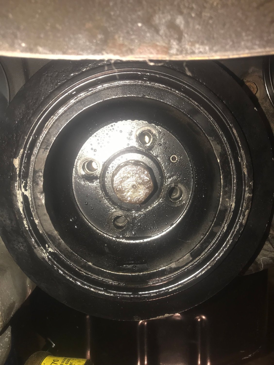

Alright, im about to follow your advice. But I can’t manage to get the crank pulley off. Seems it’s stuck on the crank even tho I’ve removed the 4 bolts. Do I have to remove the big center bolt as well? Any ideas?

Yes that will also need to be removed to get the Harmonic Balancer off. If you have access to air tools or electric impact i would start there. I have an 1/2 Milwaukee impact that I usually use to remove it.

he doesnt have to remove the centre bolt toa take the harmonic balancer off... Just take the cambelt off and spin the pump with the dril... Then take care to reinstall the cambelt with the pump and front ballance shaft timed the right way.
