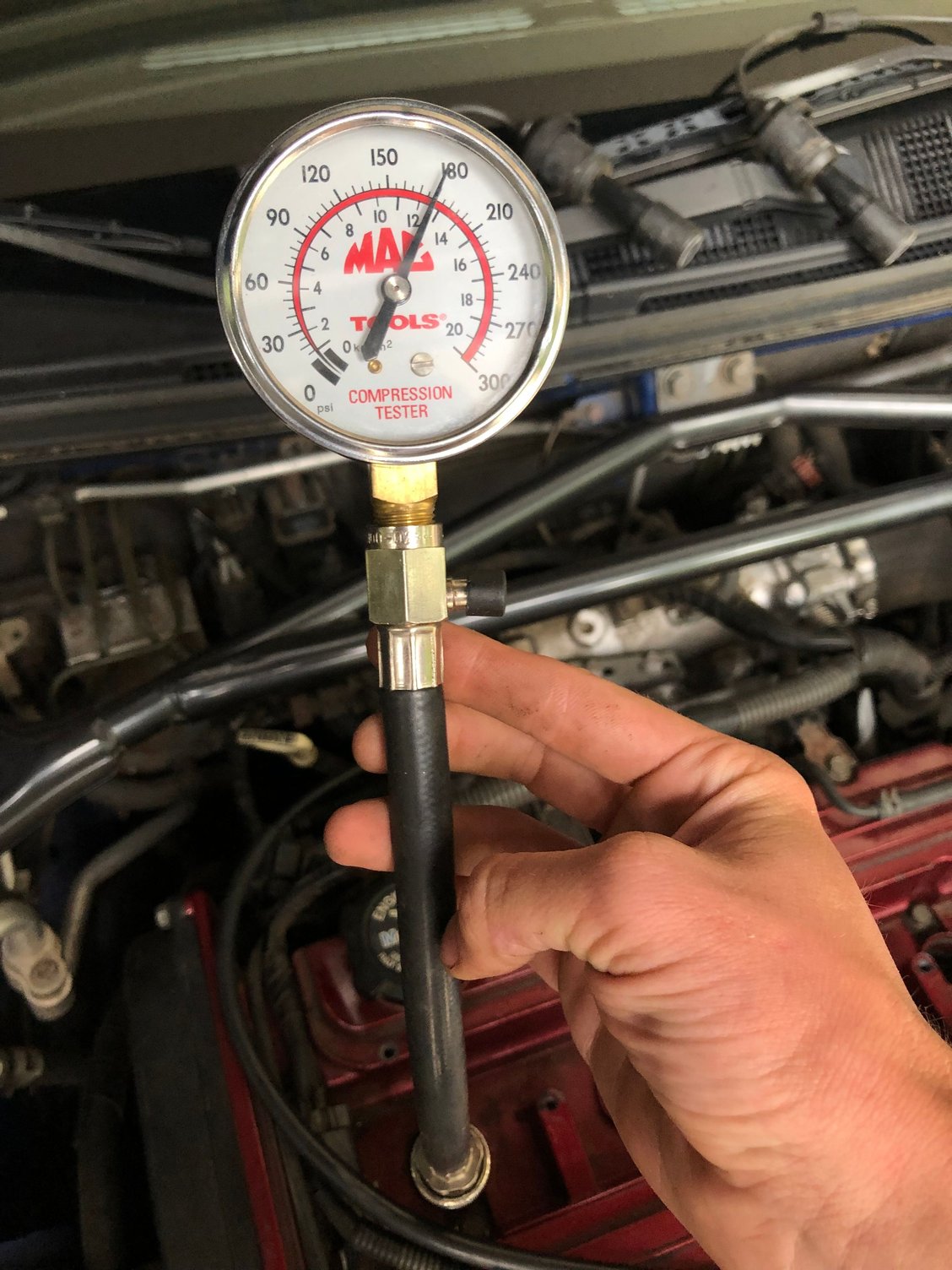

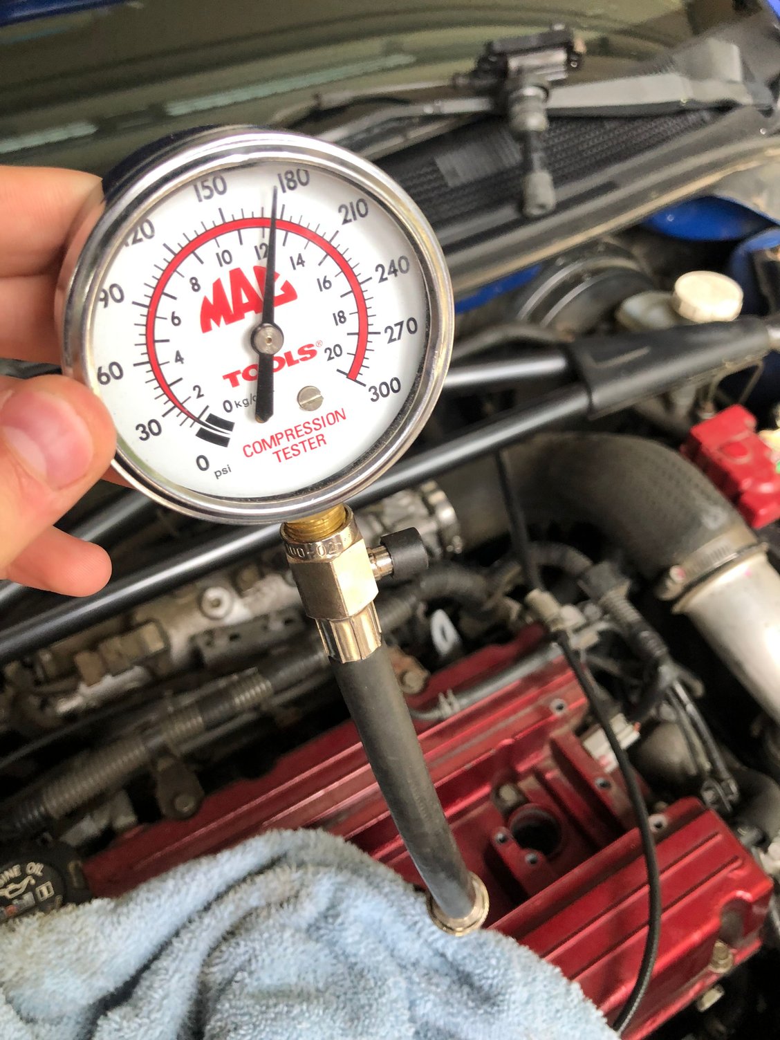

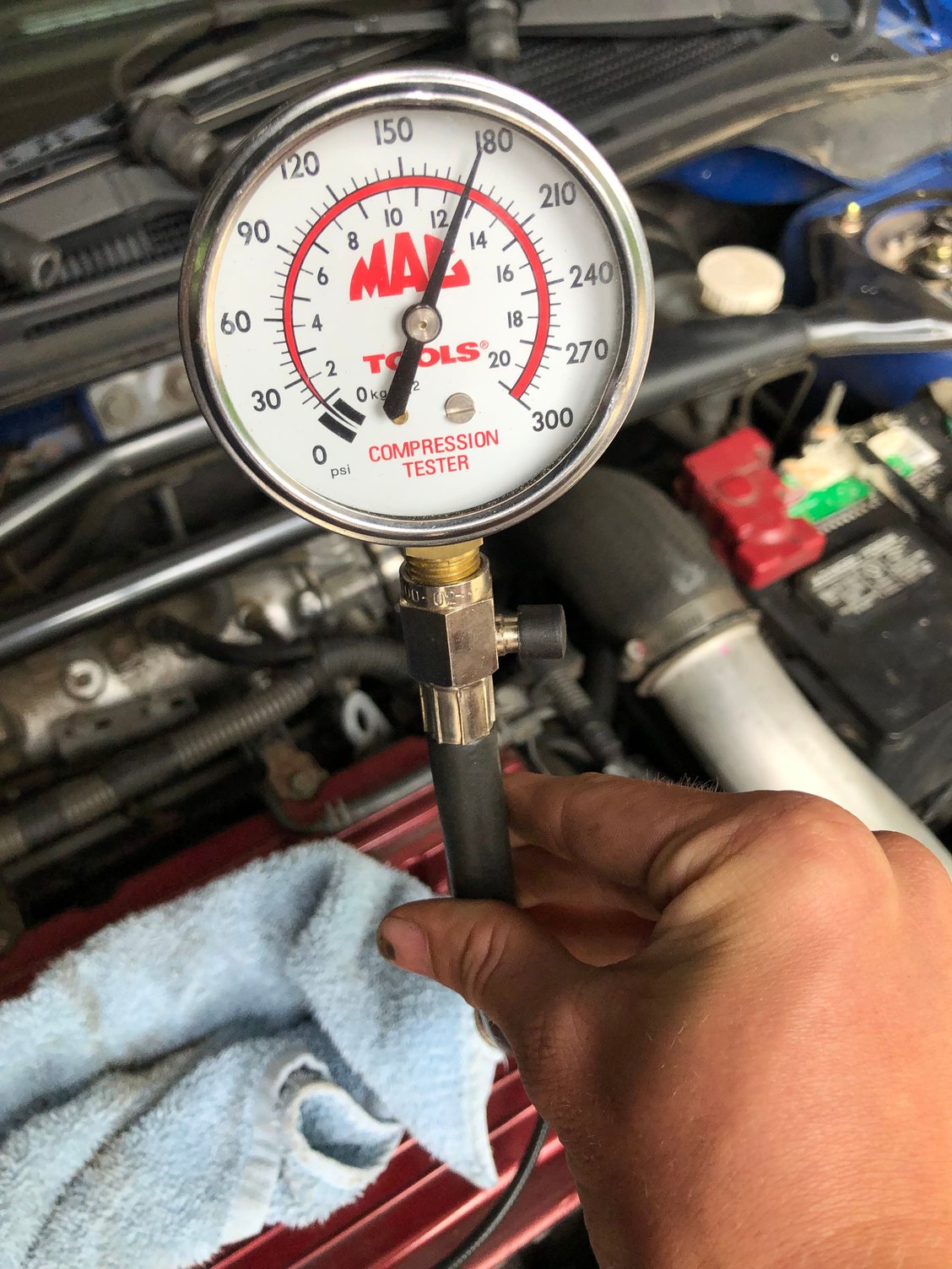

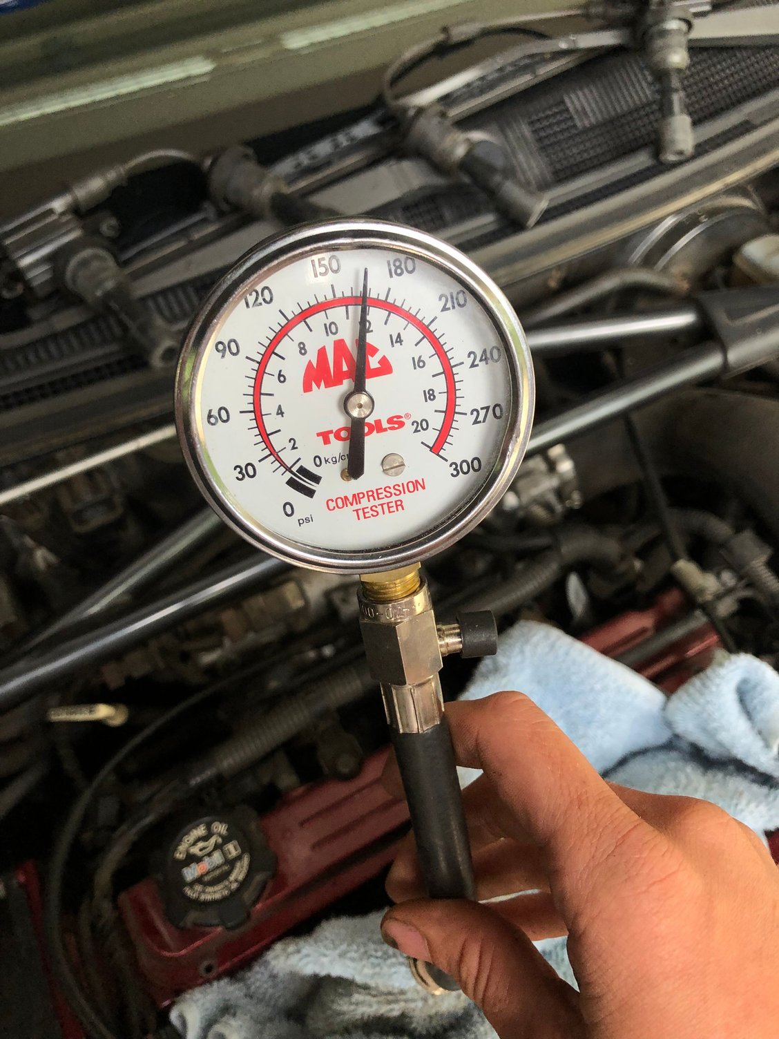

jusy did a compression test and this is what I got, car is bone stock motor wise if I haven’t already said it

I don't konw why you did a compression test as it aint gunna tell you anything. And stop turning the motor over your're just causing more damage. Did you run the car low on oil by chance? It definitely sounds like rod knock. Drain your oil and cut open your oil filter.

Not sure why you're checking compression, that won't identify a knock.
