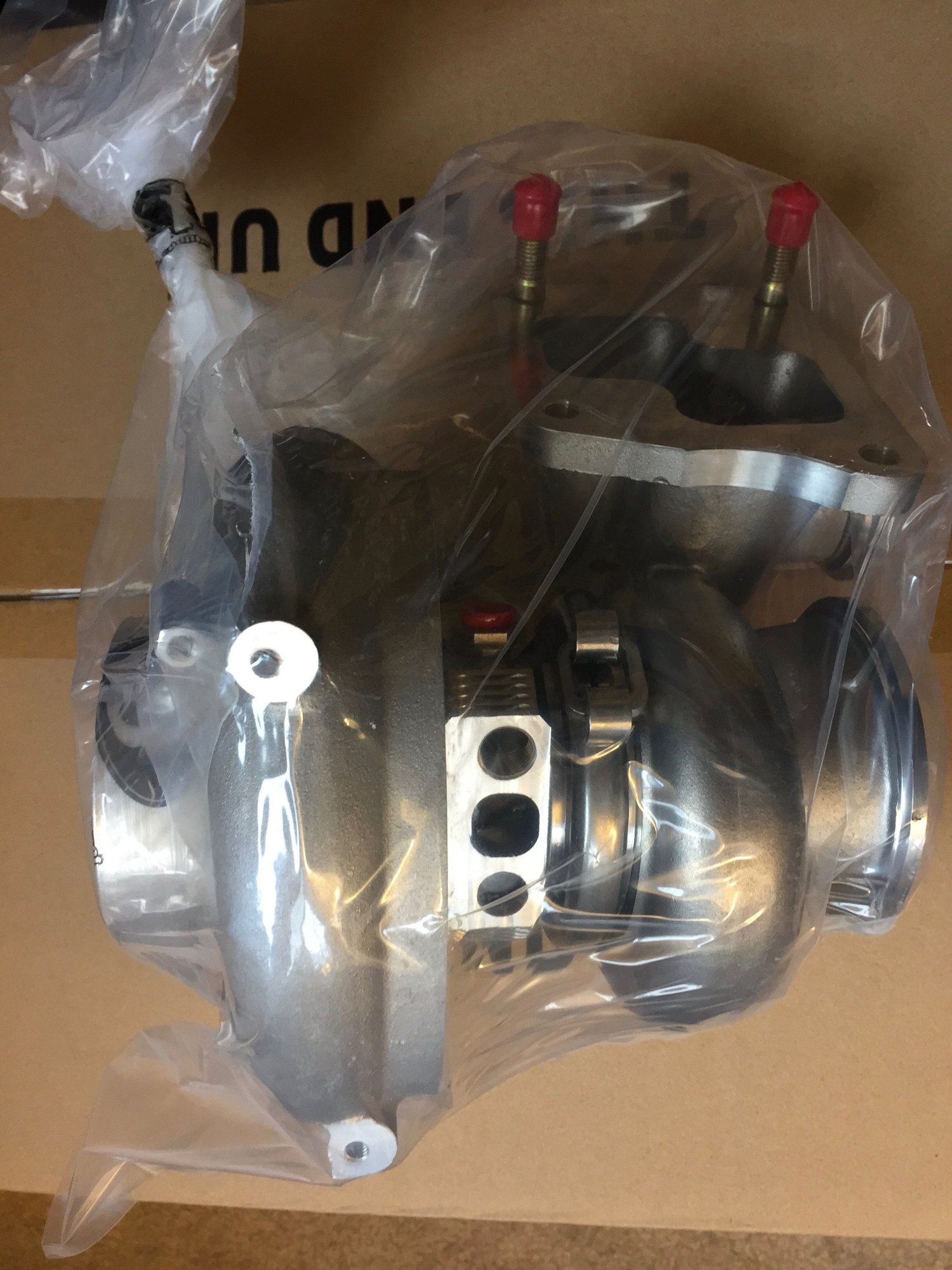

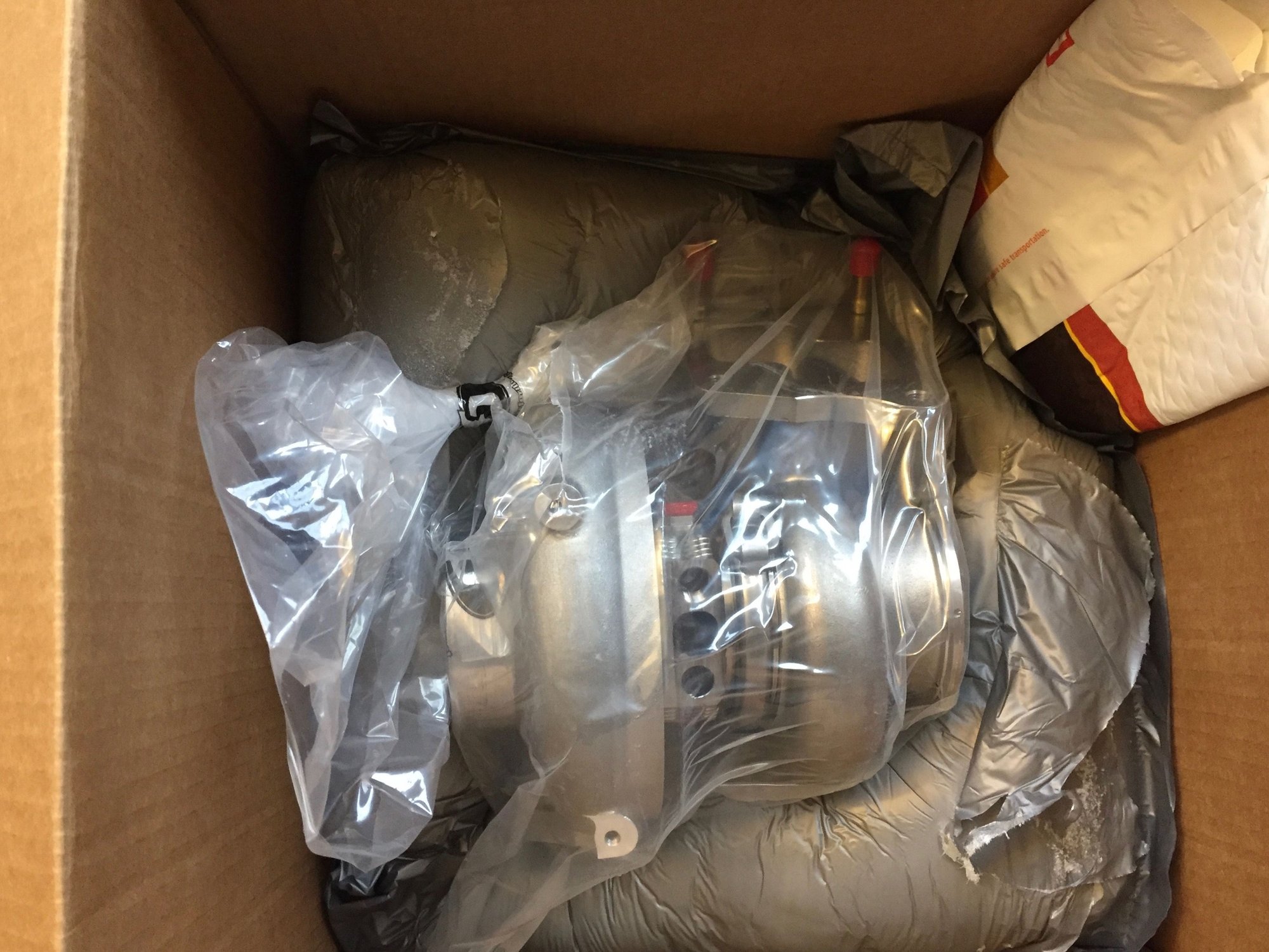

Nowhere in the link you posted does it say anything about the UHF turbine or the SS housing for the FP54 green..
It even says they're ONLY available with the MHI housing..

Like I said, this is the new DBB Green 54 with the UHF turbine wheel and the externally gated SS housing... It will be installed and dyno'ed in the next week or two, depending on the timing of winter like weather here...

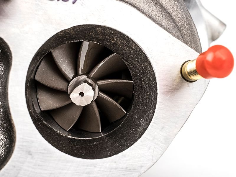

My understanding is 54mm is a 9 blade turbine wheel. The UHF is a 5 tall and 5 short blade 57mm turbine wheel. Please post a picture of hotside wheel. Thanks.
It is one of these (54 is top and UHF is bottom):

What he has the new UHF green. FP doesn't make FP54 with the SS housing.
The UHF wheel they use on that turbo is sized almost perfectly between the FP54 and a standard green. The splitter blade design helps to reduce weight to aid spool while also helping cut down back pressure. In other words, it should spool better than a standard green while also having better top end.

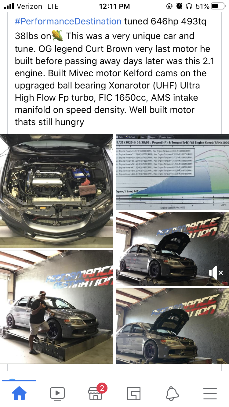

Here's another data point for the UHF green. 646whp @38psi on a 2.1L mivec engine. Still waiting for them to show a boost curve.

Really need to compare results on a dynojet.
IIRC, that particular Dyno has 450whp stock block/turbo results where most dynojets are at 400whp.

This is my car, if anyone has questions let me know. The car was really dyno tuned since everything was changed at that the same time.
I was not to looking for a particular number but I am very happy with the drivability and the power it has been making.
Desmond at Performance Destination took his time to squeeze the most out of this setup on pump e85.
