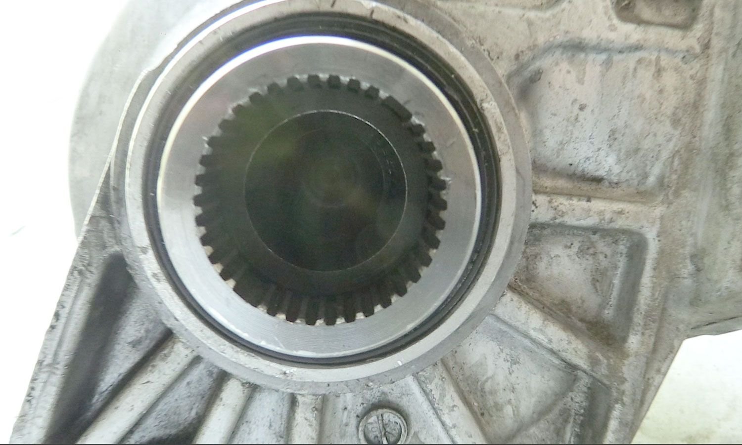

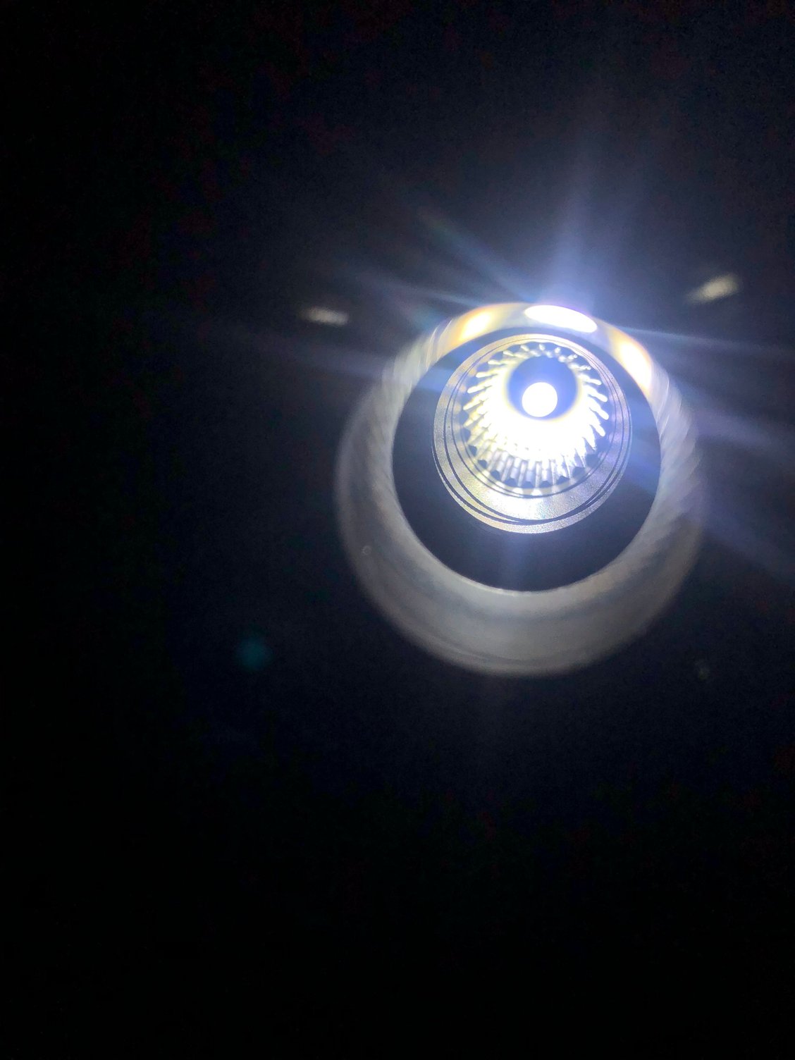

If you have the tranfercase out of the car, look inside the whole that the intermediate shaft goes it...
1)If you see a pin link the first image below(pic1), its an open diff. Correct?
2) but if you don't see the pin(pic2), is it safe to assume it has an lsd?

This is my understanding as well, #1 is open diff. And no bar with LSD. I believe the RS came with LSD but I'm not if RS was offered in 2003/2004.
2) (sorry for the poor photo) but if you don't see the pin(pic2), is it safe to assume it has an lsd?
pic 1
pic 2
Non-acd RS was only available in 04. So there are only like 260 out there from the factory.

Thanks. The photo i used to show the lsd looking non-acd case is my used T-case i bought that they seller said was from an 03. But i'm pretty sure its on 04 RS, or an aftermarket lsd in an 03 case.
I'm 99% sure you would see the pin/bar going across if a evo 8/9 transfercase had an open diff. Just surprised no one else really seems to want to confirm my thought.

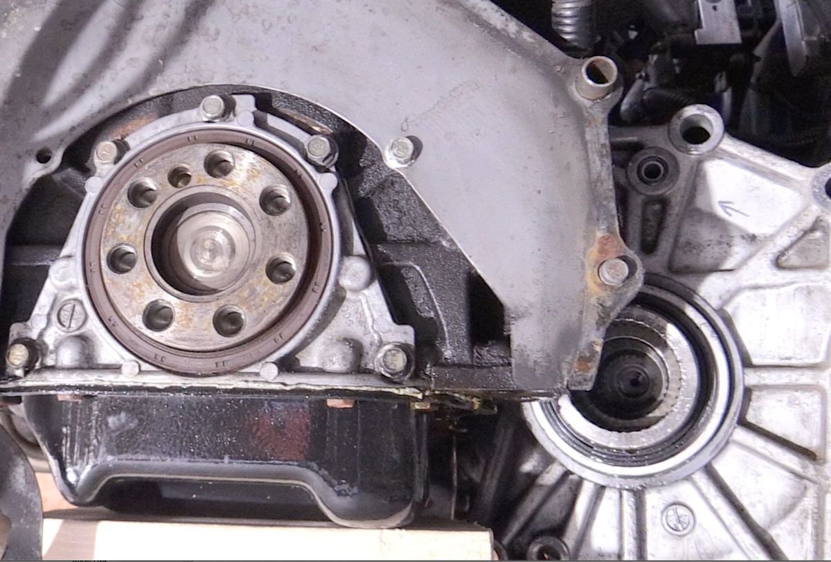

Meant to do this weeks ago, but fwiw here is the inside of my RS tcase. No pin thing, what’s the purpose of it anyway?

so you have the torsen diff.... the ones with the pin have plain open diff in the front...
