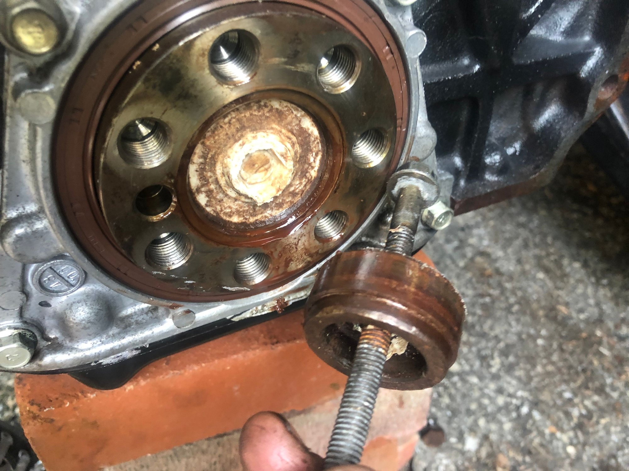

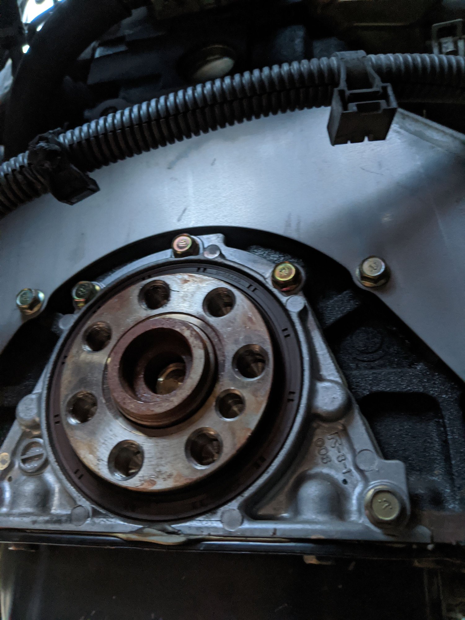

Hi, I am doing an Evolution 7.5 GT-A Semi/Auto to 5 speed manual conversion. I have pretty much everything out and ready to install the new parts except for this part in the middle of where the flywheel bolts to. It's where a pilot bearing would go.
Here is a picture. I can get another pilot bearing puller but I am hesitant it actually needs to come out or maybe I am missing a step to get it off like unbolting the plate that holds on the rear main seal?

Most Evo guys haven't done this, because most of us don't have an Automatic Transmission and never had to remove a Pilot Bushing.
But by taking a look at the DSM guys, this might help: https://www.dsmtuners.com/threads/re...g-easy.467797/

Thank you. I was thinking about doing that but I was not sure on what exactly people meant and I knew if I missed one step I'd be screwed. Do you think Lucas oil multipurpose grease would work?
There was another puller that used hydraulic pressure, you screwed it in and then just injected grease until it popped off.
I am going to try the socket method and if that doesn't work then I don't know...

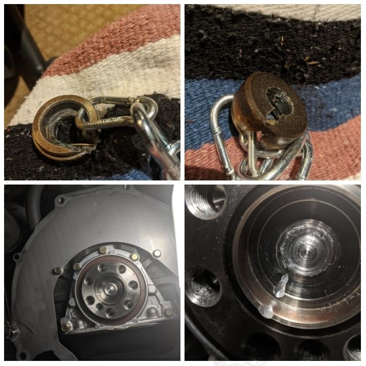

Here is a list of what did NOT work in order I tried them in:
OEM Tools Pilot Bearing Puller (broke)
Grease and electrical taped socket for a tight fit on the larger diameter part.: Banged until my extension was getting dents (Would not advise to push it this far) also tried on only inner diameter using backwards 3/8th extension
Wet paper towel ripped up super finely on inner diameter. (Actually did start going in behind but stopped) I tried it with grease included.
I then tapped it with an 18mm 1.5 pitch threading tool. It hit the back and started to make it bulge forward Abit but then just stripped.
I tried a bolt the same size that threaded in nicely. It started to make the crank turn but then it just stripped. I also tried Grease behind it to act as a hydraulic but it squished out even with the fine threads.
I then cut it using my high powered electric wired drill using a rounded cone shaped bit that took about half an inch out and took me about an hour but I was being rushed by someone and not thinking clearly and accidentally went to far. There is zero sign that you cut through the bushing other than the bushing is much, much harder than the crankshaft, it only took a skim to grind into the crank but the actual steel bushing took around a minute just to begin cutting!
I used no heat at any time because I plan to take it all apart in a few months and redo seals and probably get my clutch pads repadded. I also have no money so I couldn't damage the rear main seal that looks healthy.
I would advise that if you're doing any Transmission out job and want to spend a few extra dollars on o-rings, seals and so on that to get the Throw Out Bearing (TOB), Rear Main Seal and oil pan gasket because you should do it properly by removing the retaining plate and dropping the oil pan and cleaning that out while you're at it. (You need a paper gasket and I believe a little ring retainer and MUST do it the proper way if you have a 6 bolt engine). From there then I'd go input shaft seal, transfer case seal and anything else but those first ones are the biggies.
As of this second the bushing is still stuck even though half an inch or so is cut out of it!
So the final method I am going to do which might of worked to begin with but I didn't want to take any chances so I just cut the bushing, is, I am going to drill two tiny holes and work my way up until I can fit two very small 300lb rated hooks I bought will slip through. Then I will attach it to a chain and try whipping it first and since that probably won't work I'll attach the chain to my engine support beam that will be laying on the ground by the side of the front wheel and it will rest against my disk brake rotor as I spin the handle tightening the chain and pulling the bushing. This way there is no risk of the vehicle coming off the jack stands and I have seen this technique used before with a hand winch / ratcheting tie downs but it can be very dangerous just like using a torch that close to your face. Wish me luck.

Well the Engine support bar method was just a tad to big but while I had it attached to a chain (a light one) I decided to do what my friend suggested and just whip it. I didn't even whip it that hard and it shot out faster than I could see!
My friend suggested that I actually just grind a hook into some threaded, "ready rod" and **** it in the middle so that's another faster way to do get it out or just thread it and attach a slide hammer.
The back looks interesting but I saw no real signs of glue or sealant. It broke the first tiny for metal drill bit I used and got the others smoking hot, I did it in two stages. I don't know why they had to make it out of such tough steel when brass and less hard metals work for other cars with more power.
