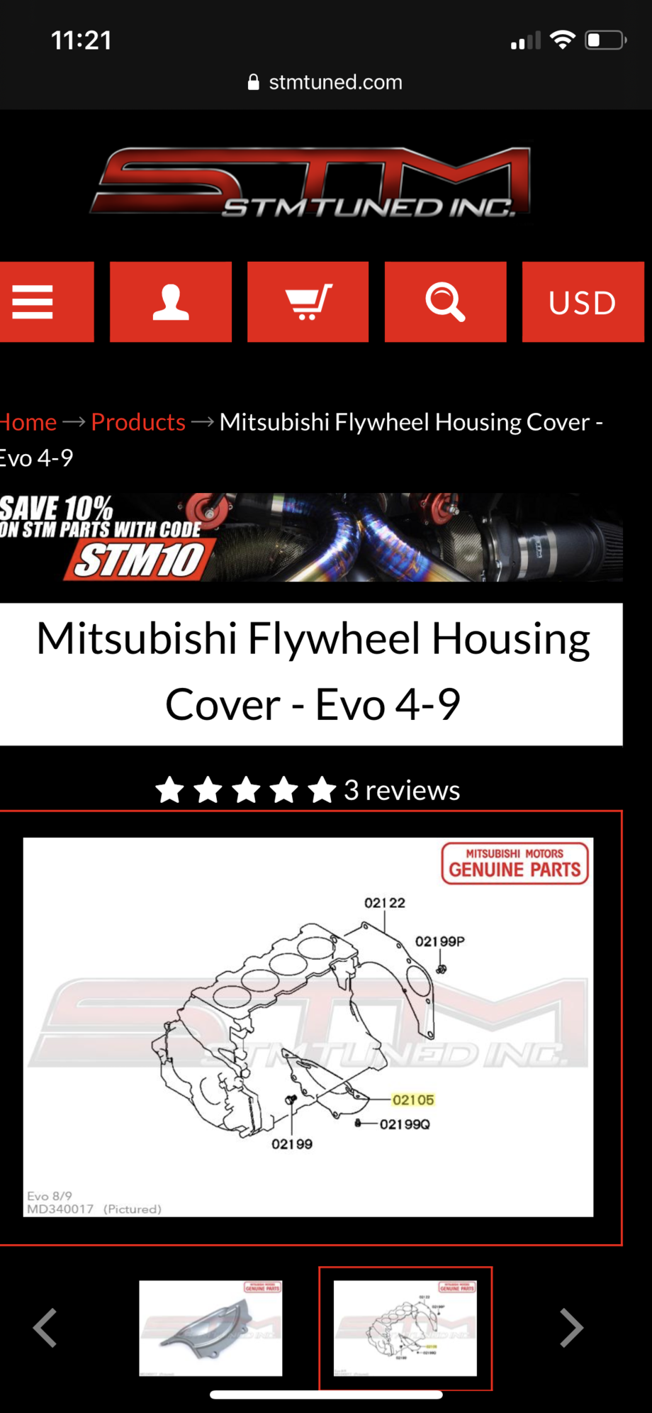

Hey guys id appreciate a link to where in can find these bolts. Its the part of the flywheel cover that mounts to engine.
From the picture its bolts 02199 and 02199Q

They're just M6x1.0 and like 8-10mm long

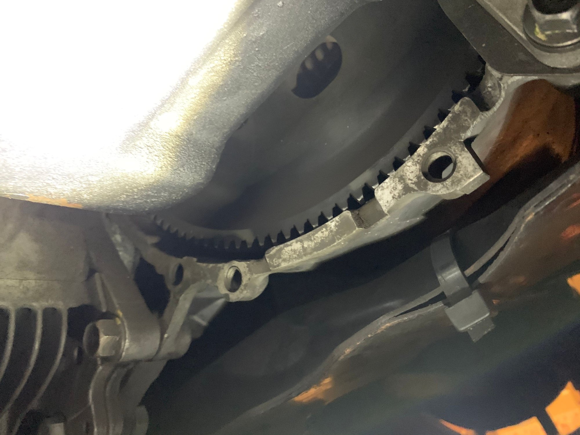

i grabbed some of those M6x1.0 at ace and they were too small.
t
those 3 bottom bolts

The one you screen shotted in STM's site that goes into the block is M6. Those ones that go in the bellhousing are M10x1.25. 10-12mm long will work fine there.
ahh okay, gotcha. Thanks again 🤙🏽
