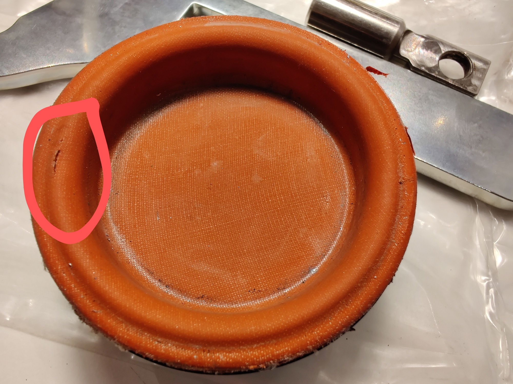

I'm still convinced it's something to do with the WGA. I've removed the 3 PSI spring so now it's rated at 17 PSI. And guess what.. it's still boosting to 1.8 bar (26 PSI).
When I opened up the WGA to remove the spring, I noticed a small tear in the diaphragm. Would this be enough to cause a loss in pressure to move the WGA arm correctly?

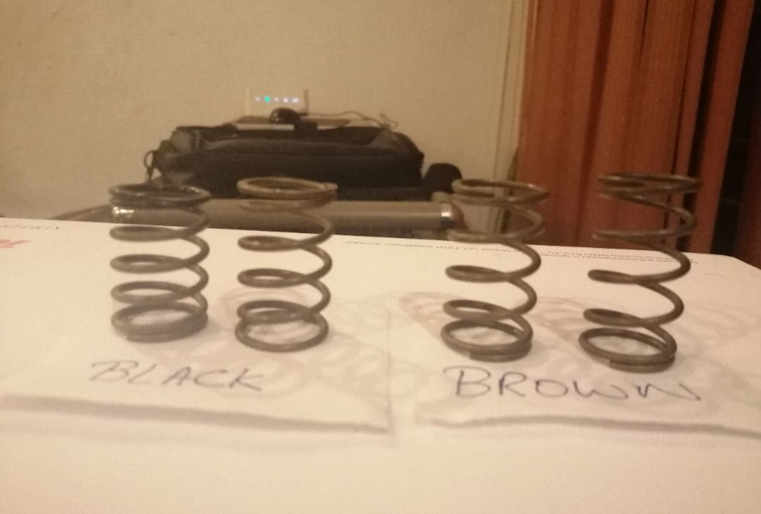

The valve started to just get stick cauing either causing unstable boost or over boost
As u can see same colour spring different size :
when we tested it upon inspection we saw the valve stem had excessive markings on it showing the valve stem was either faulty or not correct balanced. And both of my waste gates springs were different size springs altho same colour .... turbo smart I'd say not very smart lol
At this point I gave up when I mailed turbo smart either refund or change and to my sadness all they did was suck their own d**k and told me how great of a company the were and I'm wrong and they cant make mistakes...I just gave up and went with tail wastegates.

Most probably that tear on the diaphragm causes the creep coz the pressure that's supposed to 100% push up the spring to release boost now leaks a bit thru the diaphragm, hence the spring movement is not maximized anymore.
That's very interesting..how the spring sizes are different with supposedly identical spring rates. Although I have nothing to compare mine with, I hope the spring rates are true as advertised. When it was on the 14 PSI spring combo before, the wastegate flap opened dead at 0.95 Bar.
