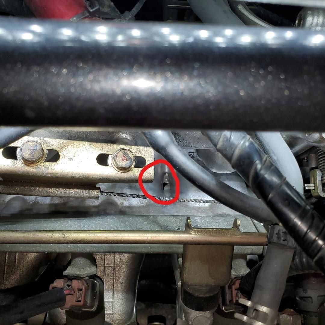

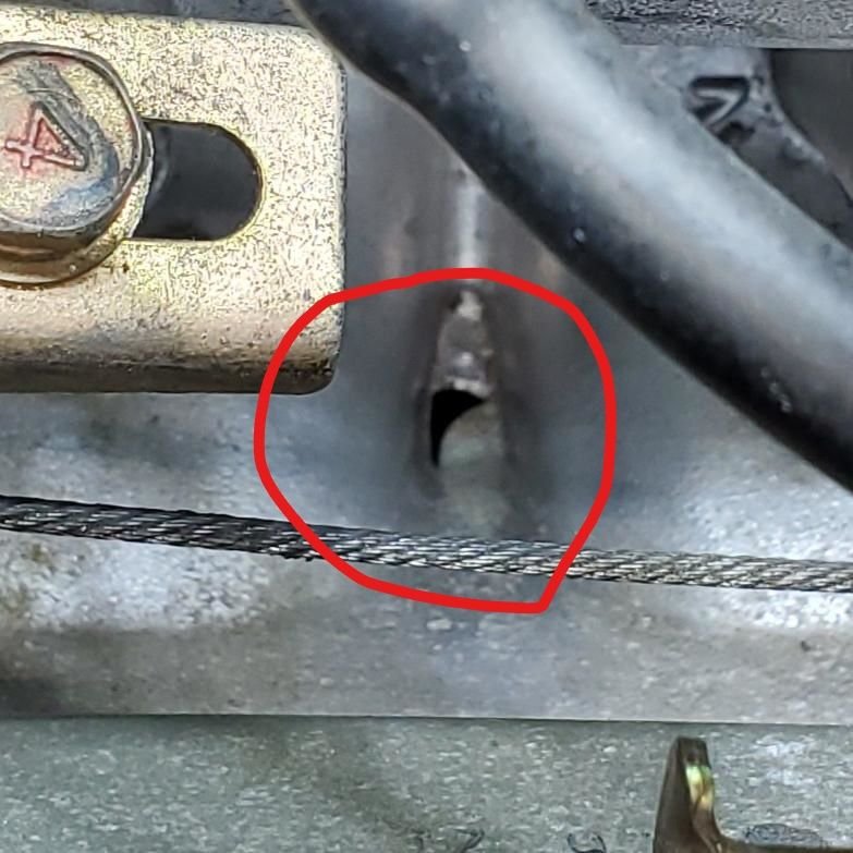

Anyone had this happen with their factory Evo IX intake manifold? Just found this today. What would cause this? Wanted to see if this is common or just my bad luck.

That looks to just be some sort of casting flash in between the runners and isnt actually a hole inside the intake manifold.

I was wondering if it was or not, because I sprayed some soap/water mix around doing a boost leak test and didn't get any bubbles but I'm getting a clear steady slow hissing sound right in that area. Checked all the lines and no bubbles so far. Search continues.

that manifold is fine... just cast flashing.
