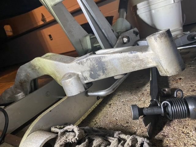

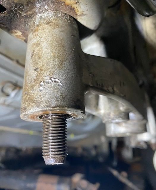

Any tips on getting this thing loose? The stud on the diff bar is seized to the aluminum bar. I’ve tried the air hammer, heating up the bar, prying on it. The passenger side came off easy and it’s just the driver side that is the issue.

im surprised a big pry bar wont pry it off.

You and me both! 😂 Hopefully I can get it out or I'll have to work around it. I've been working on it for days now.

Not sure the stud is removable. The head of the stud sits loose in the frame and the stud has some play in it. I think its boxed in the frame and that's what keeps the stud from spinning.

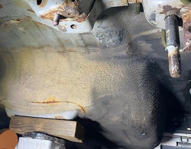

The hole on the passenger side is ovaled out so it doesnt seize unlike the driverside. This also fought me on my car but it wasn't too bad. Get your torch and carefully torch the driverside on the subframe, not the stud. Keep in mind fuel filler neck is right there so use common sense around that. Torch around for a bit then get a prybar up in there and pry downward and itll come off. Without heat it aint moving.

Ok thanks for the tips. I will give these a try tomorrow. My gas tank and filler neck are not installed right now so no worry there. Lol

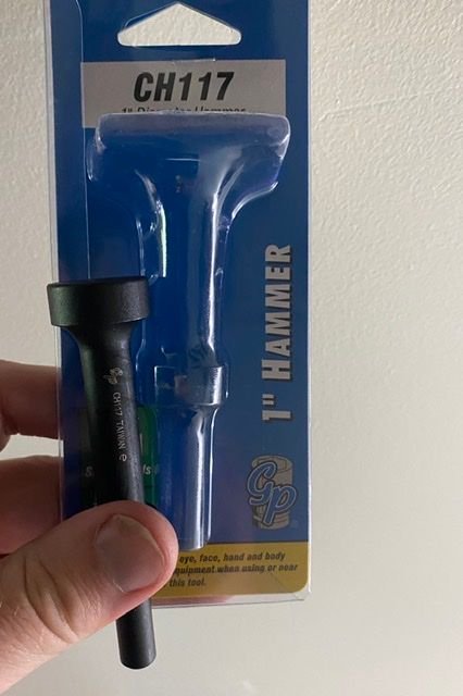

Finally got in the proper air hammer attachment I needed (they were all out at all the local stores). An air hammer with this attachment zipped it right off.
Grey Pneumatic (CH117 1" Diameter...
